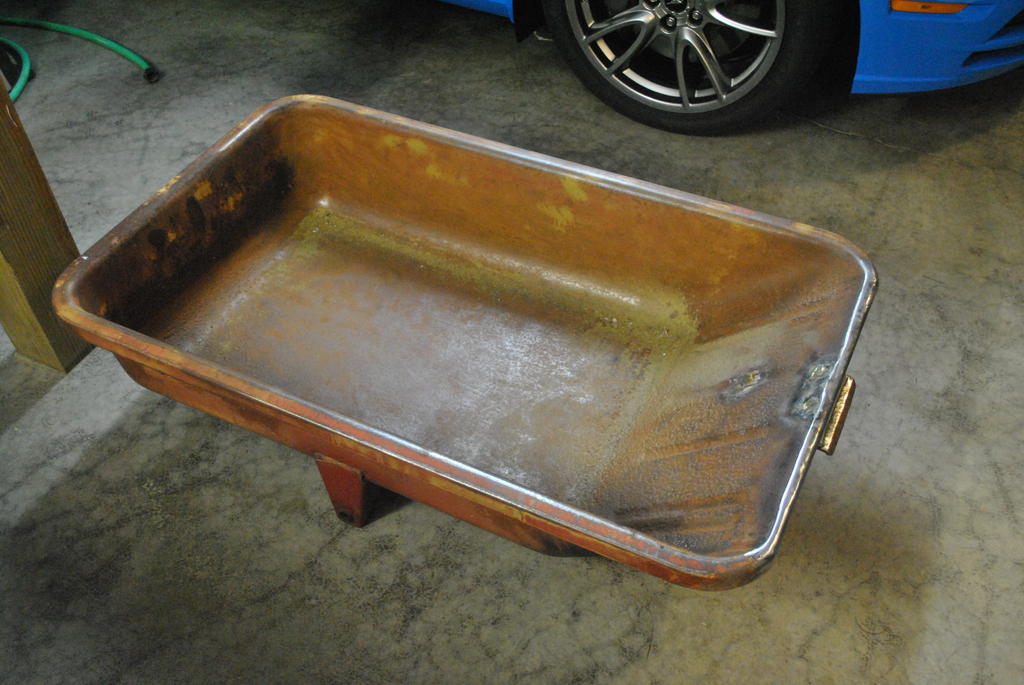

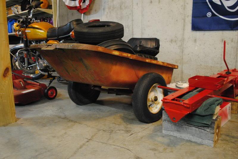

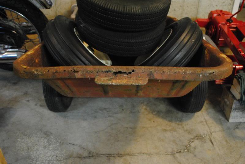

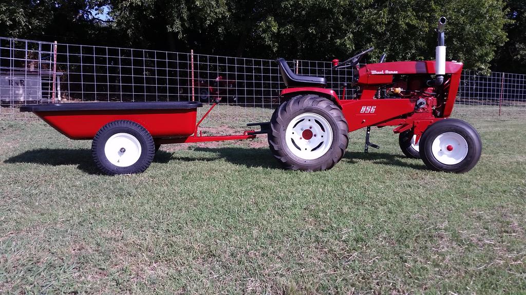

Horse Play 393 #1 Posted October 15, 2017 I just became the owner of a WH dump cart... for the second time. I bought it five years ago for $40 and it sat around the garage for two years, then I gave it to my friend when he bought my last tractor. He wasn't going to get around to restoring it, so he gave it back to me this week to go with my new 857. Friday I dropped off the tub at my local welding shop to fix the rotted rear lip. Anything Wheel Horse is hard to come by here in Kentucky and this has been the only cart I've come across over the years. I need some help with wheels and tires for this project. What where the original style of tires on these carts, the ribbed wheel barrel style? My wheels are very rusted; one especially around the tube stem hole. Is there a wheel barrel tire/wheel combo out there with the same hub offset? Here's some old pics back from when I first purchased the cart... 3 Share this post Link to post Share on other sites

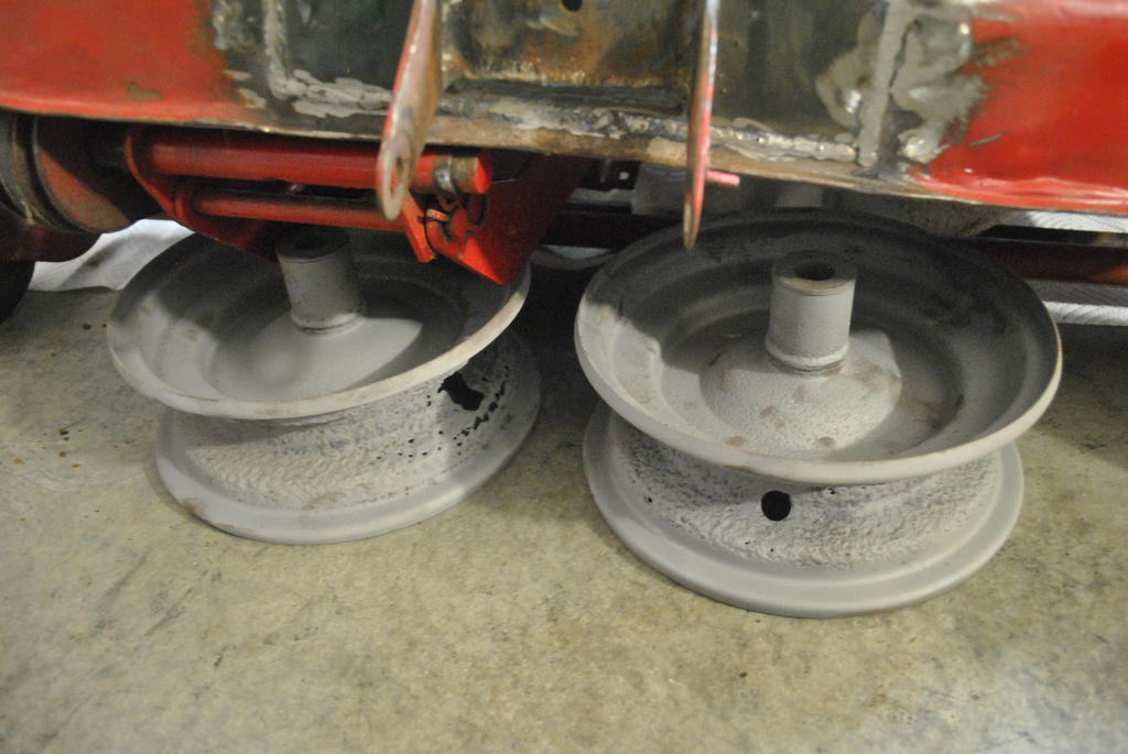

Horse Play 393 #7 Posted October 30, 2017 Looks like the wheels are scrap anyways... I had the frame blasted and then I managed to get some priming and painting done. 2 Share this post Link to post Share on other sites

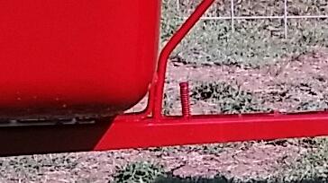

Horse Play 393 #9 Posted November 4, 2017 Thanks for the link, you're project thread is a good reference. I tore the cart apart five years ago and can't remember something; does the spring/bolt/nut for the dump lever go on top or underneath the cart frame? Share this post Link to post Share on other sites
rjg854 13,313 #10 Posted November 5, 2017 Underneath Share this post Link to post Share on other sites
Texas Todd 1,026 #11 Posted November 5, 2017 (edited) Mine was on top. Doest mean its right.... Edited November 5, 2017 by Texas Todd 1 Share this post Link to post Share on other sites
gwest_ca-(File Mod) 12,457 #12 Posted November 5, 2017 Looks like everything is below the tongue except the 2-1/2" bolt. Garry 1 Share this post Link to post Share on other sites
Texas Todd 1,026 #13 Posted November 5, 2017 Yes, I guess I focused in on the bolt and spring part. The mechanism is below. If you need a pic underneath, let me know and I will snap one. Share this post Link to post Share on other sites

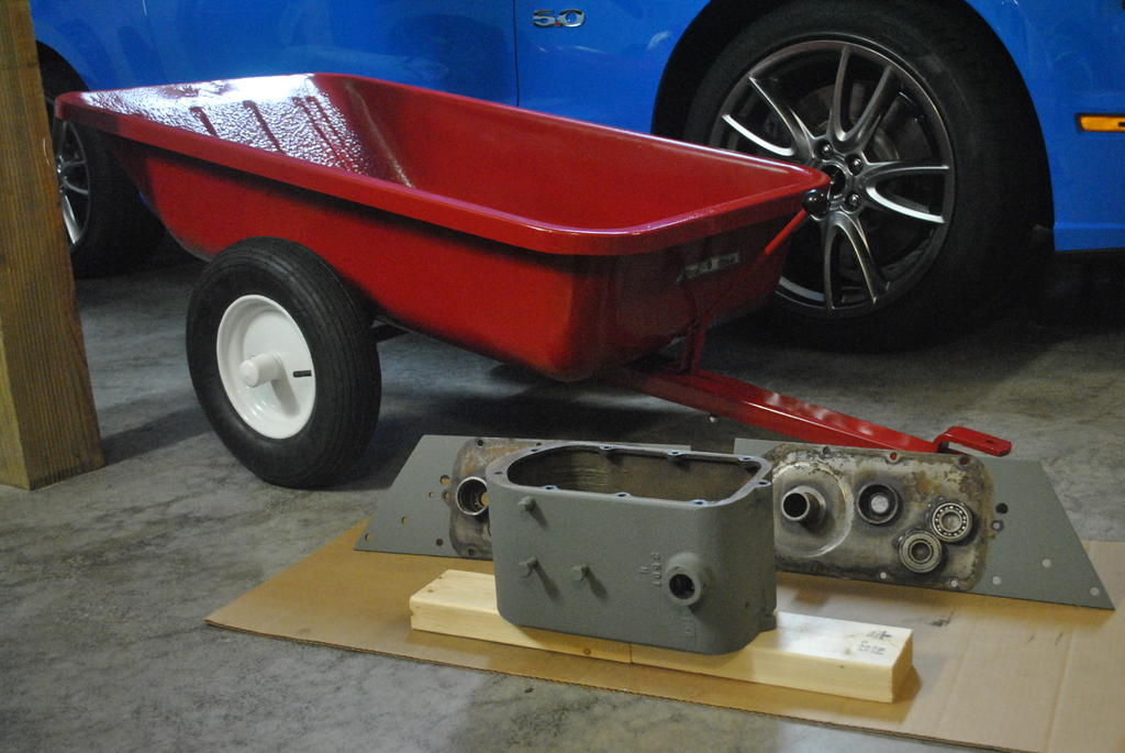

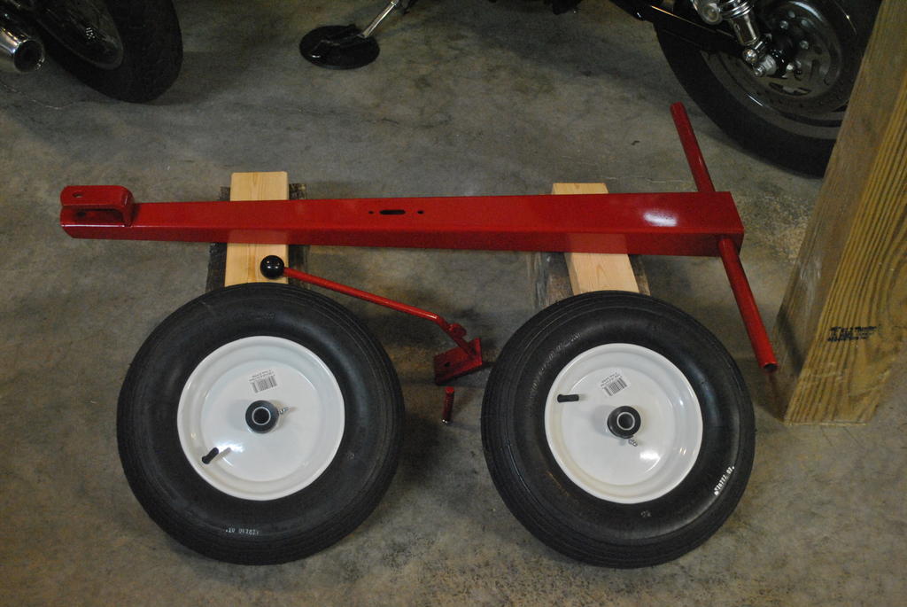

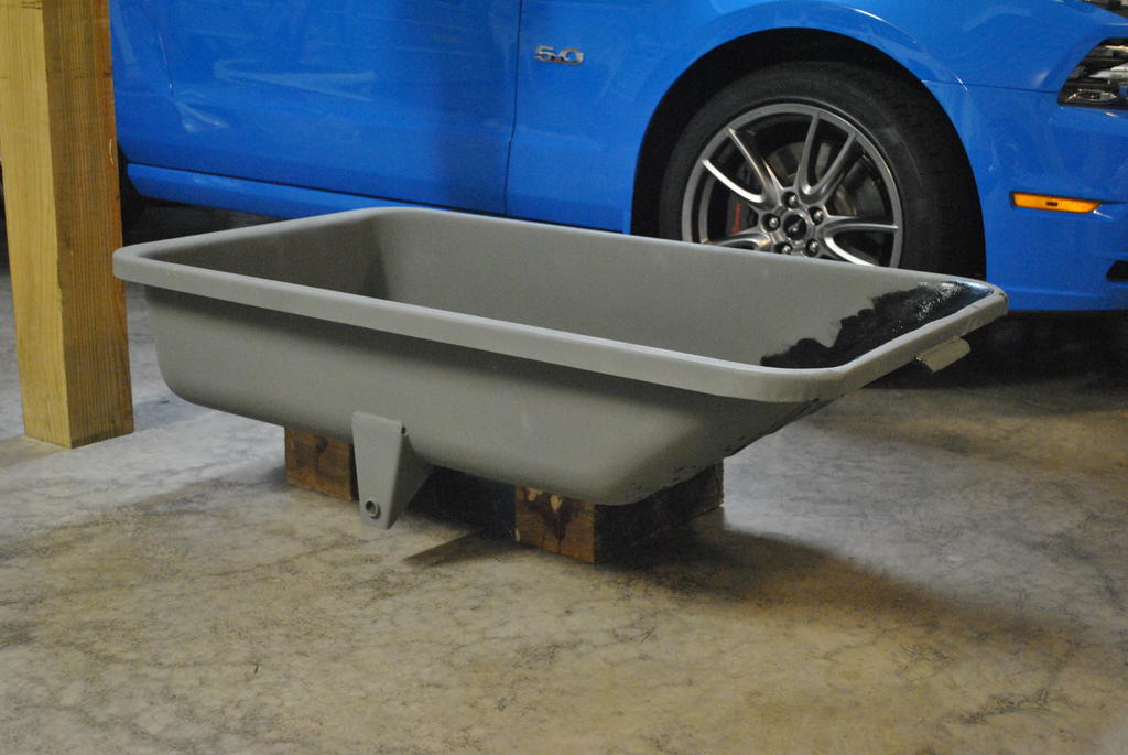

Horse Play 393 #14 Posted November 23, 2017 I haven't much spare time, but here is where I am currently. I have the tub back from the weld shop with the new rear lip patched it. I also picked up new wheels/tires and a lever knob. 5 Share this post Link to post Share on other sites

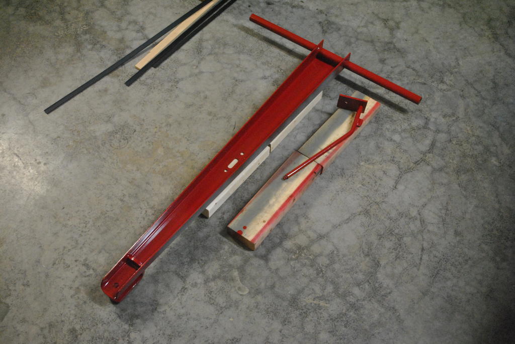

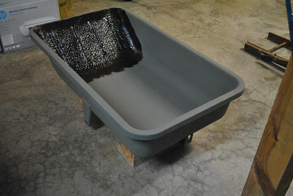

Horse Play 393 #15 Posted April 24, 2018 I had the tub sandblasted, sprayed primer, and then I coated the back in POR15. 1 Share this post Link to post Share on other sites

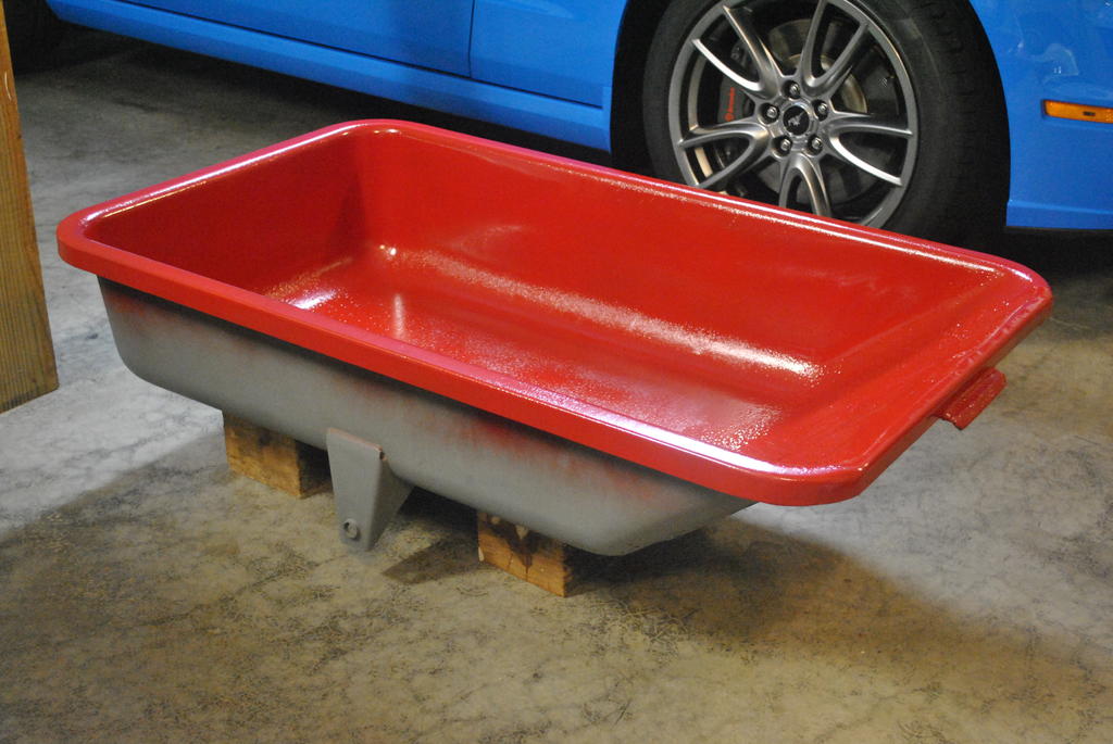

Horse Play 393 #16 Posted April 24, 2018 I did a good scuff on the primer with a Scotchbright pad, cleaned, and painted the inside. I may do a coat of bedliner inside to hide some of the rust pitting. 5 1 Share this post Link to post Share on other sites

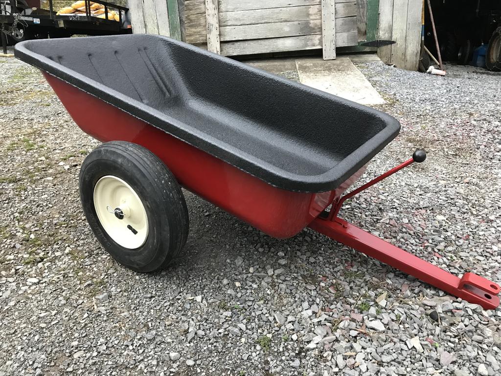

Horse Play 393 #18 Posted May 28, 2018 Just about finished! 8 1 Share this post Link to post Share on other sites
