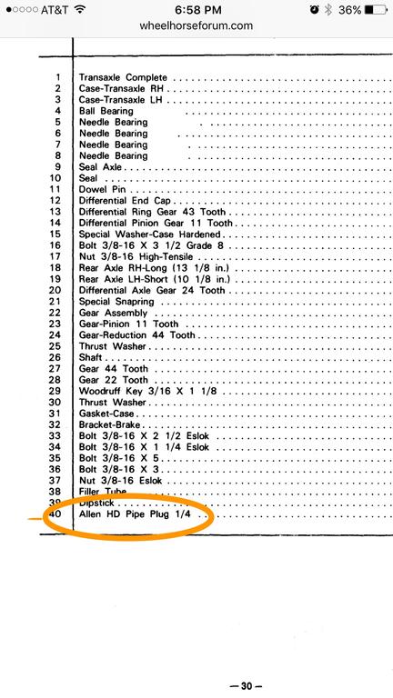

Aldon 4,832 #1 Posted October 12, 2017 (edited) Well it's as title indicates. I acquired this one a while while back and got it all spiffied up and oil changed and when I got to hydro I can get the dang plug out. So I'm dragging it to Stevebo's and hopefully with a ton of foremen we will get it out and fluid changed. but I know the plug will need replaced. Can anyone tell me what npt size this plug is? So I can grab one to install when and if we are successful. Edited October 12, 2017 by Aldon Share this post Link to post Share on other sites
19richie66 17,818 #2 Posted October 12, 2017 (edited) Straight from the parts list Edited October 12, 2017 by 19richie66 3 1 Share this post Link to post Share on other sites

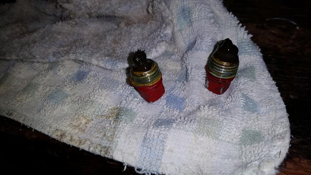

shallowwatersailor 3,220 #3 Posted October 12, 2017 I am a firm believer in magnetic drain plugs for engines and gear sumps. I have these on my tractors, #IP-02. These are a direct replacement for the OEM plug. 6 1 Share this post Link to post Share on other sites

WHX?? 55,193 #9 Posted October 13, 2017 Call me cheap but I'm with Garry on making my own. Got a pile of magnets off ebay cheap... They are square head tho. I JB welded them in but doubt if I had to. From my 5060 woes thread... 1 Share this post Link to post Share on other sites

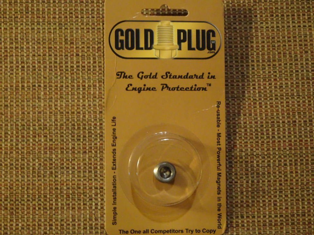

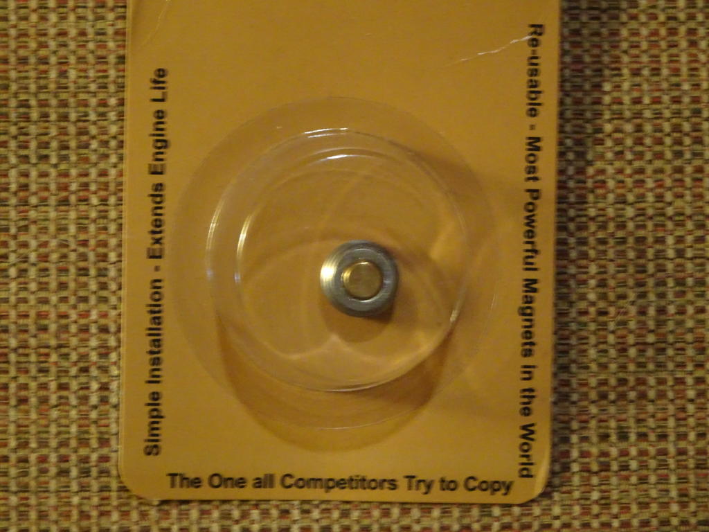

608KEB 812 #10 Posted October 14, 2017 On 10/12/2017 at 6:35 PM, shallowwatersailor said: I am a firm believer in magnetic drain plugs for engines and gear sumps. I have these on my tractors, #IP-02. These are a direct replacement for the OEM plug. Share this post Link to post Share on other sites
