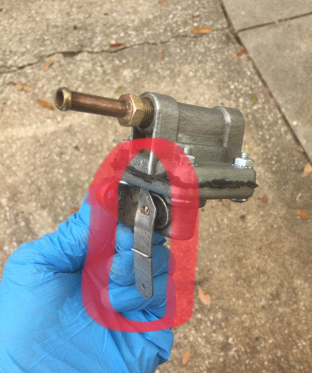

UncleJerm76 103 #65 Posted October 27, 2017 (edited) Well that’s was short lived. Was going to give the old gal her first duty, move the old car to the other side of the yard. Started right up without any choke as it usually does, I ride it around to the car, hooked up the chain then it just died - out of gas! Filled her up then used the handy primer arm on my fuel pump that I learned about. But it wouldn’t start without the choke this time. Then it ran for about 10 seconds and died. I restarted several times - again, each time dieing after 10 seconds - even with the choke on! Carb seemed to be starving for fuel. Pulled the hood and gas was everywhere. I thought my gasket had already given up but it was clean and looked great. Pulled the fuel pump and it appears to now be leaking gas?/oil? Around the pivot that the long arm rides on. Possibly have a ruptured diaphragm as gas isn’t supposed to be on that part. Not too sure that part is even repairable? I really wanted to keep this fuel pump original but it’s fighting me tooth and nail. What do y’all think about replacing it with one of the newer vacuum pumps? I could make a plate to seal off the old fuel pump hole pretty easy, and they go for only about $6 where I live. They also wouldn’t leak fuel into the motor oil if the diaphragm ever ripped. Lots of pluses. Any other ideas to keep my original pump going? Edited October 27, 2017 by UncleJerm76 Share this post Link to post Share on other sites
Sarge 3,473 #66 Posted October 27, 2017 There are rebuild kits available now and if that thing did rupture the diaphragm you'd better dump the engine oil . http://www.then-now-auto.com/product-category/fuel-pump-kits/kohler-fuel-pump-kits/ Sarge 1 Share this post Link to post Share on other sites
UncleJerm76 103 #67 Posted October 27, 2017 (edited) 1 hour ago, Sarge said: There are rebuild kits available now and if that thing did rupture the diaphragm you'd better dump the engine oil . http://www.then-now-auto.com/product-category/fuel-pump-kits/kohler-fuel-pump-kits/ Sarge Thanks Sarge, can’t wait to get home and take my pump apart so I know which kit to order, you saved the day! Hard to tell if it’s gas from the diaphragm or oil splashed from the crankcase, but just to be safe I’ll dump the oil. Edited October 27, 2017 by UncleJerm76 Share this post Link to post Share on other sites

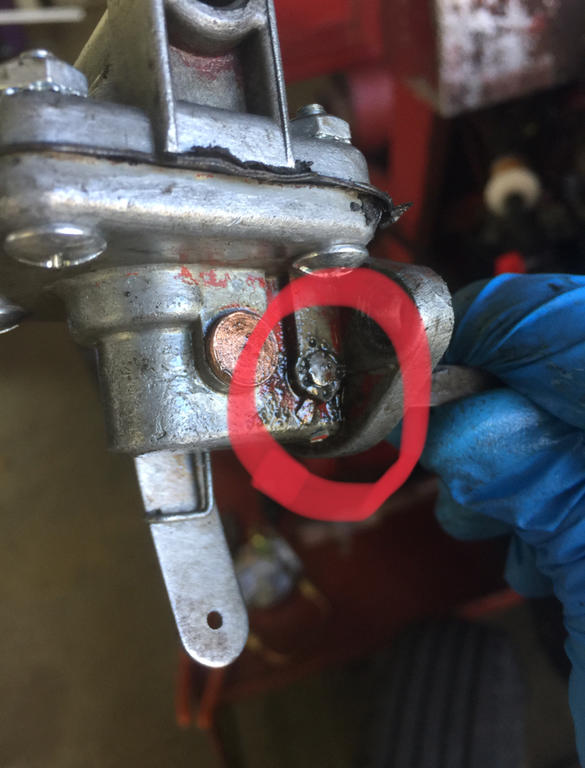

gwest_ca-(File Mod) 12,391 #68 Posted October 27, 2017 Looks like the casting around that pin has been peened with a center punch to tighten up the pin to casting fit. Garry Share this post Link to post Share on other sites
UncleJerm76 103 #69 Posted October 27, 2017 Yes from PO, and when that didn’t work he smothered it with jbweld. The jbweld started peeling off so I flaked rest of it off. That “peened pin” on mine is loose and rotates with the arm, but I don’t know if it is supposed too? Doesn’t look like rebuild kits address that part and If I knew it didn’t need to move I’d just MiG a small bead of weld over it and seal it up. ...If someone has one of these pumps already off there machine and can verify if that pin moves for me that would be great! Share this post Link to post Share on other sites

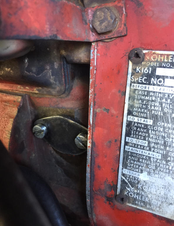

UncleJerm76 103 #70 Posted October 29, 2017 I have some work to do with the Misfit so I made a blank plate from some 1/8” laying around and capped off where the fuel pump went and just ran the gas line directly to the carb from the tank. Works great where I live, but this is temporary until I decide what to do about a fuel pump. My tank sits higher than the carb so this should work unless I get really low on fuel. ...I have zero hills on my property (Florida) so that’s not an issue. Share this post Link to post Share on other sites

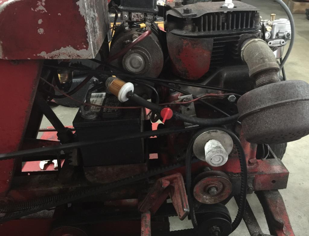

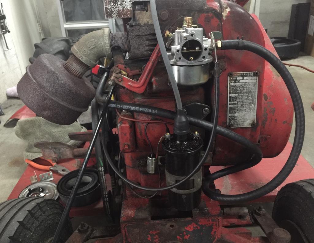

UncleJerm76 103 #71 Posted November 1, 2017 (edited) I'm trying to "properly" route new throttle and choke cables since the last ones were severely damaged by touching the muffler pipe. So I really want it to be right this time and not touch the muffler or drive pulley. Do any of you fine gents mind taking a close up photo of the side and front of your 701's engine so I can see how its supposed to be done? I'd imagine I am also missing a throttle/choke cable clamp to keep these cables from flopping around? ...although I couldn't find anything in the part diagrams. Pardon the long fuel line, the new fuel pump will be here next week but needed to do some work before it got here Here is what I am working with at the moment: Edited November 1, 2017 by UncleJerm76 Share this post Link to post Share on other sites

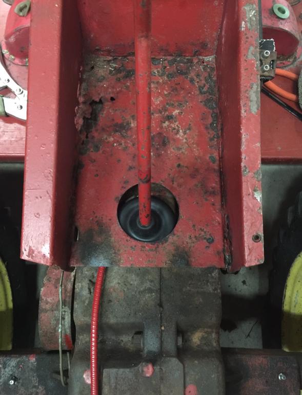

UncleJerm76 103 #72 Posted November 2, 2017 (edited) I moved on to replacing the boot and lift cable (thanks to @wheelhorseman for a great cable!). Now I’m wondering if I have the wrong transaxle or wrong hood stand assembly because the shift boot doesn’t line up with the hole at all and the lift cable does not have a straight shot and is rubbing heavily on the boot. How can I determine either of those are incorrect for a 701. Does the trans have an id anywhere on it? Edited November 2, 2017 by UncleJerm76 Share this post Link to post Share on other sites

UncleJerm76 103 #74 Posted November 3, 2017 14 minutes ago, Zeek said: I wanted to keep the original pump. Are you in a position to verify for me if that pin on yours moves with the arm or not? Share this post Link to post Share on other sites
Zeek 2,299 #75 Posted November 5, 2017 On 11/3/2017 at 4:42 PM, UncleJerm76 said: Are you in a position to verify for me if that pin on yours moves with the arm or not? Mine does not have the primer lever. 1 Share this post Link to post Share on other sites
