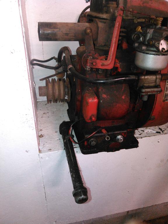

UncleJerm76 103 #26 Posted October 16, 2017 How about the oil drain? Do you guys just pipe it around the pulleys, or just let it run out where it may and clean up afterwards? Share this post Link to post Share on other sites

UncleJerm76 103 #31 Posted October 17, 2017 (edited) Here’s what I’m referring to, the drain plug is running right behind the pulleys, it would drain all over them and get between the bracket and the frame. No room for funnies in there Edited October 17, 2017 by UncleJerm76 1 Share this post Link to post Share on other sites
Mikey the Monkey 701 #32 Posted October 17, 2017 Mine has a pipe to divert oil away 1 1 1 Share this post Link to post Share on other sites
UncleJerm76 103 #33 Posted October 17, 2017 (edited) 5 hours ago, Mikey the Monkey said: Mine has a pipe to divert oil away Thanks Mikey! This confirms the route I’m going to need to go. I wanted to use one of Kirk Engines magnetic drain plugs, but that’s not really an option with the pipe. Ive had excellent results with magnetic drain plugs in my other engines. Edited October 17, 2017 by UncleJerm76 avoiding grammar police 2 Share this post Link to post Share on other sites

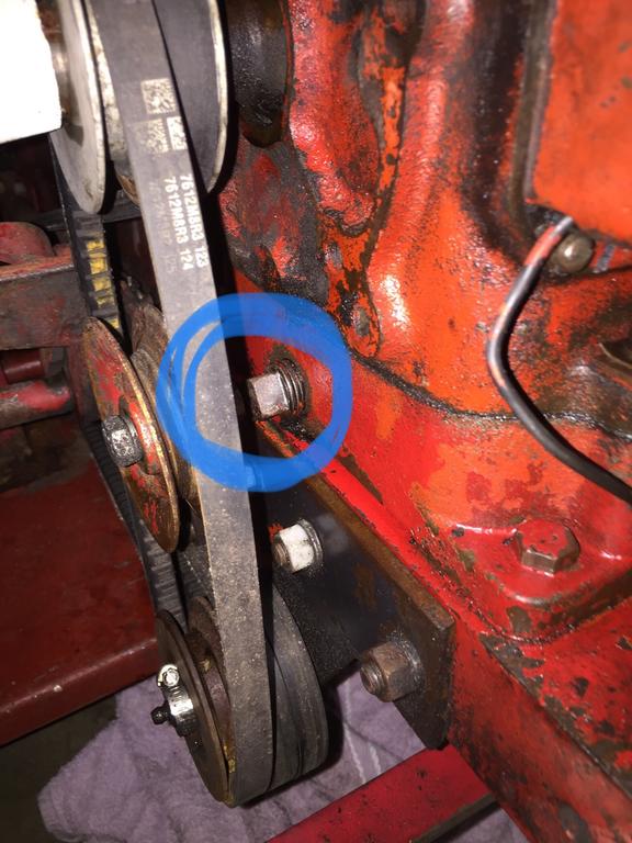

gwest_ca-(File Mod) 12,511 #35 Posted October 17, 2017 8 hours ago, UncleJerm76 said: Here’s what I’m referring to, the drain plug is running right behind the pulleys, it would drain all over them and get between the bracket and the frame. No room for funnies in there Notice your drive belts have raw rubber sides which seldom quit driving when the tension is released. All our belts are fabric covered to help them slip in a no-tension situation except for the starter/generator belts that use raw rubber for better traction. The other exception is a belt that bends backwards over a flat idler pulley requires special construction to get a reasonable life expectancy. Garry 2 3 1 Share this post Link to post Share on other sites
UncleJerm76 103 #36 Posted October 17, 2017 1 hour ago, gwest_ca said: Notice your drive belts have raw rubber sides which seldom quit driving when the tension is released. All our belts are fabric covered to help them slip in a no-tension situation except for the starter/generator belts that use raw rubber for better traction. The other exception is a belt that bends backwards over a flat idler pulley requires special construction to get a reasonable life expectancy. Garry Good eye! I did not know there was a difference other than breaking strength, I will pay attention to this and if it becomes a problem now I know who to come to for the correct belt. Share this post Link to post Share on other sites
953 nut 69,841 #37 Posted October 17, 2017 11 hours ago, UncleJerm76 said: drain plug is running right behind the pulleys, it would drain all over them and get between the bracket and the frame. I see your situation, guess the best thing to do is remove the belt and cover everything with plastic bags while draining then go with the drain pipe. 2 hours ago, gwest_ca said: No room for funnies in there Don't guess I will ever live that down. 3 Share this post Link to post Share on other sites

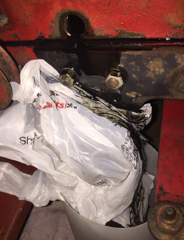

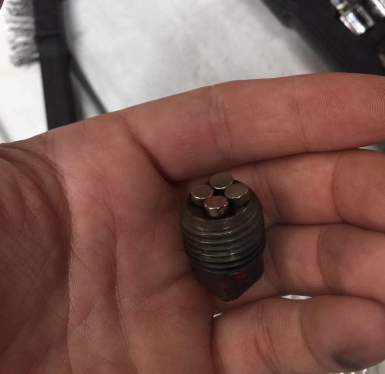

UncleJerm76 103 #41 Posted October 18, 2017 (edited) On 10/17/2017 at 9:13 AM, 953 nut said: I see your situation, guess the best thing to do is remove the belt and cover everything with plastic bags while draining then go with the drain pipe. I finally jumped into changing the oil with plain 30W. I took your advice and removed the small primary deck belt first followed by covering the rest with a plastic bag. I cut the top off a empty windshield wiper fluid jug and stuffed what was left of the bag hanging into it so that is where the oil would be directed. It worked great other than that darn pulley bracket bolted to the frame. It got all behind it as I assumed it would and will probably be dripping oil for days to come ...oh well, I'm sure it isn't the first time it has happened to this old gal I was not very happy with the condition and thickness of the oil coming out so I took the time to clean out the inside of the motor with carb cleaner from both the pour hole and the drain hole - sludge poured out and I kept going till it was clean. Three cans later and its now squeaky clean in there. then I just waited for everything inside to dry. Next I decided that I would put off the "drain pipe" idea so that I could add four Neodymium Magnets to my drain plug and test whether or not it would would catch any metal floating around. In every case I used magnets - even pressurized systems with filters, it has always snagged metal bits - blows me away how much is actually floating around inside engines! If during my next oil change I discover metal, then I will abandon the pipe drain idea and stick to doing it this way in order to continue catching the metal bits on the magnet. As an experiment I also wanted a couple magnets at the end of my dipstick. The idea is if I discover it caught metal then I can have my cake and eat it too — proceeding with the pipe drain and let the dipstick catch the metal bits. I cleaned the dipstick real good then decked the end of it perfectly flat. Next I mixed up a small batch of JBWelb on one of the carb cleaner caps and epoxy'd two Neodymium Magnets together and also to the end of the dipstick (I didn't want to take a chance on them getting stuck to something else inside when the dipstick was being inserted or removed). Neodymium Magnets are supposed to be among the strongest magnets on earth and these tiny buggers really are quite powerful, id imagine I would have to tear the motor apart if they came off the dipstick, so JB Weld was a necessity. The last thing I did was pull the spark plug wire and spin the motor over several times giving the starter/generator time to cool between spins to try and splash as much oil around to lube everything up again before I fired it up. Ill followup after my next oil change with results of the magnets. Edited October 18, 2017 by UncleJerm76 Add pics 1 3 Share this post Link to post Share on other sites

ebinmaine 80,979 #45 Posted October 18, 2017 2 hours ago, UncleJerm76 said: Neodymium Magnets Awesome idea.... Please keep us posted !! Share this post Link to post Share on other sites
WHX?? 58,307 #46 Posted October 18, 2017 Late to the party here but Sounds like the guys got you off to a good start other than Dick's typos and Dan giving bum dope on plugs A 701 is on my bucket list and if I ever get into Mr Harrison's @hcminis herd of 701's it's gonna be like a fox in the hen house! Don't worry about bugging us about questions most guys here live for questions! I also try to incorporate a magnet in my drain plugs since these gals don't have a filter. may not help but sure can't hurt. I have the drain plug on most of my Kohlers piped strait down in my eternal quest for an oil change without a mess. I don't run decks on any of my round hoods tho 1 4 Share this post Link to post Share on other sites
