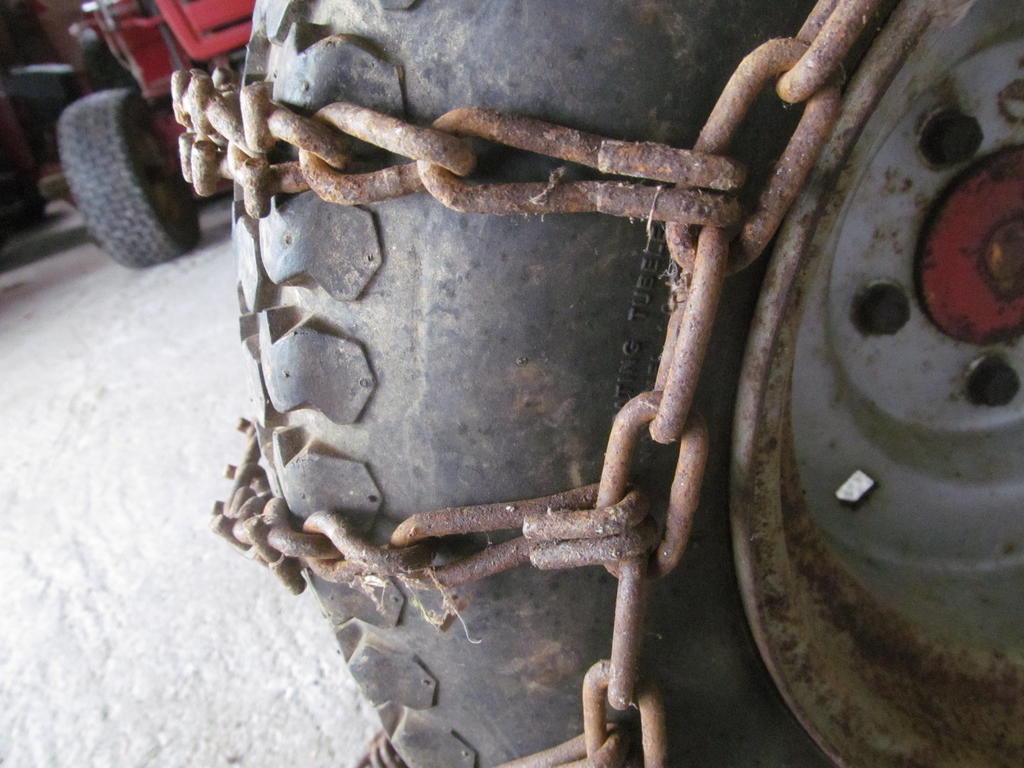

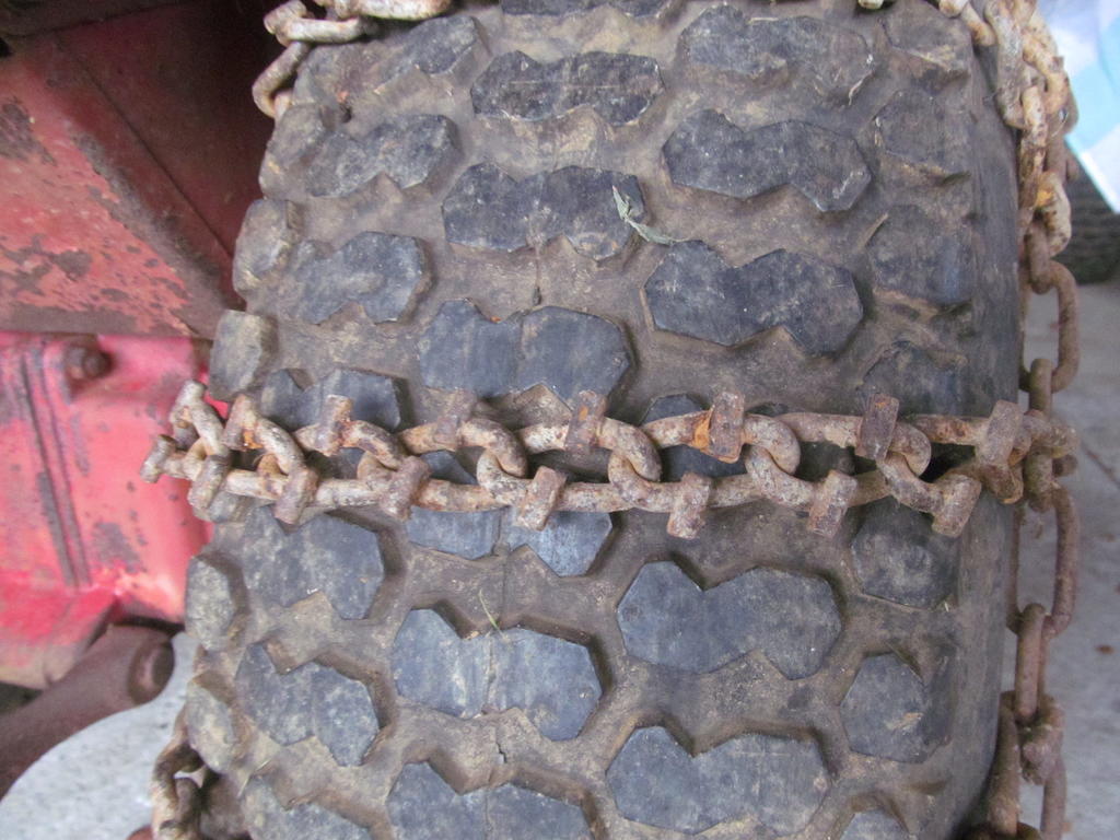

Ed Kennell 47,819 #2 Posted October 8, 2017 This is a set of 2 link bar chains on my 875. There are 8 bar links that just span the width of the 8.50X23X12 tire and 2 non bar links are on the side along with the U link to the side chain. There are 10 total links in this chain. You may be able to go with 8 total links, but you need the U link to be totally on the sidewall. If you use an odd number of links, the one U link to the side chain must be installed up side down so there is no twist in the cross chain. 3 Share this post Link to post Share on other sites

Ed Kennell 47,819 #7 Posted October 9, 2017 I'm not sure what surface you plan to use the chains on, but a straight chain (block and tackle) will provide a much more aggressive pattern than a twisted chain that is normally used for cross chains. With the twisted chain, all links lay flatter to the tire and provide a smoother ride and wear better on a hard surface. If the chain is only used on sod or dirt, wear and ride is probably not an issue. How do you plan to attach the cross chains to the side chains, Cut and reweld links or make bolting straps like on the rubber chains? 1 Share this post Link to post Share on other sites

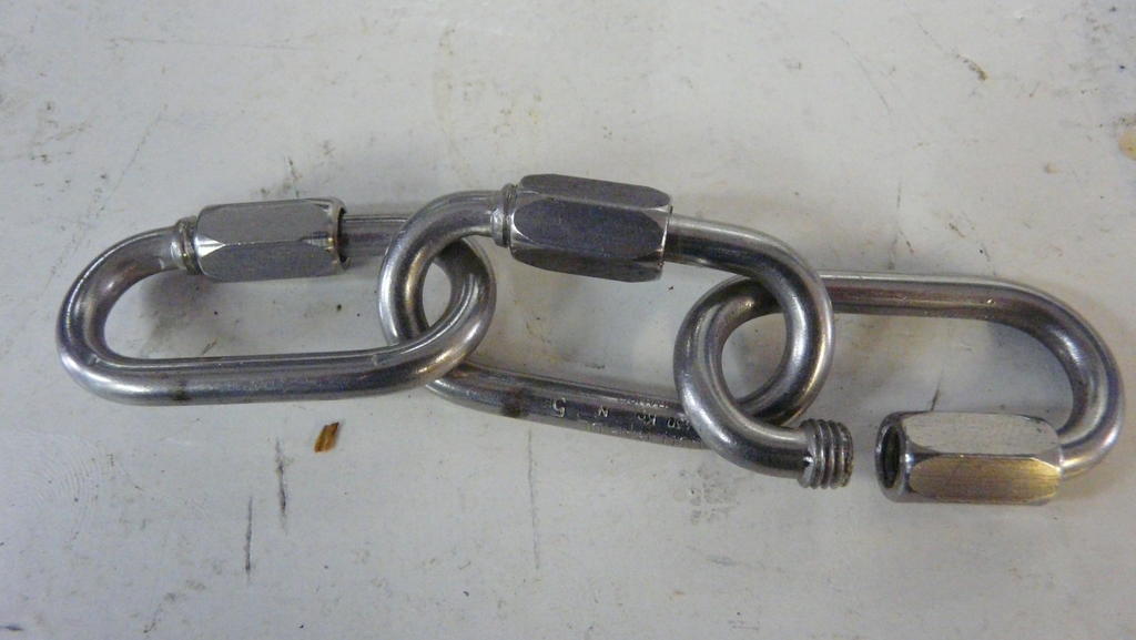

857 14 #8 Posted October 9, 2017 Thanks Ed, important information for me, I was going to use 10mm diameter quick links as in photo, can you tell me the material that is used in your last photo for the cross strap I like that idea and what terrain is that type best for. Share this post Link to post Share on other sites

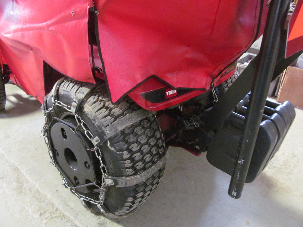

Ed Kennell 47,819 #9 Posted October 9, 2017 These rubber "chains" are factory made and the material has a cloth fiber cording imbedded in the rubber. They work very well in snow especially on paved driveways as they do not scuff the pavement like a steel chain. They probably are not as good as steel chains in soft or wet dirt. I bought a flat belt and plan to cut straps from that when these straps wear out. 1 Share this post Link to post Share on other sites

Sarge 3,473 #11 Posted October 9, 2017 You should be able to get a roll of the heavier twist link chain locally - that is the material for the cross links . The side chains are simple 2/0 pass link chain - should be available at any hardware store locally as well . The U-shaped connector links on the side are available from several tire chain suppliers - as well as the correct chain tool to open/close the links . Once you have the materials - it's not too hard to build a set from scratch but the cost is pretty close to a factory made set of chains . I'm surprised they aren't more readily available in the UK with the farming/garden industries there but maybe it's a lack of snow/ice like we can get here in the northern half of the country..? As far as the rubber style of chains - those would be cheaper to build . Just start hunting around for rubber belting - rock quarries and and stone processing plants use miles of the stuff in varying thicknesses and that type of rubber belts for conveyors is extremely well made . Around here if you ask any of the construction companies or workers the stuff can be had for free most times - I have some partial rolls here from worn out belts from rock conveyors used in asphalt (bitumen) plants and I work as a Union Laborer around this stuff all the time . I run steel chains on my tractors year-round since they are used on hills and doing heavy ground work - I hate getting stuck and even run mine mowing with no damage to the turf .... Sarge 2 Share this post Link to post Share on other sites
