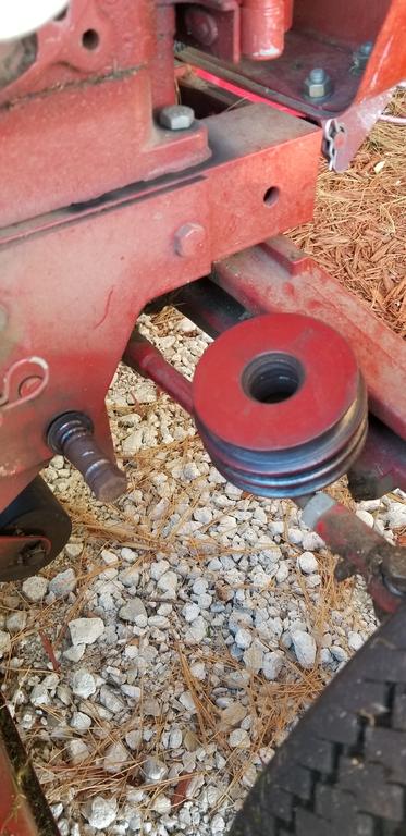

Vinylguy 4,691 #1 Posted October 8, 2017 Mowing the lake front for the final time and this pulley flew off. Not sure what I need to repair it. Will be storing it at my brothers shop this winter where week ca n work on it. Share this post Link to post Share on other sites

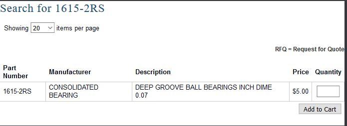

pfrederi 18,628 #2 Posted October 8, 2017 Two bearings WH # 6593 Converts t0 1615-2RS There should be a spacer between the two bearings inside the pulley WH6595 Shaft looks to be in bad shape. 1 Share this post Link to post Share on other sites
rmaynard 16,289 #3 Posted October 8, 2017 Is this your Commando 8? Share this post Link to post Share on other sites
squonk 43,709 #4 Posted October 8, 2017 1 hour ago, pfrederi said: Two bearings WH # 6593 Converts t0 1615-2RS There should be a spacer between the two bearings inside the pulley WH6595 Shaft looks to be in bad shape. Yup shaft looks whupped. If you can't find another one, I bet @buckrancher could make you a new one. Share this post Link to post Share on other sites
Vinylguy 4,691 #5 Posted October 8, 2017 1 hour ago, rmaynard said: Is this your Commando 8? Yes Bob Share this post Link to post Share on other sites
rjg854 12,151 #6 Posted October 8, 2017 (edited) I just got done redoing the one on my 36" deck. What you guys are looking at is what is left of the roller bearings and a spacer. Easy cheap fix. The bearings didn't even cost $5 1 hour ago, squonk said: Yup shaft looks whupped. If you can't find another one, I bet @buckrancher could make you a new one. Edited October 8, 2017 by rjg854 More information 1 Share this post Link to post Share on other sites
squonk 43,709 #7 Posted October 8, 2017 I just blew that pick up. You may be right as long as the races come off the shaft. I don't see any bluing so they may have not gotten too hot. Share this post Link to post Share on other sites

pfrederi 18,628 #10 Posted November 17, 2017 (edited) You just need the generic number any bearing supply house maybe even auto parts store should be able to order them Two bearings WH # 6593 Converts t0 1615-2RS Edited November 17, 2017 by pfrederi 1 Share this post Link to post Share on other sites

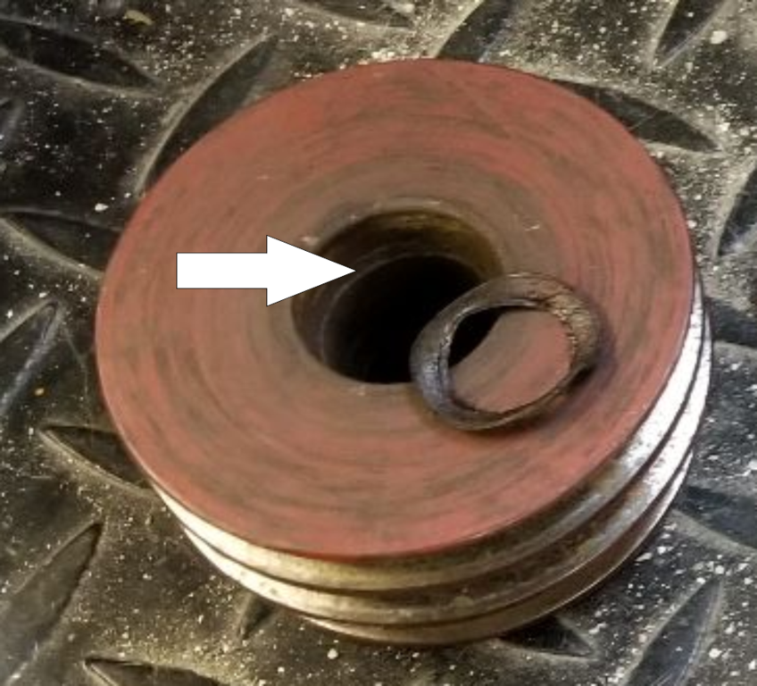

Vinylguy 4,691 #15 Posted November 17, 2017 Only image I have at home. Is this a stop for the new bearings or is it part of the old bearing? I am definitely ignorant when it comes to bearings. thanks for the help 1 Share this post Link to post Share on other sites
squonk 43,709 #16 Posted November 18, 2017 (edited) You can use a large socket, bigger than the o.d. of the race to support the pulley. Then use a thin punch to catch the race edge and drive it out from the inside. Edited November 18, 2017 by squonk 3 Share this post Link to post Share on other sites
ranger 1,798 #17 Posted November 18, 2017 If you're sure it's the outer track of the bearing you're looking at, if you have a welder, lay down a few runs of weld,not an awful lot, on the bearing race. What will happen is, the metal will expand, then after cooling, will be slightly smaller than it was originally. The bearing should then drift out much easier with less chance of damage to the housing. 2 Share this post Link to post Share on other sites
Vinylguy 4,691 #18 Posted November 22, 2017 should have thought of this sooner. Called A-Z tractor and he is sending me the parts I need ready to bolt on. problem solved. thanks everyone for the helpful replies. 2 1 Share this post Link to post Share on other sites
