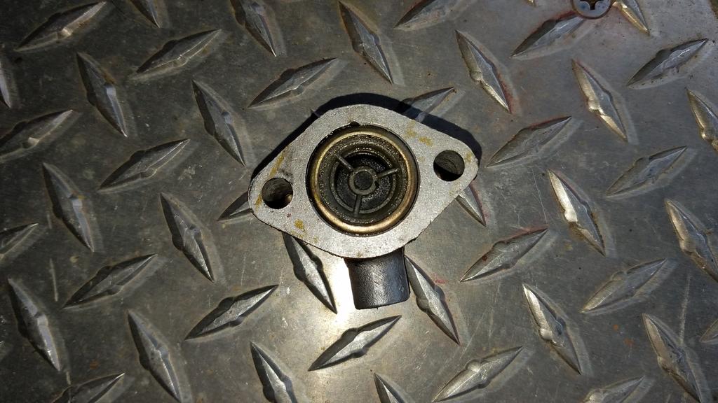

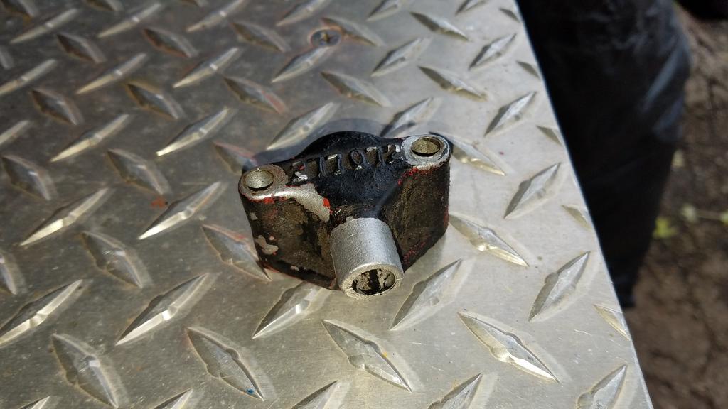

Sarge 3,471 #7 Posted October 8, 2017 Here is the suspect breather valve - it sits on top of the governor on the K-482/523 engines . Not sure about the machined recess against the sealing area of the gasket - it allows air back towards the crankcase which is not what this valve should be doing in my opinion - just not sure of it's purpose . Might just be a sort of pressure relief . The valve relies on the engine's vacuum through the carb at a certain level as well as the cylinder pulses to create a slight vacuum . I did find some carbon/dirt in this one , but not much and the valve seems to operate just fine . The part number is retired by Kohler from research but the odd sized U-shaped 9/16" hose is available for around $23 from some of the vendors . Here's the business side of the valve - note the recess machined into the gasket sealing area - Might want to clean your valve if you're having oil leaks - any pressure in the crankcase will force oil through the old seals/gaskets in a hurry . I have had an issue with this engine somewhat pushing oil through the dip stick's center rivet on mine as well as the pto side bearing plate to crankcase gasket - maybe this was the culprit from the dirt that was in it ? Sarge Share this post Link to post Share on other sites
"Manic-Mechanic" 1,485 #8 Posted October 8, 2017 Excellent, I will take mine off and replace the gasket while inspecting and or cleaning what I can. Share this post Link to post Share on other sites
