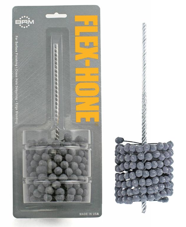

rmaynard 14,888 #2 Posted October 5, 2017 I use a 320 grit ball hone. I use whatever oil I have available. You are only cutting for about 45 seconds at 500 to 1200 RPM, and constantly moving the tool up and down. 4 1 Share this post Link to post Share on other sites

rmaynard 14,888 #4 Posted October 5, 2017 I have had no problem using only the 320. Remember, all you are doing is breaking the glaze, not taking out major scratches or grooves. A new set of rings won't seat into a smoothe, shiny bore. 2 Share this post Link to post Share on other sites

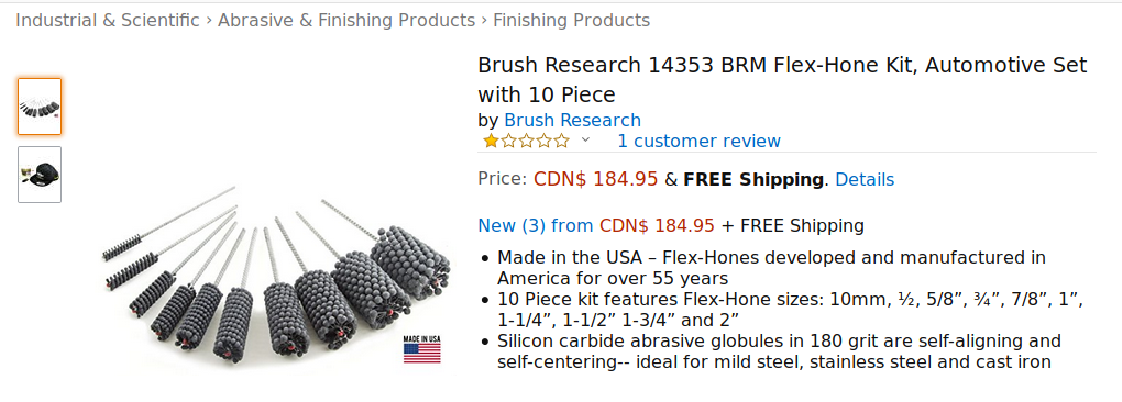

The Tuul Crib 7,332 #6 Posted October 4, 2019 On 10/5/2017 at 11:58 AM, rmaynard said: I use a 320 grit ball hone. I use whatever oil I have available. You are only cutting for about 45 seconds at 500 to 1200 RPM, and constantly moving the tool up and down. Where can you get this size? Share this post Link to post Share on other sites
bc.gold 3,399 #7 Posted October 4, 2019 Have your local Napa order the size you need or you can purchase a full selection. Share this post Link to post Share on other sites
