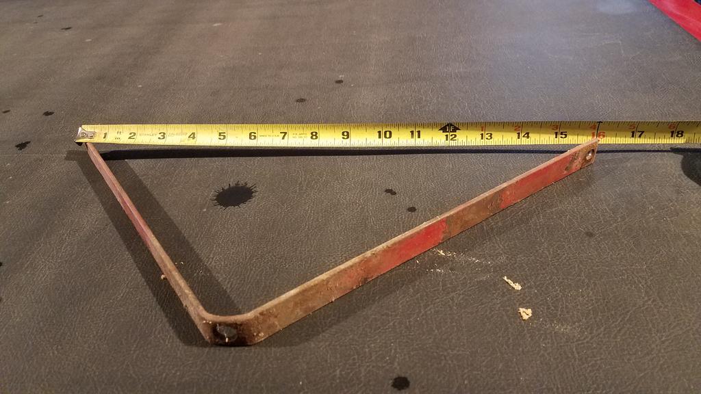

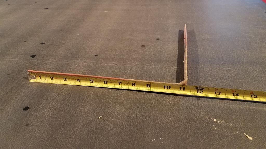

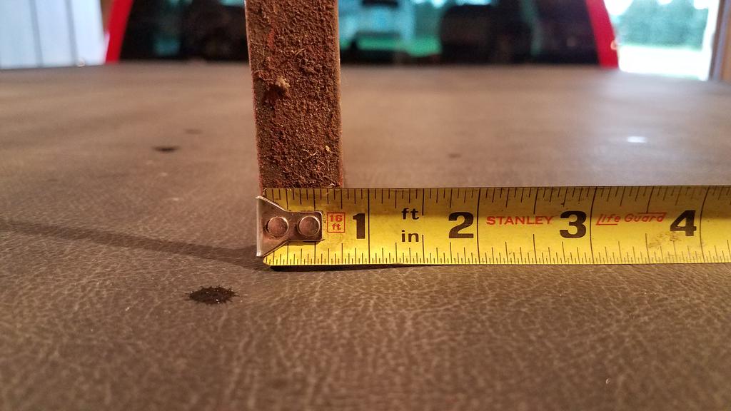

CasualObserver 3,417 #3 Posted October 5, 2017 Its made form 1/8" x 3/4" flat stock. 22-1/4" long. Top of the V is 16" across... bottom flat-ish spot is about 3/4". Makes each side about 10-3/4". 2 Share this post Link to post Share on other sites

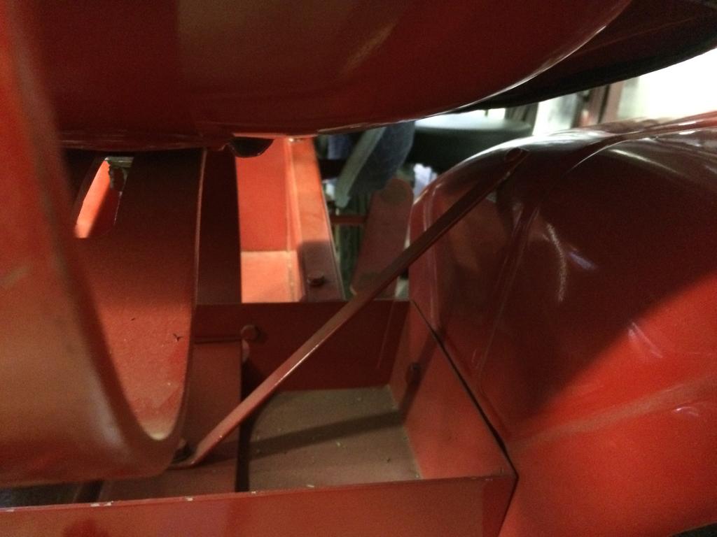

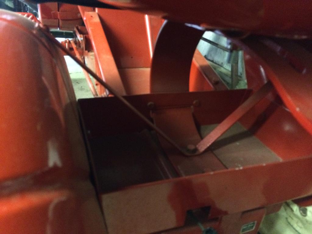

RedRanger 1,470 #4 Posted October 5, 2017 50 minutes ago, Racinbob said: Chris, what fender brace are you referring to? I was thinking the 701 just used the two fenders bolted to the tool box. One year only I believe. Mysterious..... and rare. 1 Share this post Link to post Share on other sites
Chris G 3,392 #5 Posted October 5, 2017 Thanks for the help. And yes it's a one year piece. Cause the tool box is shorter they used the brace. Share this post Link to post Share on other sites
Racinbob 13,250 #6 Posted October 7, 2017 Very cool. I don't see this on any parts list. Am I correct is assuming that the 'V' is bolted on with one of the bolts holding the tool box on the transmission? Share this post Link to post Share on other sites
Chris G 3,392 #7 Posted October 7, 2017 Your assumption is correct. Share this post Link to post Share on other sites
