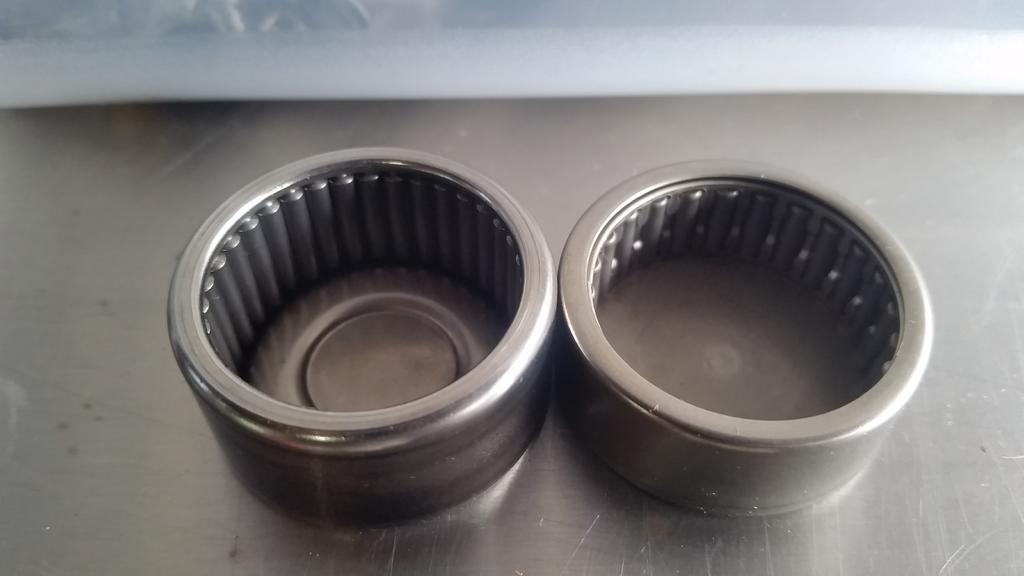

MoistMeatloaf 1 #1 Posted October 5, 2017 I recently picked up a C-161 rear end. When I opened the case one of the m-16121 bearings was shot so I removed all 4 of the drawn cup bearing in order to replace them all. That's when I realized there was one with a different width (.625). I have read on this forum that people suggest using a .5" wide bearing to replace the unavailable .625". I purchased the .5" replacement but after I looked at the original .625 it seems to be in good shape. Should I use the new .5" bearing or take my chances with re-installing the original? Share this post Link to post Share on other sites

WHX?? 57,901 #3 Posted October 5, 2017 Loaf ...Dave hit the nail on the head being as old as it is and even the best pixs can't allow us to run our fingers over a rough or smooth bearing surface so I would go by gut feel as to replace or not to. Since you are (hopefully) not going to ride this thing to the moon I would be OK with using the old one if it felt right. If you only want to have this transmission only open once the put the new one in and save the older one for possibly a less, if there is such a thing, critical application. As for the 1/8 difference seated properly won't make a difference. 1 Share this post Link to post Share on other sites
Pat_In_Denver 104 #4 Posted October 5, 2017 To my eye, the bearing on the left is much higher quality as there are twice the needle rollers. Assuming it's the original WH and has limited wear and as Jim stated it "feels right", I'd stick with it. 2 Share this post Link to post Share on other sites
WHX?? 57,901 #5 Posted October 5, 2017 Agreed Pat I had noted that as well but does it look like to you the one on the right is caged better??? Share this post Link to post Share on other sites
953 nut 68,782 #6 Posted October 5, 2017 I also agree with Pat, the original bearing appears to be superior. Also, the one that came out has a closed end, is that a factor? Share this post Link to post Share on other sites

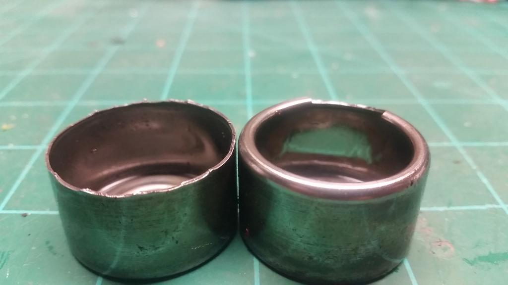

MoistMeatloaf 1 #7 Posted October 5, 2017 The bearing on the left is the original and it feels and looks to be in good shape. The only reason I am hesitant about reusing it is because of the shape of the other 3 bearings I removed. It turns out that 2 of the M-16121 were missing the flange that holds the needles in. The needles stayed in place until I removed the gears but the pieces of metal from these bearings were found inside the case and stuck to the magnet on the screen. I am worried about this happening to the original .625 if I decide to reuse it. Share this post Link to post Share on other sites

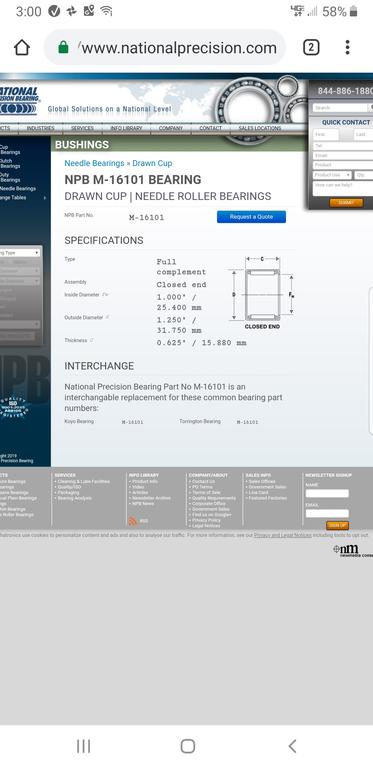

MoistMeatloaf 1 #10 Posted October 5, 2017 It is a C-161 twin automatic that has (3) M-16121 and (1) M-16101 drawn cup bearings that were original made by Torrington. Its the M-16101 bearing I could not locate and this forum has said is discontinued. 1 Share this post Link to post Share on other sites
stevasaurus 23,816 #11 Posted October 5, 2017 Got ya...BTW they do make C-161 manual 8 speeds. I see nothing above that clarified it was an auto...that is why I said "if". That M-16101 should measure 1" id x 5/8" height. The 1/2" height should do you OK...make sure the bearing is flush with the outside. 1 Share this post Link to post Share on other sites
953 nut 68,782 #12 Posted October 5, 2017 32 minutes ago, stevasaurus said: make sure the bearing is flush with the outside 5 hours ago, MoistMeatloaf said: 2 of the M-16121 were missing the flange that holds the needles in I think the previous bearings probably were not set flush and the flanges were cut by the spinning gears. 1 Share this post Link to post Share on other sites
gt14rider 1,278 #13 Posted April 18, 2019 (edited) On 10/4/2017 at 8:37 PM, MoistMeatloaf said: I recently picked up a C-161 rear end. When I opened the case one of the m-16121 bearings was shot so I removed all 4 of the drawn cup bearing in order to replace them all. That's when I realized there was one with a different width (.625). I have read on this forum that people suggest using a .5" wide bearing to replace the unavailable .625". I purchased the .5" replacement but after I looked at the original .625 it seems to be in good shape. Should I use the new .5" bearing or take my chances with re-installing the original? Can you tell me were you purchased the m 16081 bearing 1 x 11/4 x 1/2 Edited April 18, 2019 by gt14rider Share this post Link to post Share on other sites
stevasaurus 23,816 #14 Posted April 19, 2019 Try Motion Industries...you may have to call the nearest one near you. M-16081 should work for you...the 5/8" bearing is not available. I would use the new one and save the old one. Share this post Link to post Share on other sites
pfrederi 21,095 #15 Posted April 19, 2019 5 minutes ago, stevasaurus said: Try Motion Industries...you may have to call the nearest one near you. M-16081 should work for you...the 5/8" bearing is not available. I would use the new one and save the old one. I tried a search at Motion Industries and EB Atmus (my regular bearing source) no hits on M-16081 1 Share this post Link to post Share on other sites
stevasaurus 23,816 #16 Posted April 20, 2019 I did not get any hits either Paul...that is why I said you may have to call them. I should have stated that...sorry. Share this post Link to post Share on other sites
gt14rider 1,278 #17 Posted April 20, 2019 I found this, asked for quote not got a reply yet Share this post Link to post Share on other sites
