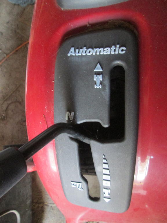

Jerry77 1,218 #7 Posted October 4, 2017 Probably a vertical shaft - if hydro it will have a release for the hydro so you can move it around..probably located on the rear sheet metal.. Share this post Link to post Share on other sites
WHX?? 57,935 #8 Posted October 4, 2017 Good points guys ....yes look for that tow valve if it is a hydro Jeff. Share this post Link to post Share on other sites

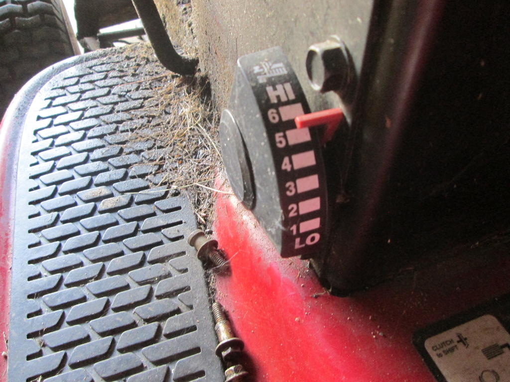

jeff lary 173 #9 Posted October 4, 2017 Ok guys I will remember that. I am assuming he will want to bring it to me this weekend but I am not sure. So of it is a hydro and has this tow valve and I am able to find it....will it harm it to tow it 3-4mph for about 500 yards? Share this post Link to post Share on other sites
WHX?? 57,935 #10 Posted October 4, 2017 No not at all just go slow... some later Peerless and Tecumseh have a lever or a rod that must be positioned for towing. should be labeled or in the manual if you have one. If all else fails you can get the rears up on a cart or dollies for a short haul. Share this post Link to post Share on other sites

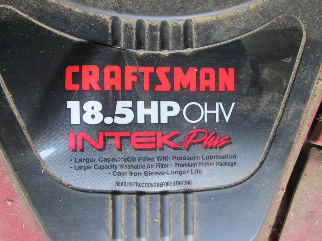

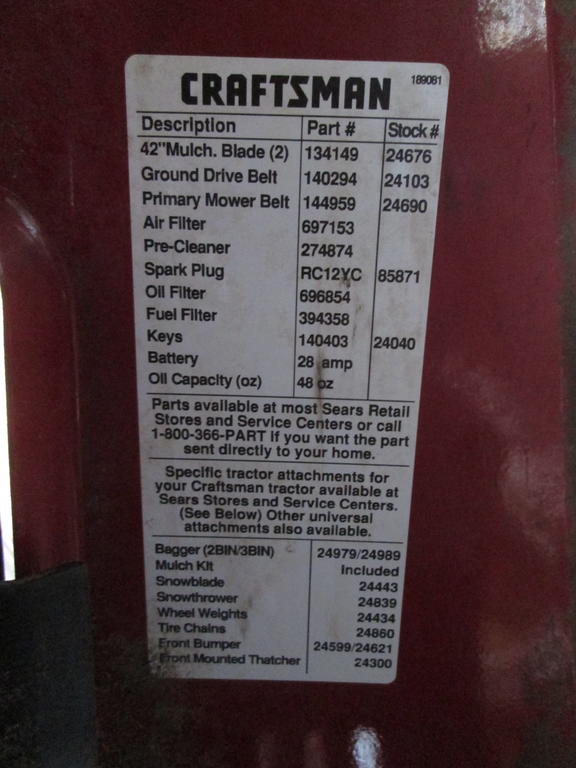

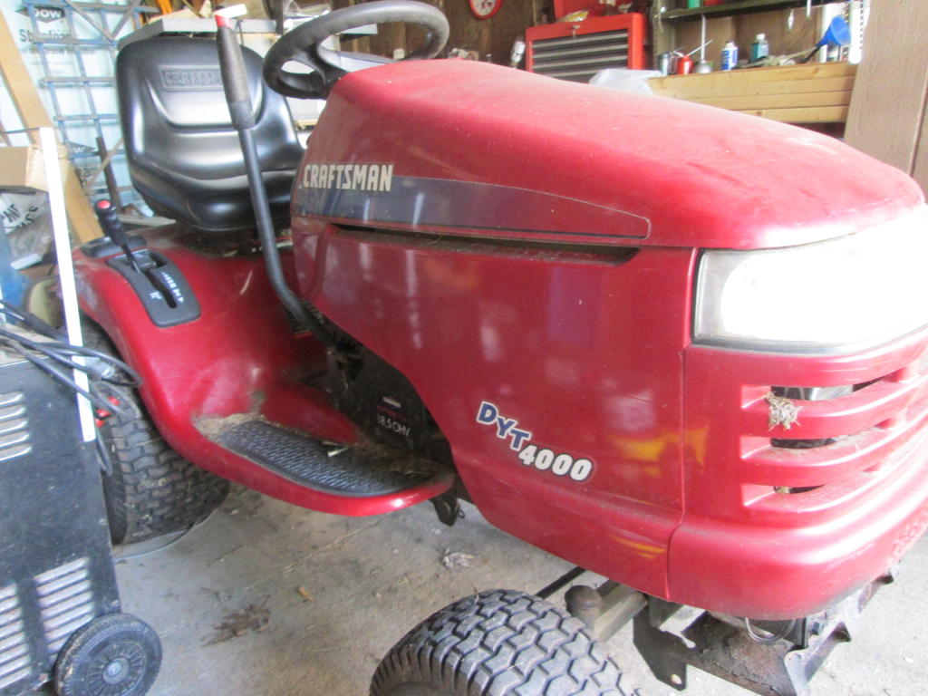

jeff lary 173 #12 Posted October 5, 2017 Ok so I went over after work and looked it over. It is a Craftsman DYT 4000. It is Hydro my sister thinks. I still have not talked to my brother in law. It has an18.5 hp Intek Plus engine. Model 917.273640. According to my sister it had been burning oil a long time and smoked a little (rings maybe?) she has MS and it is very hard for her to get around and he works all night delivering freight between ME and NH . So they had the grand daughter mowing for them. The girl said she was mowing and it just quit,.. the starter when engaged will not turn the engine over. I am guessing that maybe the ring or rings broke and is binding up the works. I guess that is what I can think of. Like I said the tractor is not here and may not be till Sunday but this is what I know for now. The engine is filthy it had the crank case breather hose come off at one point and covered the motor in a fine mist of oil then you mow with it and viola you have a very nasty mess under the hood. Share this post Link to post Share on other sites
jeff lary 173 #13 Posted October 5, 2017 If I can remember how I will post a few photos of the tractor I took today. The pics just show the tractor, the flywheel cover text, a under hood label, a speed? gauge thing... and the trans shift pattern . There was a question as to weather it was a hydro or not and I hoped this info would help. Sister says yes it is a hydro. I don't really have anything to add as stated before I do not even have the tractor here yet. This may sound stupid but I came back to this thread trying to plan a way to copy and paste this into the "correct forum"( " Other brands") but it looks to me like some very good soul has already moved it here for me? if so thanks,.. if not I will try to figure out how to get it moved but looks to me like it is now in the right place. Jeff Share this post Link to post Share on other sites

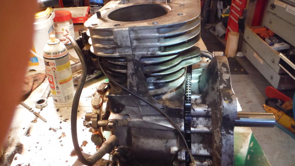

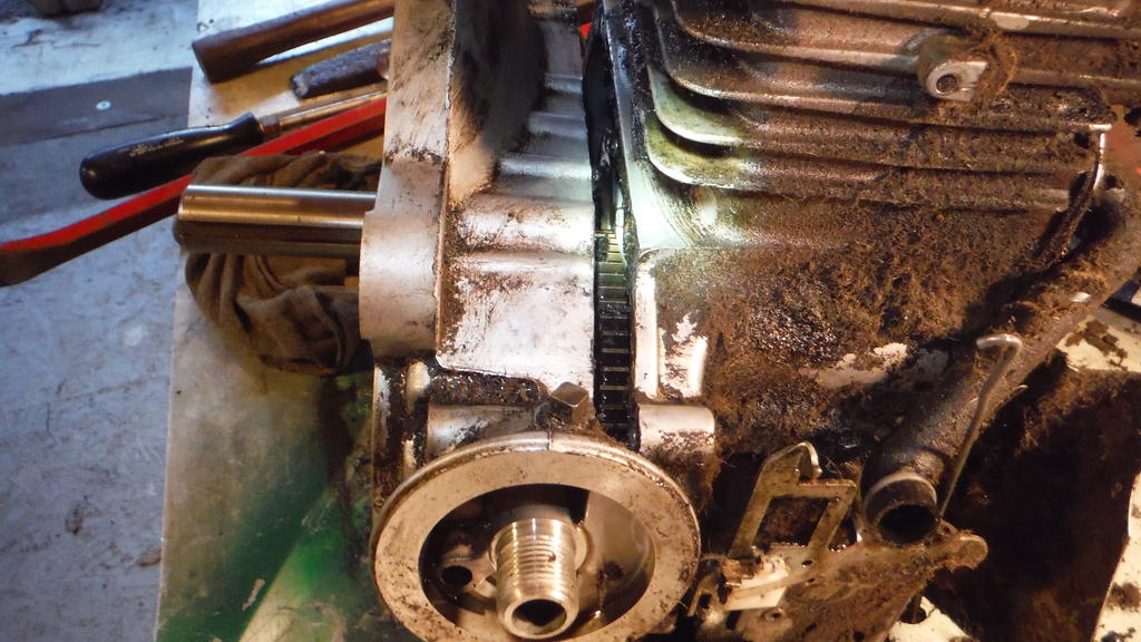

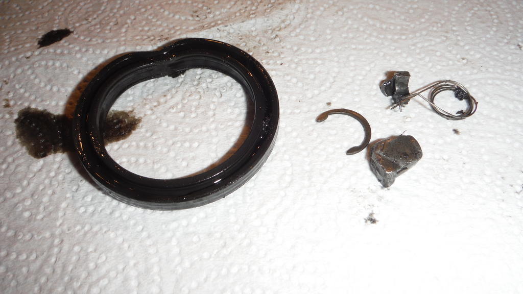

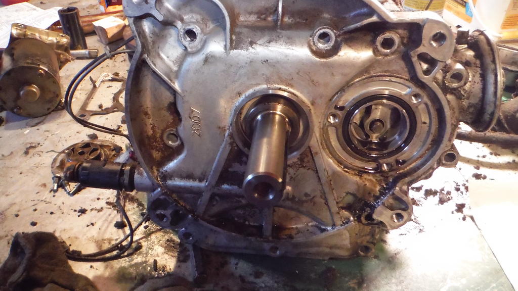

jeff lary 173 #24 Posted October 15, 2017 Well we had our first work afternoon . The engine is out on my bench but we cannot get the" base or short block cover" (in his little owners manual it was called one of these names?) off. I have to believe that the cover is designed to come off over the crank shaft. but I swear it acts like the cover and shaft are all one unit. We got the bolts all out and the cover separated about 3/8 or a 1/2 inch but it will not come off the engine. We just wanted to look inside to see what broke. How does this cover come off ? With the cover / base/ short block cover opened up a little,.... the pieces of steel, C-Clip, the spring and the pieces of steel fell out on the white paper towel, the seal we took out. Share this post Link to post Share on other sites
Dakota8338 115 #25 Posted October 16, 2017 I despise Briggs & Stratton Engines. I have never had one which I felt like gave dependable service for its cost & refuse to buy anything with a B & S engine any more. Considering what fell out, may only be the tip of the iceberg, so to speak, and an engine swap is most likely going to be the cheaper option to trying to rebuild the engine you have. That is probably not what you were hoping for. Checking the yellow pages in your locale and making phone calls might very well locate a suitable engine on a mower with other problems, rusted out deck, bad transmission, etc which could be obtained at a reasonable cost. Best of luck with completing your project. Share this post Link to post Share on other sites
