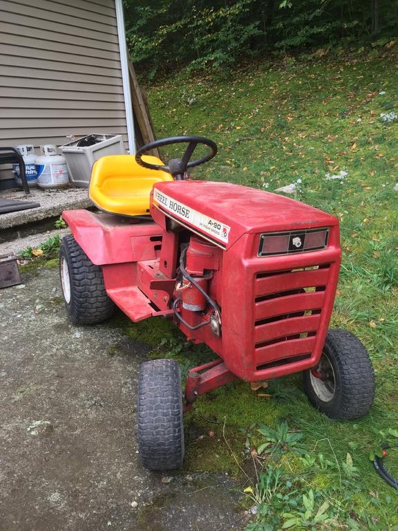

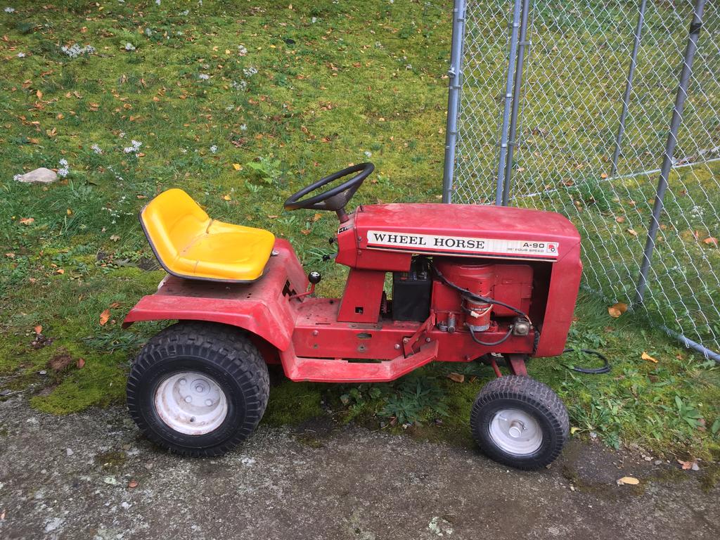

joskuk 67 #1 Posted September 30, 2017 (edited) I have had an A-90 sitting in the back of my garage for years now, decided to try and get it running today. Had to replace leaky fuel line and swap a battery in from a dead tractor. I got it running but tried to drive it and it does not move. This is a 4-speed, and I can see the input pulley of the transmission spinning. But when I start to release the clutch it makes a strange noise in the back (not quite grinding, but similar). I figure it has to be something internal but you guys know better than me. Edited September 30, 2017 by joskuk 1 Share this post Link to post Share on other sites
