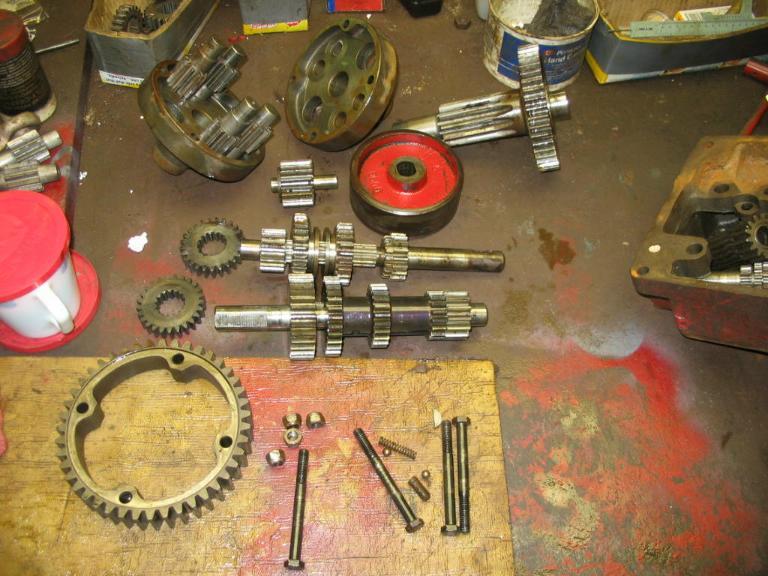

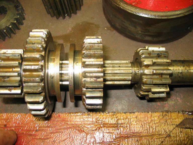

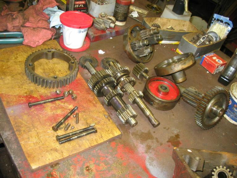

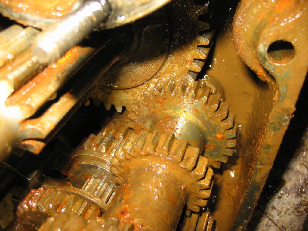

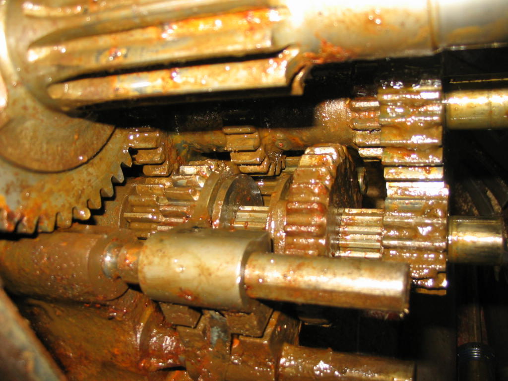

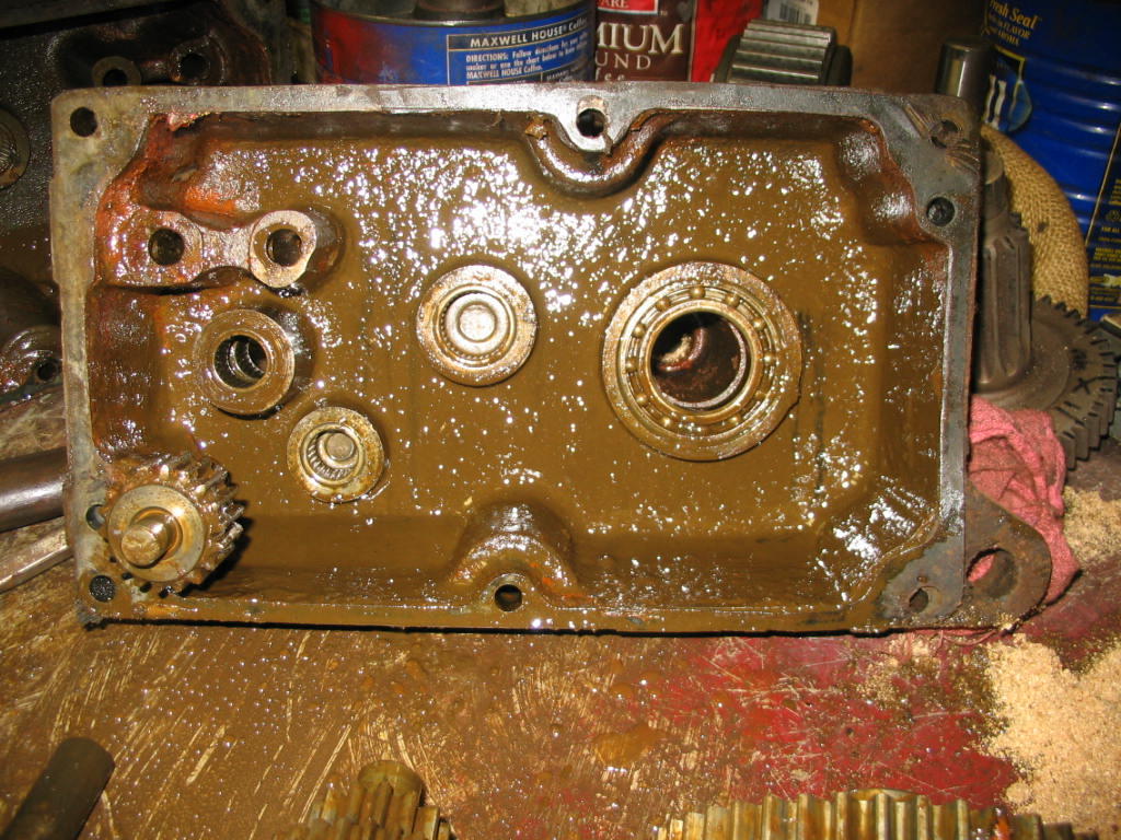

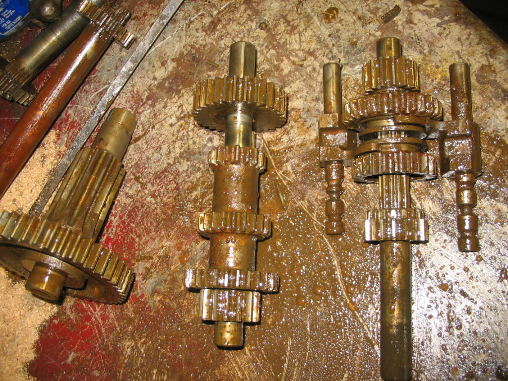

daveoman1966 3,611 #2 Posted September 29, 2017 The only cost to you would be a few gallons of kerosene, and a $8 shift boot. I had one in similar condition a few years ago and...suprisingly... the gears inside cleaned up very good. Most of the rust is from the cast iron trans case halfs.... the rust hits them firts and...seemiingly...sacrafices itself for the life of the hard steel gears. check out these old pics of mine 5 2 Share this post Link to post Share on other sites
953 nut 51,736 #3 Posted September 29, 2017 Presuming the axle bearings aren't sloppy I would say flush it and see what it is like after. Even if you were going to open it up right away you would want to flush it first. After the flush you can hear how it sounds in each gear and decide what it's fate will be. 3 1 Share this post Link to post Share on other sites
