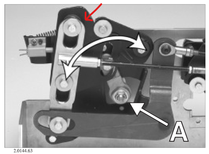

I would jack the tractor up with the fender off, and have someone hold the drive forward while someone else steers. If you see the bracket marked below (with red arrow) moving at all when you are steering with a steady throttle, then there is an issue with the smart steer linkages.
I didn't watch the video, did you do a proper smart steer delete kit or just bolt the end of the bar somewhere?

As for deleting the Smart Turn I followed the guy's instructions in the video. Just disconnected the Linking flat bar from the steering sector. Rotate the bar straight towards the front of the tractor. Bar and linkage is pushed back as far as it will go to the back of the tractor. There is a pre-drilled  hole in the frame to install a bolt,  washer spacers, and nut to solidly bolt the linking bar to the frame. (Somebody was thinking ahead of time). I verified the linkage at the hydro transmission would no longer enable the Smart Turn from changing, in anyway, moving forward, or turning the steering wheel. Same for reverse motion. What a mechanical nightmare.
