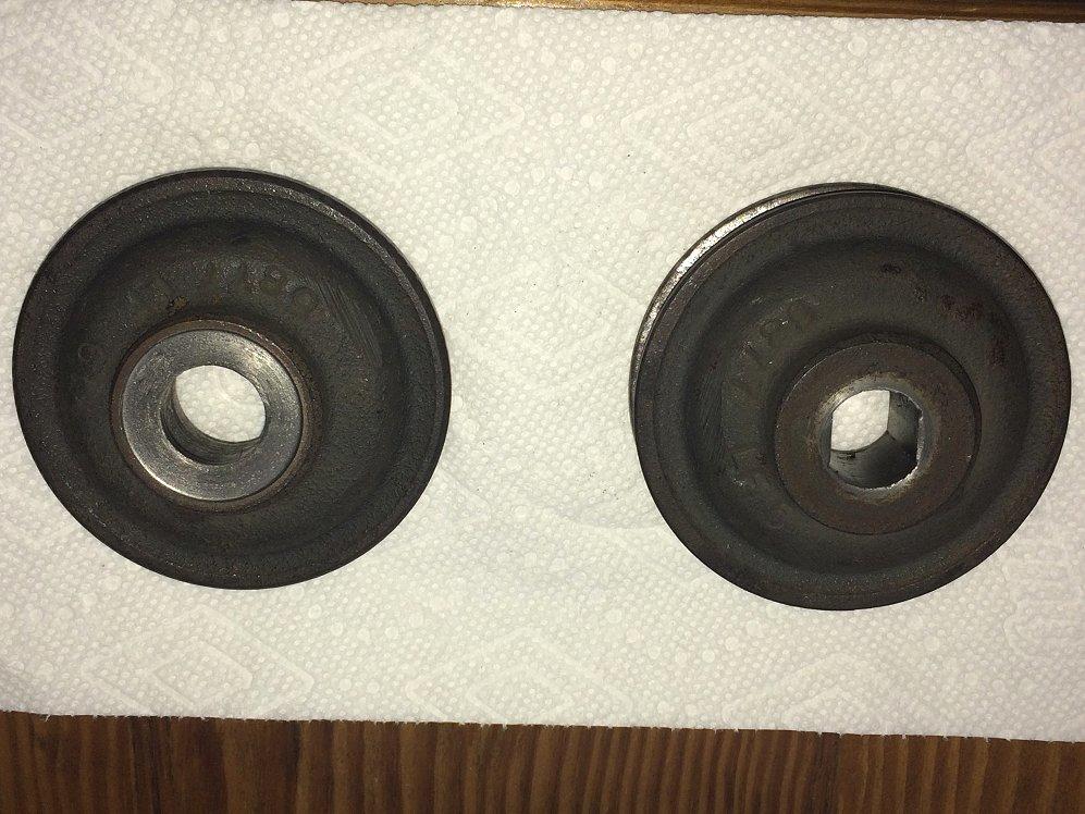

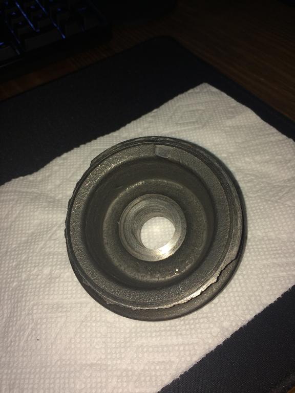

Bob Nakon 55 #1 Posted September 22, 2017 Hello Gents, I thought I had a bad belt on my deck so I opened it up and I do need a belt because one of the spindle drive pulleys is worn to a razor edge. It has also been spinning on the thrust washer. Does anyone know where I could find one? Toro dealer doesn't have one. This is a double D shaft deck but the pulley has a round 3/4 " hole. Thanks, Bob Share this post Link to post Share on other sites

daveoman1966 3,884 #3 Posted September 22, 2017 The 42" deck Lt or RT spindle pulley is # 5877 or 106846. If the center hole is round, then it is completely slopped out. There should bo no thrust washer at all. There may be a spacer, but it too would be double d configuration. I do not have any 5877 pulleys and they are hard to find. Better that you replae the entire spindle to escape the DD configuration... Newer model spindles will bolt right in, but will need to have non-DD blades tool. 2 Share this post Link to post Share on other sites

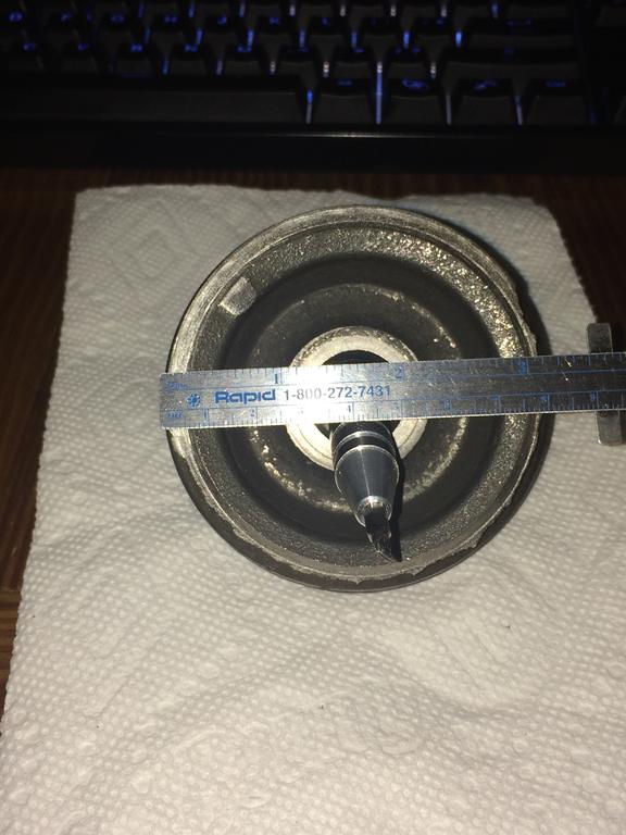

Ed Kennell 46,606 #4 Posted September 22, 2017 Can you post a picture with the OD dimension. I may have one. 2 Share this post Link to post Share on other sites
Bob Nakon 55 #5 Posted September 22, 2017 Here are some pics. It looks pretty close to 3 3/8 dia. The hole is round and so is the shaft. Bob 2 Share this post Link to post Share on other sites

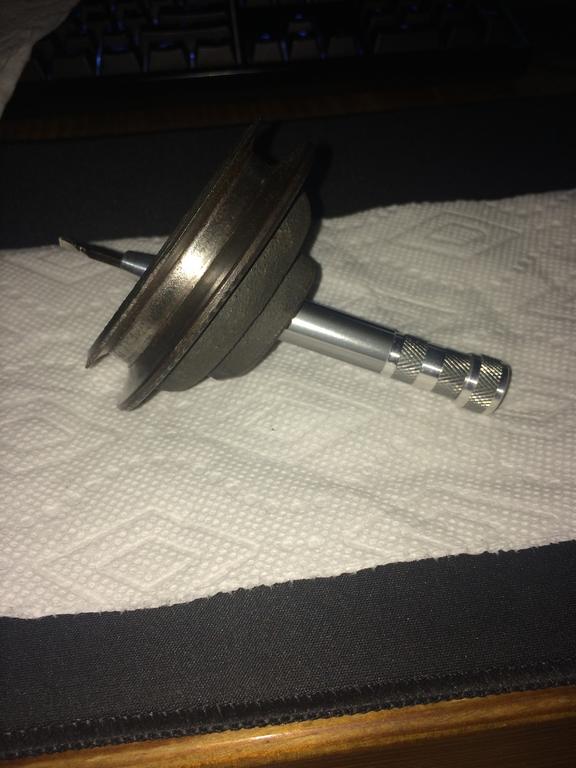

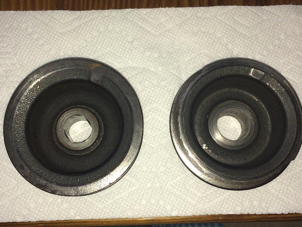

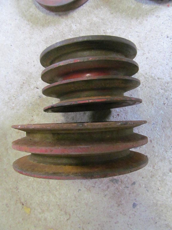

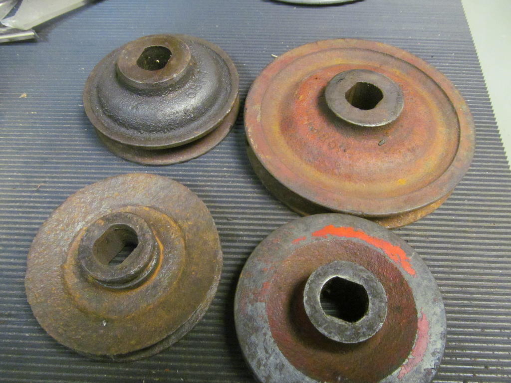

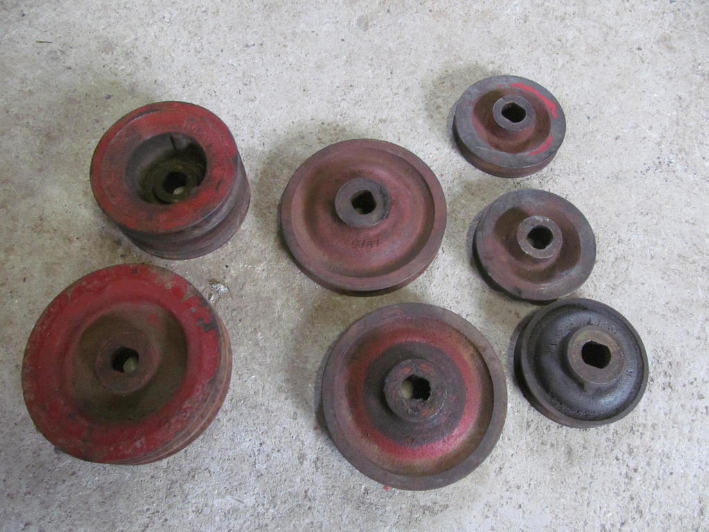

Ed Kennell 46,606 #12 Posted September 23, 2017 I have the single side pulleys. 3 3/8 OD and 4 3/4 OD. Can you post a picture of the shaft. I have never seen a cast iron pulley wear out a steel shaft. If you are interested in the pulley, send me a PM. 1 1 Share this post Link to post Share on other sites
Bob Nakon 55 #13 Posted September 23, 2017 Ed, I'll go out to the barn and get some more pics tomorrow morning. I'll take the pulley off the other spindle so I can compare them. I'll be back on here tomorrow, I need help. ACman, I didn't receive your message. Would it be up in the little envelope at the top of the page? I didn't see it in my email either. I'd like to talk to you. I really don't know how to navigate this site yet so I may not be looking in the right places for messages. For all I know I have broken protocol by posting this topic in this forum. If I screw up I'm sure someone will tell me. Thanks for the responses guys, see you tomorrow. 1 Share this post Link to post Share on other sites

Bob Nakon 55 #15 Posted September 23, 2017 Well, Dave was absolutely right. The flats on the spindle wore the hole round, and the wear on the top and bottom is remarkable. It must have been running loose for quite a while. Makes me feel kind of dumb for not catching it. When I took the left pulley off I was surprised. So now I hunt for a replacement. Bob Share this post Link to post Share on other sites

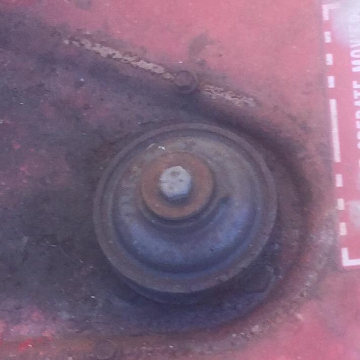

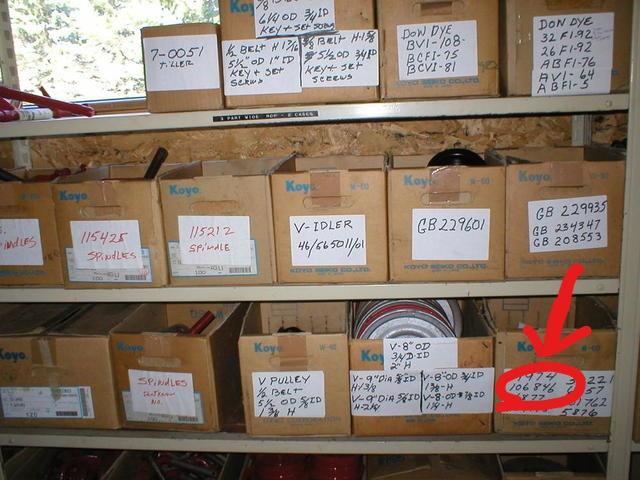

ACman 7,735 #16 Posted September 23, 2017 (edited) This it 5877 cast number ... It's on my cousin's deck and we never used it . The center pulley turns hard and was off the tractor when he got it . I don't know what his plans are for this deck ? Edited September 23, 2017 by ACman Share this post Link to post Share on other sites
Bob Nakon 55 #17 Posted September 23, 2017 Sure looks like it could be it AC. 1 Share this post Link to post Share on other sites
ACman 7,735 #18 Posted September 23, 2017 Looks like Ed has one too ... either way ! Share this post Link to post Share on other sites
