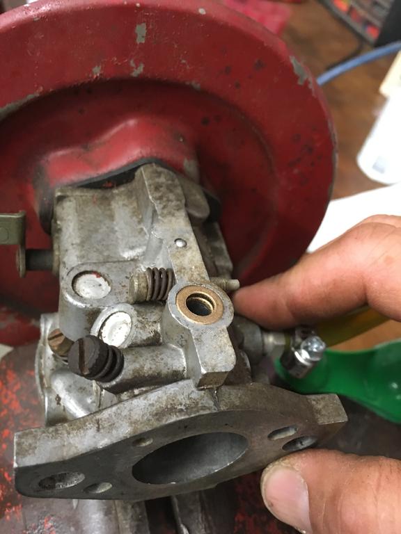

TonyToro 1,133 #6 Posted September 23, 2017 Ok just got done working on it for the night. Spraying carb cleaner by the top of the shaft the engine slows down? Thoughts? The shaft has some play left right up and down. Share this post Link to post Share on other sites
Ed Kennell 43,077 #7 Posted September 23, 2017 (edited) Hmm, they usually speed up. But it is indicating you have air leaking in. I would install a new shaft bushing or just replace the carb. Are the jets set to spec? Edited September 23, 2017 by Ed Kennell Share this post Link to post Share on other sites
Digger 66 3,488 #8 Posted September 23, 2017 8 hours ago, TonyToro said: Spraying carb cleaner by the top of the shaft the engine slows down? Thoughts? The shaft has some play left right up and down. Carburetor cleaner will kill the engine if it's entering the venturi . Starting fluid makes 'em speed up . Speaking from memory , there's a bushing kit available that comes with a new throttle shaft and a bushing with an oversize O.D. that will correct this . I did mine years ago but lost the before and after pics in the great computer meltdown . 3 Share this post Link to post Share on other sites

oldredrider 2,553 #11 Posted September 24, 2017 @Squonk, you can get carb bushings at True Value hardware stores. Hillman bushing #58087. Just double stack them. Most likely, the throttle shaft will not need replacing. I like my hot dogs loaded! 2 1 Share this post Link to post Share on other sites
roadapples 6,985 #12 Posted September 24, 2017 @oldredriderwithout seeing these bushings yet, not sure what you mean by double stacking... Share this post Link to post Share on other sites
oldredrider 2,553 #13 Posted September 24, 2017 They are thinner than the Kohler bushings. Just use two of them stacked. 1 1 Share this post Link to post Share on other sites
Tuneup 1,452 #14 Posted September 24, 2017 I got mine at the blessed Ace Hardware. Two stacked and all the play is gone. Good luck! 4 Share this post Link to post Share on other sites
953 nut 62,119 #15 Posted September 24, 2017 8 hours ago, oldredrider said: double stack them. Most likely, the throttle shaft will not need replacing. An oiled felt washer between the two bushings could help seal them. 2 Share this post Link to post Share on other sites
TonyToro 1,133 #16 Posted September 24, 2017 9 hours ago, oldredrider said: @Squonk, you can get carb bushings at True Value hardware stores. Hillman bushing #58087. Just double stack them. Most likely, the throttle shaft will not need replacing. I like my hot dogs loaded! Oh no kidding. Ok I'll head there after work tomorrow. Thank you for that tip. I'll post up how it goes. 11 minutes ago, 953 nut said: An oiled felt washer between the two bushings could help seal them. Ok I'll get those too. Are there going to be bushings on the top and bottom of the throttle shaft? 1 Share this post Link to post Share on other sites

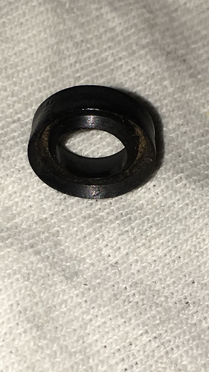

TonyToro 1,133 #17 Posted September 27, 2017 (edited) I installed 2 hillman bushings last night. Super easy. There was a rubber conical washer in there. Odd. It starts much better. A little more time and all the bugs will be worked out. Thank you guys for the tips. Edited September 27, 2017 by TonyToro 3 Share this post Link to post Share on other sites
