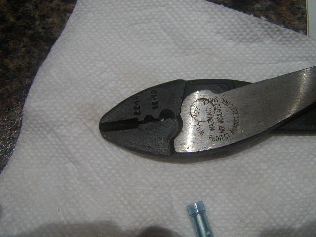

6bg6ga 272 #11 Posted September 23, 2017 (edited) 20 hours ago, KC9KAS said: Agreed abut McMaster-Carr, but I didn't see any of the terminals that are used with the Packard 56 connectors. They have a little "clip" on them that hold them in place in the connectors. I may have missed them, like everything else, my eyes aren't as good as they once were! When you purchase quality connectors that fit properly you don't need the click style simply because they fit very tight. In addition to the "Good" connectors I would suggest purchasing the CORRECT crimp tool for those connectors and it is a T&B crimp tool. The T&B crimp tool as its called don't make the typical flat crimp like the cheap tools do. Instead it actually pushes the metal up to really grip the wire. If you look at the tool you can probably see what I'm trying to explain. This particular tool is made by Klein tool and will do a variety of gauges 22-14 and 10-12 Edited September 23, 2017 by 6bg6ga Share this post Link to post Share on other sites
Sarge 3,473 #12 Posted September 23, 2017 Yes , those are excellent crimpers - I have an original pair of Thomas and Betts that I've owned now for over 30yrs , still work as the day I bought them . I never cut anything but tape or copper wire with the cutters - these are lifetime warranty US made tools that last a lifetime - think I paid around $22 when new back then... Sarge 1 Share this post Link to post Share on other sites
