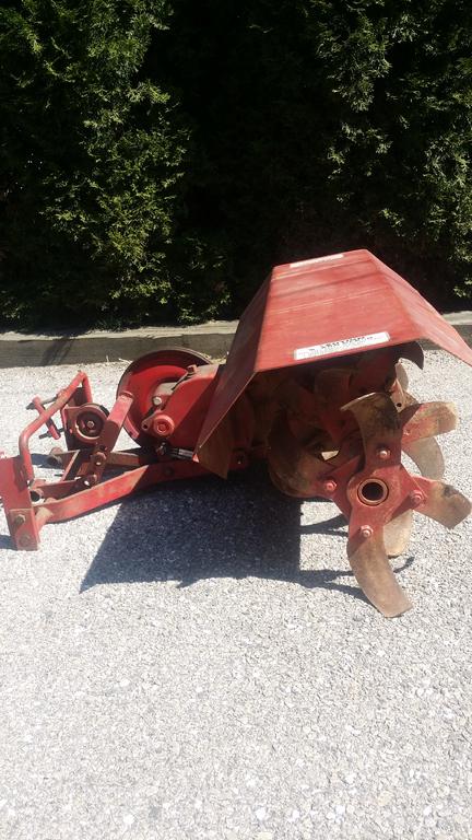

Ed Kennell 45,027 #1 Posted September 20, 2017 Picked this at todays auction. 6 4 Share this post Link to post Share on other sites

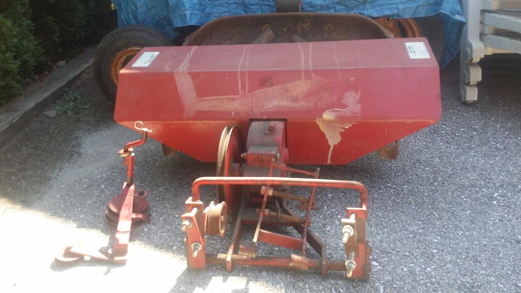

Racinbob 12,807 #10 Posted September 21, 2017 Ed, I'm curious. What model # is that? It looks like a 7-1211 like I had but there's a bracket I didn't have and I don't see it on the parts list. I'm referring to the kinda L shaped bracket just in front of the gear housing. I just had a rod connected that ran through the slot hitch to lift it. I also converted it to utilize the one belt drive setup like the newer models. Share this post Link to post Share on other sites

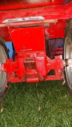

Ed Kennell 45,027 #11 Posted September 21, 2017 Yeah, that's it Bob. This one has a lift frame that mounts to the transmission hitch pin and is connected to the tiller by a flat bar on the left side. I have this frame swiveled up above the axle bracket for picture taking purposes. I gotta admit, I only know how to mount Mad Max. And that's because I built it. This WH design looks more involved than my Mad Max. Especially if you have a frozen hitch pin. 3 Share this post Link to post Share on other sites

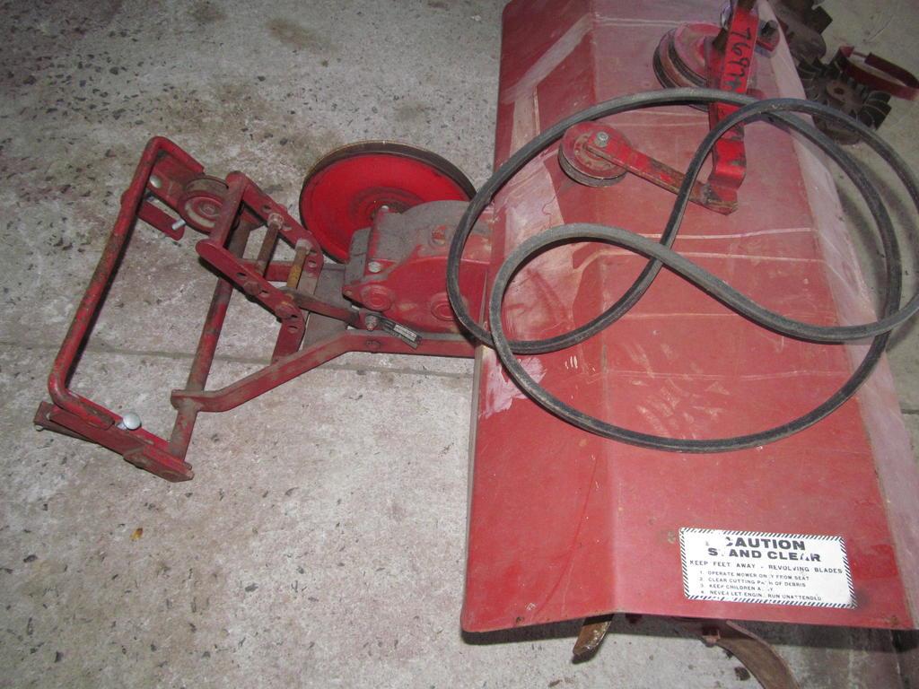

Racinbob 12,807 #12 Posted September 21, 2017 That's interesting. That doesn't show up anywhere. The manual shows it being lifted by the slot hitch like mine was. The two belt drive has the pulley bracket mounted right in front of the transmission. A belt runs outside the tractor drive belt guard and a second guard over that. Then a second belt back to the tiller. It was a real pain which is why I converted mine to the newer one belt setup. Share this post Link to post Share on other sites
elcamino/wheelhorse 9,363 #13 Posted September 21, 2017 Frozen hitch pin , sound BFH time 2 Share this post Link to post Share on other sites
Ed Kennell 45,027 #14 Posted September 21, 2017 3 hours ago, elcamino/wheelhorse said: Frozen hitch pin , sound BFH time plus a can of PB Blaster, a box of drill bits, and a bag full of those 4 letter words we learned in 4th grade. 3 2 Share this post Link to post Share on other sites

Racinbob 12,807 #16 Posted September 21, 2017 Ed, why not just remove the bracket and hook it up like the manual says? I gotta admit I'm intrigued by it but I searched and searched and couldn't find anything about it. I'm starting to think that was fabricated and is the only one in existence. But it just looks too......well original to be fabricated. Share this post Link to post Share on other sites
Ed Kennell 45,027 #17 Posted September 21, 2017 Hey Bob, do you have any pics of the connection to the slot hitch. I am totally ignorant on the installation and operation of this tiller. I didn't realize this was a two belt drive system. I guess I'm missing the belt guard. Do you have a link to the 2 to 1 belt conversion kit? Is there a file showing the conversion installed? After studying the mystery lift bracket, I can see by using the tranny pin as a fulcrum and the additional height to the pull point, it probably has a mechanical advantage over the factory sleeve hitch lift. I also wonder if this was used with a rear lift arm or hydraulic cylinder that also could provide down pressure. Share this post Link to post Share on other sites

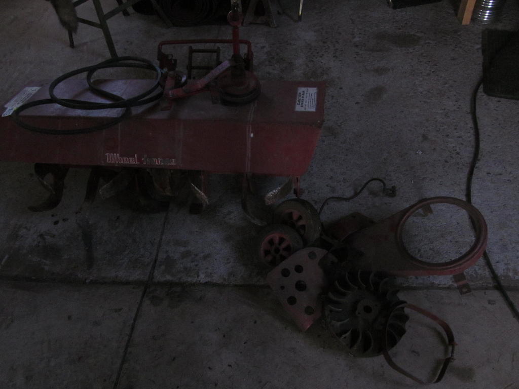

JPWH 6,542 #18 Posted September 21, 2017 I don't know about the tiller but the pulley system will mount on a hydro or manual tractor. I have a belt guard for you if you need it. 1 1 Share this post Link to post Share on other sites
Racinbob 12,807 #19 Posted September 21, 2017 Sorry Ed but no I don't. Here's the manual for it: 'Officially' the L shaped rod ran up through the hole in the slot hitch. I had the rod attached to a piece of 2" bar stock and just slipped it in to the hitch and dropped the pin in. To convert to the one belt system I used the newer style idler setup that mounted in the mid hitch under the engine. Lowell has those but I bought one at the dealer. I'm assuming that I experimented with the belt length or maybe I got lucky. I just don't remember. When I was all done I had a tiller that was a ton easier than either the old style or the newer style to install and it worked great. The down side was that style axle bracket didn't work with a snow blade....at least not the one I had. That wasn't an issue for me because I used the blower on the 76 and the blade on an 84. I sure wish you were closer so we could do this conversion again together. 1 Share this post Link to post Share on other sites

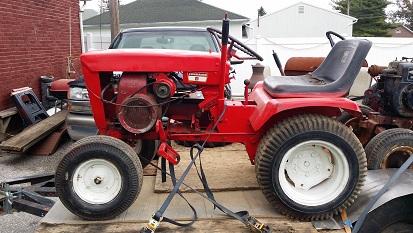

cafoose 3,635 #20 Posted September 24, 2017 (edited) I bought the tiller from @Ed Kennell yesterday! I'm thinking of putting it on my Commando 8. The ag tires are on it now. The first picture is when I first got it. It has a slot hitch on it now. Edited September 24, 2017 by cafoose 1 Share this post Link to post Share on other sites
Ed Kennell 45,027 #21 Posted September 24, 2017 It was good to see you again yesterday Chuck. I hope the Commando has enough Omph to crank that tiller. Share this post Link to post Share on other sites
cafoose 3,635 #22 Posted September 25, 2017 3 hours ago, Ed Kennell said: It was good to see you again yesterday Chuck. I hope the Commando has enough Omph to crank that tiller. Ed it was good seeing you too I really enjoyed seeing some of your horses. If the Commando doesn't have enough omph I may have to get another horse based on what I've learned I think a gear drive is better for it than a hydro. The Commando is my only gear drive other than my round hoods which are smaller and not running yet anyway. 1 Share this post Link to post Share on other sites
