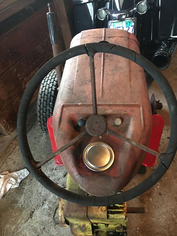

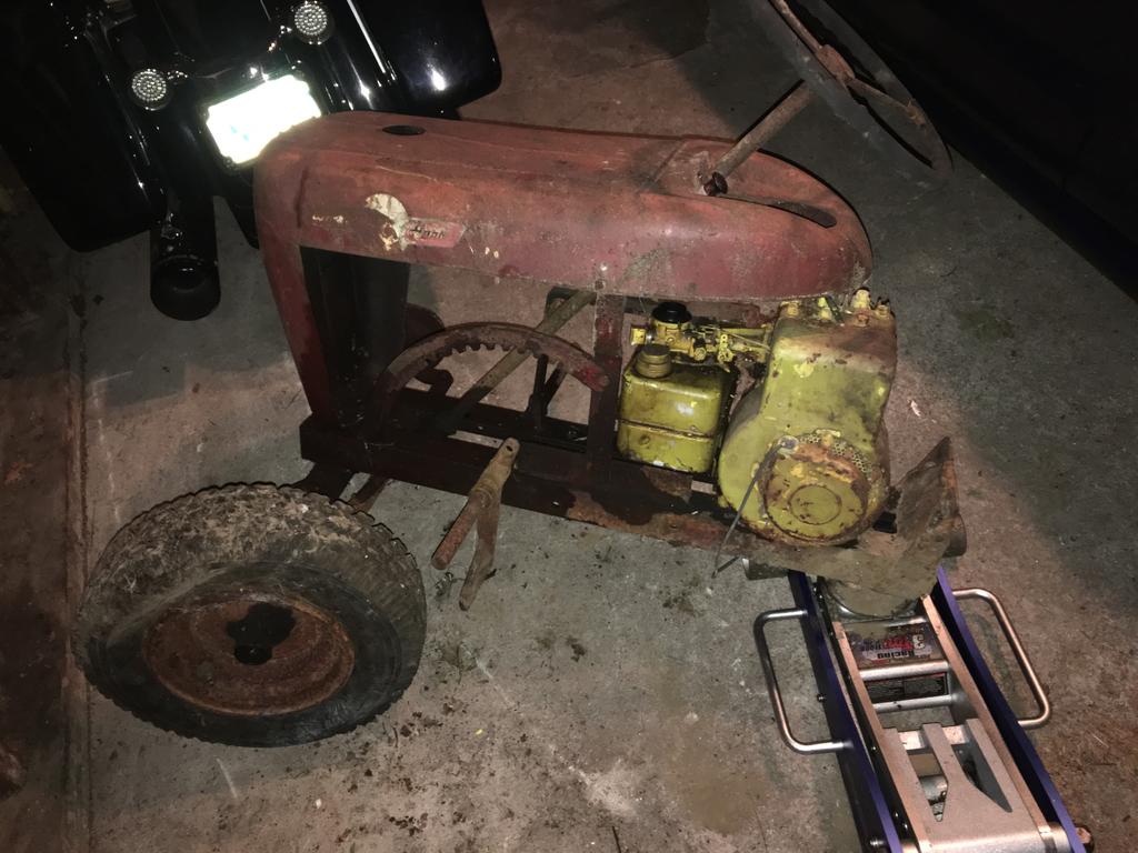

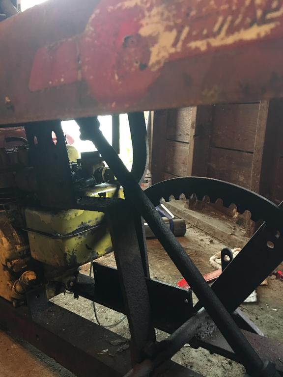

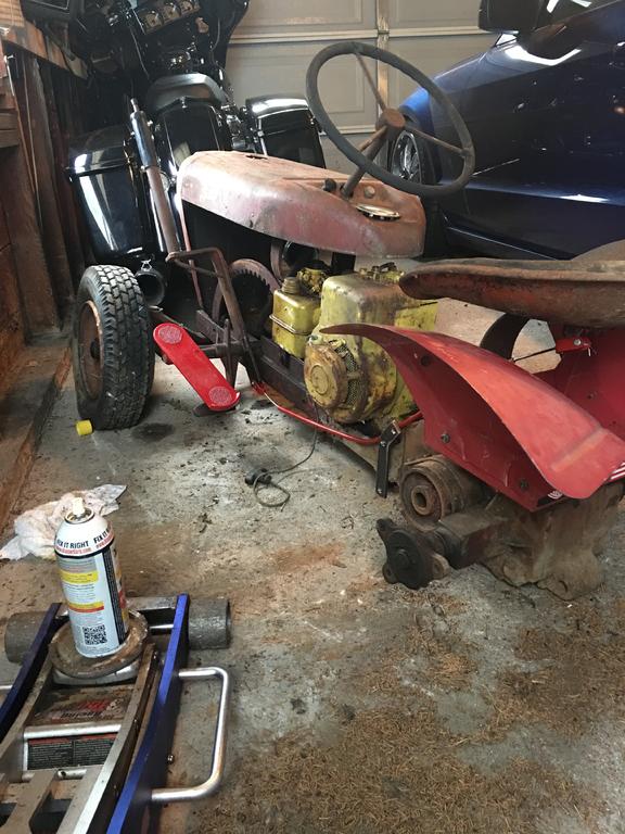

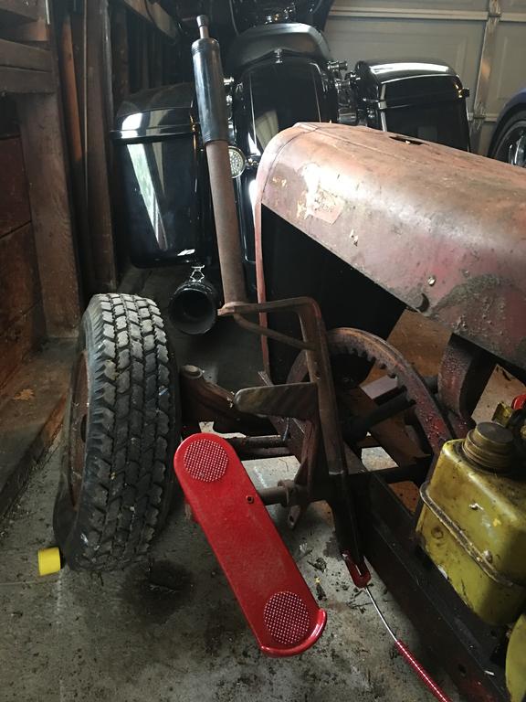

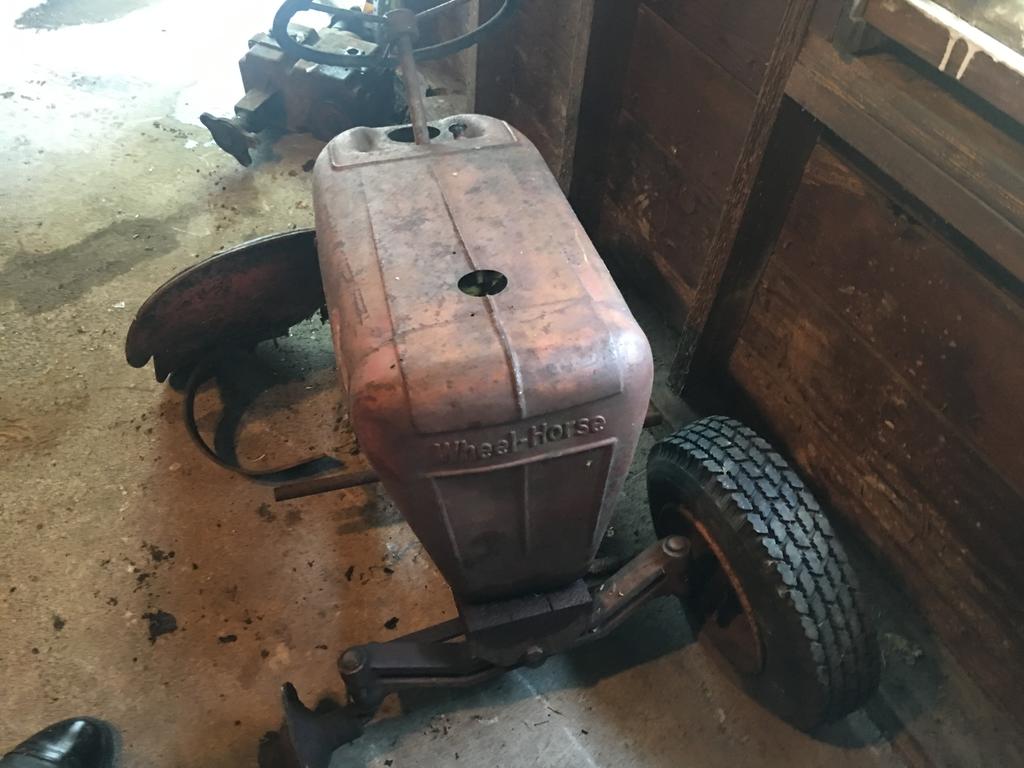

Joeputz 21 #1 Posted September 19, 2017 Hi guys, Im new to the sight and probably asking an annoying question that many before me have as well, but my grandfather left me an old wheel horse as a project to restore. I got told it was a 1961 but I dont know which model. I checked all over for a serial number but I cant seem to find anything. Looking at pictures On google and here on the sight I think its a 1961 401. I have bought parts that corespond with a 401 but I dont know if anything I have is right. I know the motors wrong its off a go kart. I did buy a kohler k91 motor that Im redoing for the tractor it seams like thats the motor everyone uses on any tractor that looks like mine. Some help identifying the model would be great so I have a better idea what im shopping for thanks guys 1 1 Share this post Link to post Share on other sites
520hC-120 136 #2 Posted September 19, 2017 (edited) Definitely looks like a 401 only made in 1961. http://www.tractordata.com/lawn-tractors/000/2/9/293-wheel-horse-401.html Edited September 19, 2017 by 520hC-120 Share this post Link to post Share on other sites

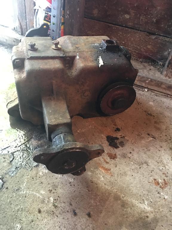

Joeputz 21 #5 Posted September 19, 2017 Thanks guys for the welcomes. Another hopefully quick question does that transmission seem right for my horse. I bought a 3 piece transmission because I thought thats what would be more period correct. If not ill save it for maybe another project. Thanks for the quick replies Share this post Link to post Share on other sites
953 nut 64,158 #6 Posted September 19, 2017 The your grandfather gave you is a 1961 model 551. The 401 would have the model 5010 transmission (ALA a three piece) The transmission you have is a 5007 which was the first of the cast iron two piece transaxle cases. The original engine would have been a 5.5 HP Lauson model H55D. Unless you are obsessed with originality the Kohler K91 will be fine. Hope you will share the project with us. Thanks for all the 6 Share this post Link to post Share on other sites
Joeputz 21 #7 Posted September 19, 2017 Great thank you for the quick response on it being a 551 model. Im glad at least now I know what model number parts to chase down Once I get all the parts together ill try to post a few completed pics. Thanks so much for the help 1 Share this post Link to post Share on other sites
stevasaurus 23,617 #8 Posted September 19, 2017 Richard nailed it...551 and the 2 piece transmission is correct. Welcome to Red Square 1 Share this post Link to post Share on other sites

WHX?? 55,085 #11 Posted September 20, 2017 and thanks for the Looks like you got a real survivor there so have fun with it. Give us a shout if you need help.... the folks here love to help but we do like our pics! Share this post Link to post Share on other sites
Chris G 3,369 #12 Posted September 20, 2017 Very nice suburban ya got and best of luck with the restoration! Share this post Link to post Share on other sites
