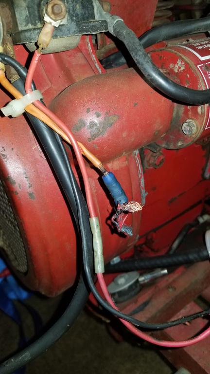

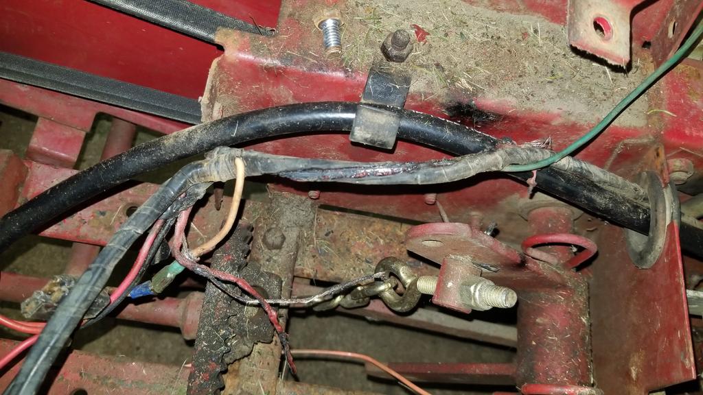

ScottyBones 5 #1 Posted September 18, 2017 On September 17th 2017 at aproxamitly 6:37pm a catastrophic anomaly occurred while trying to start my 69 C-121 Auto after a long day of use. There was alot of smoke and alot of fire. Upon investigation I came to the conclusion that the lens on the ampmeter wich holds it in place broke causing a chain reaction of unfortunate events. The meter fell behind the dash grounding itself to the chassis. At this point the entire ampmeter circuit became glowing red. Moments later the Smokey wires burned through my fuel line causing a fire to erupt from under the dash. Luckily the fire soon outed itself but it wasn't over yet. By the time I ran to the garage for a pair of clippers to cut the battery cable a hot wire melted through the choke cable. The choke cable was grounded to the engine and all 2 feet of it melted the outer plastic coating and was glowing. At 6:57pm the 121 was pushed into the garage for emergency surgery. So now I need to rewire the entire tractor. My only concern is the voltage regulator. The connector on it is melted pretty bad. I can fix the connector but im worried that the regulator is damaged. Is there any way I can check it before I rewire it all? I really don't want this to happen again especially after a full rewire. 6 Share this post Link to post Share on other sites

oldredrider 2,553 #3 Posted September 19, 2017 After a fire, if a part is questionable, replace it. Like you said, you don't want it to happen again. 1 Share this post Link to post Share on other sites

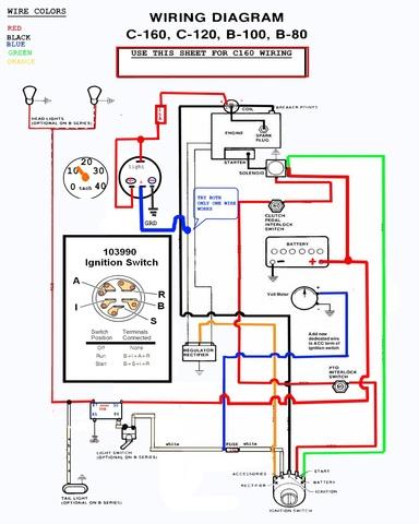

ScottyBones 5 #5 Posted September 19, 2017 Thanks for everyone's help. I was planning on switching to a volt meter as Well. The schematic I'm looking at shows 1 side of the amp meter going to the positive on the battery and the other side going to the solenoid. Should I wire a voltage gauge the same way? Share this post Link to post Share on other sites
rmaynard 16,651 #6 Posted September 19, 2017 All operating voltage normally passes through the ammeter, so if you are removing it, just connect both of those wires (the one from the solenoid/battery and the one from the ignition switch) together. They should be red and light green. Then, if it was mine, I'd take a wire from the accessory terminal on the ignition switch (the same one the lights are connected to) and connect it to the plus side of the volt meter, and connect the negative side to ground. That way, the volt meter will only be drawing voltage when the key is on, keeping the battery from draining when the tractor is off. Also, a good rule of thumb for the models like yours with a cradle-mounted engine is to check the ground wire that connects the cradle to the frame. 4 Share this post Link to post Share on other sites
BOB ELLISON 2,981 #7 Posted September 19, 2017 This diagram is for my c160 after I rewired it. The green wire is where the amp gage was. And the volt gage is tied into the light circuit just as rmaynard said. 3 1 Share this post Link to post Share on other sites

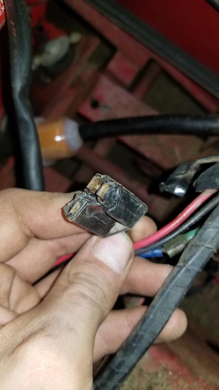

doc724 925 #10 Posted September 19, 2017 You can get aftermarket regulators on ebay for under $30. Three terminal connector bodies do not seem to be available anymore. I just bought 4 terminal bodies 1 Share this post Link to post Share on other sites
BOB ELLISON 2,981 #11 Posted September 19, 2017 I'm with @doc724 replace the regulator. Unless you can test it and be sure it will not damage the battery. I would feel safer to buy a aftermarket. This post will show you what could happen. 1 Share this post Link to post Share on other sites

ScottyBones 5 #13 Posted September 19, 2017 I think I'm going to take everyone advice and replace it with an aftermarket. I found a sparkly one on eBay although I couldn't find any connectors. Does anyone have a link? 1 Share this post Link to post Share on other sites
rmaynard 16,651 #14 Posted September 19, 2017 (edited) Just put three new 1/4" insulated female spade connector on the ends of the wires. The white wires go to the terminals marked AC, and the other goes to DC or B+ Here is a link to a new regulator on Amazon for $32.70 with free shipping. https://www.amazon.com/Regulator-Rectifier-Kohler-Engine-Engines/dp/B004QIE2Q0 Edited September 19, 2017 by rmaynard 1 Share this post Link to post Share on other sites

BOB ELLISON 2,981 #18 Posted September 19, 2017 @rmaynard yes it looks just like that but it's a 3 post for the regulator/ rectifier . Looked just like scottybones . Someone had them for sale and I lost the page. 1 Share this post Link to post Share on other sites

ScottyBones 5 #22 Posted October 20, 2017 Alright I got everything re wired and tractor runs great. Getting 14 volts at battery post at WOT. I removed the amp gauge. One side of it when to the starter solenoid the othere when to ignition Switch. Basically all I did was shorten the wire and istead of going from the ignition switch to the solenoid I ran from switch directly to the positive battery terminal. Is this ok or does it need to be on the solenoid? Either way it's still 12v all the time. Also I'm going to add a fuse to the same wire. What size should I use? I was thinking 20amp as when the amp gauge was working I never seen it get that high. 1 Share this post Link to post Share on other sites
rmaynard 16,651 #23 Posted October 20, 2017 3 hours ago, ScottyBones said: ...I ran from switch directly to the positive battery terminal. Is this ok or does it need to be on the solenoid? Either location is fine. I would use a piece of 14 gauge, stranded wire. 1 Share this post Link to post Share on other sites
