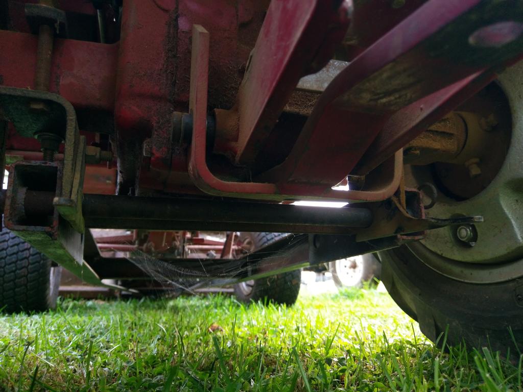

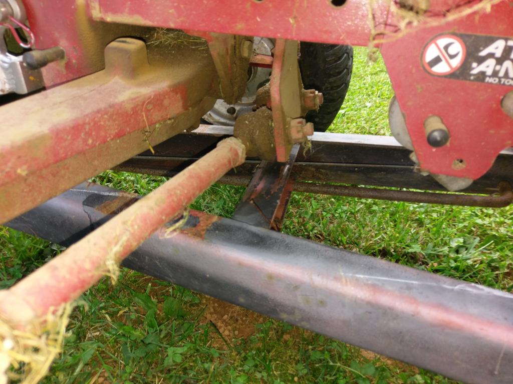

520hC-120 136 #1 Posted September 18, 2017 (edited) I have tried to mount the plow this morning and it looks like this without the bracket and with the bracket the arm is only double that length to the slot, and the pin on arm dosent fit in slot to begin with, never ending problems also included number s to see if you guys would know if it is for a 520H Edited September 18, 2017 by 520hC-120 Share this post Link to post Share on other sites

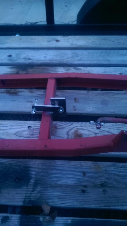

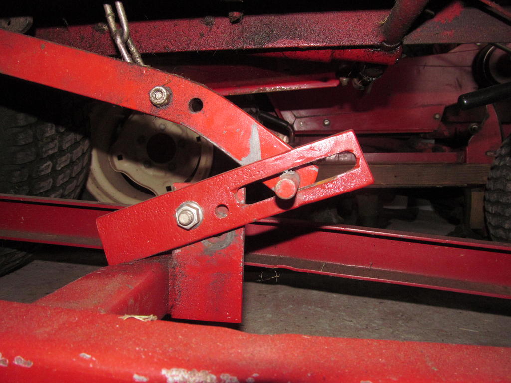

Ed Kennell 42,138 #2 Posted September 18, 2017 (edited) You can not use the deck lift arm in a vertical slot. The pin in the arm moves forward as the arm is raised. Why did you start another post ? The info you need is in your other post. I did make a bar with a horizontal slot so I could use the deck lift arm to lift the plow frame. If you want to go that route instead of the factory method, I can get a picture. Edited September 18, 2017 by Ed Kennell Share this post Link to post Share on other sites
520hC-120 136 #3 Posted September 18, 2017 (edited) So I can leave it as is and just connect the chain/ solid lift bar straight to the plow?Can I please see that picture as well, I might do that Edited September 18, 2017 by 520hC-120 Share this post Link to post Share on other sites

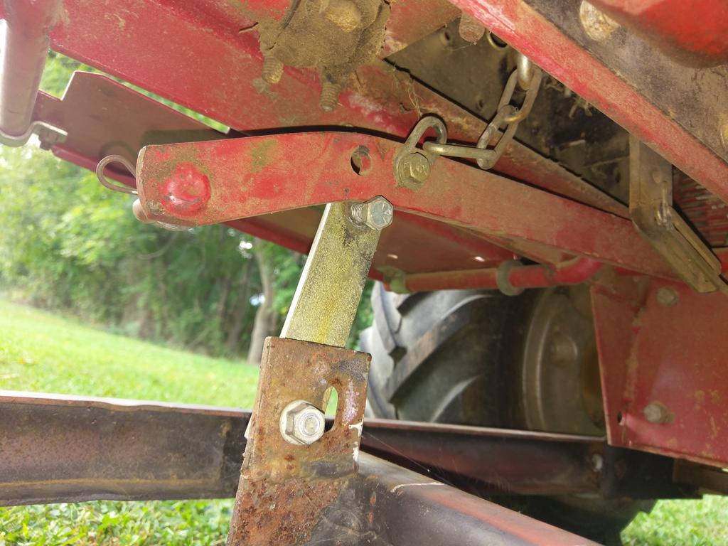

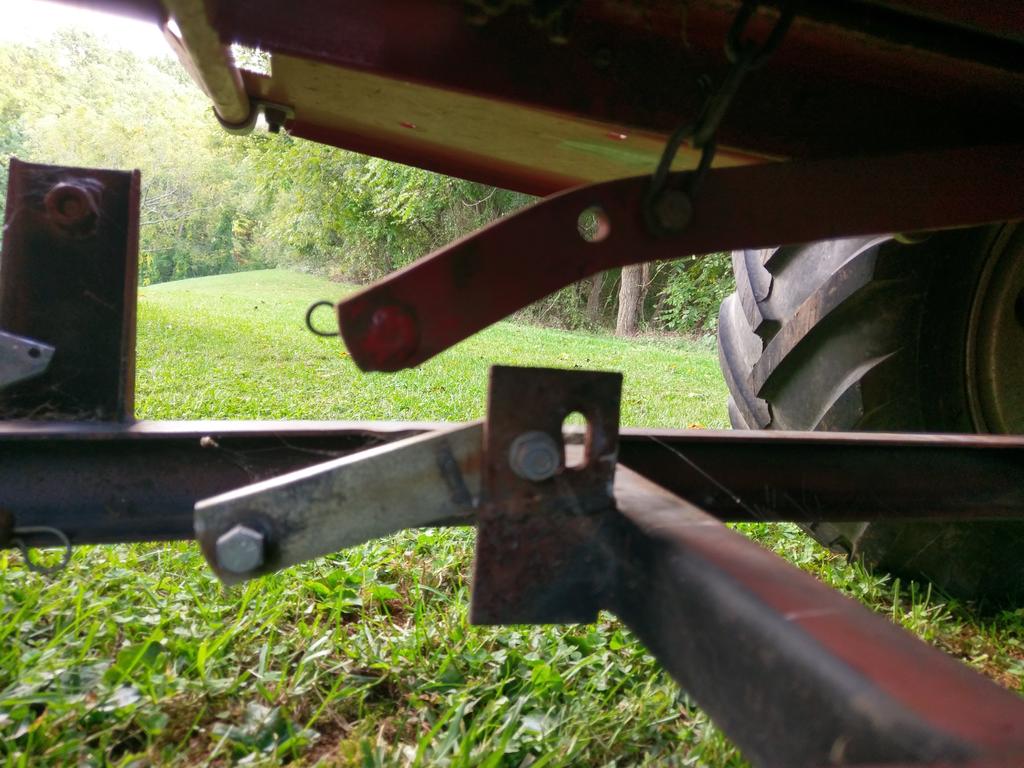

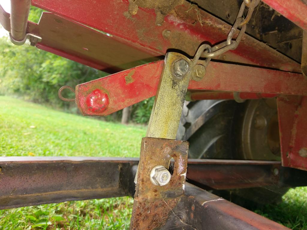

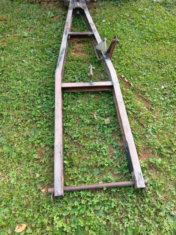

WVHillbilly520H 10,376 #4 Posted September 18, 2017 Let's see if I can clear up the mud here, if you have an '88 520 with the straight axle you won't need the extension part that is slid in the frame and bolts to the welded in cross member...it needs to look like what I'm showing in my pics below then the lift link is pinned or bolted on to the mower lift arm in hole not used by the rockshaft chain it doesn't have to be removed and it doesn't have to go to the rockshaft unless you get the long link for "down pressure, also the rear extension can also be removed give a little bit and I'll get you some pics with the blade attached, Jeff. 11 minutes ago, 520hC-120 said: I have tried to mount the plow this morning and it looks like this without the bracket and with the bracket the arm is only double that length to the slot, and the pin on arm dosent fit in slot to begin with, never ending problems also included number s to see if you guys would know if it is for a 520H 3 Share this post Link to post Share on other sites
WVHillbilly520H 10,376 #5 Posted September 18, 2017 I just went out and hitched up the front snow plow...doing it this way the blade "floats" but if you want the down pressure you will need to tie up or remove the mower lift bar... also you see where the front cross member on the plow frame hits my steering linkage on my swept forward axle 520, another for the extension kit, Jeff. @Ed Kennell, do you think my last post cleared up the mud? 20 minutes to get the blade under the tractor and hitched up minus the angle lever ain't too bad is it? Jeff. 6 Share this post Link to post Share on other sites
Ed Kennell 42,138 #6 Posted September 18, 2017 Here is the pic of the slotted bar I made so I could use the deck lift arm. It works fine and makes changing from deck to plow a little easier, but with the chain connection, I do not have down pressure. 12 minutes ago, WVHillbilly520H said: @Ed Kennell, do you think my last post cleared up the mud? 20 minutes to get the blade under the tractor and hitched up minus the angle lever ain't too bad is it? Jeff. Clear as 180 proof lightening Jeff. 3 1 Share this post Link to post Share on other sites
