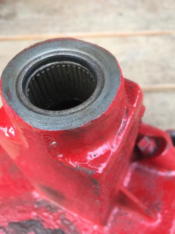

crazyhorse1056 109 #1 Posted September 17, 2017 I'm replacing the axle seal and bearings in my 3 speed unidrive and need to know if the old seals and bearings were originally one piece because the book shows #1232 seal and #1528 needle bearing the ones I removed were one piece the brake shaft is the same way Share this post Link to post Share on other sites

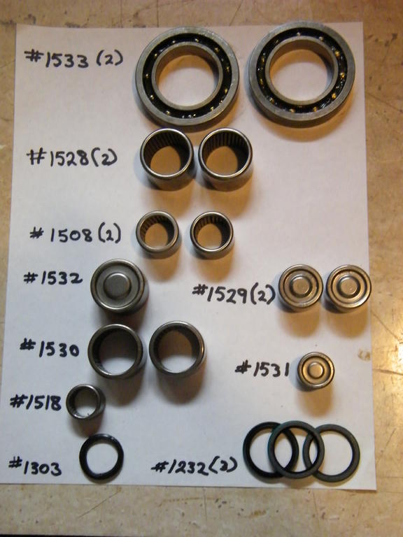

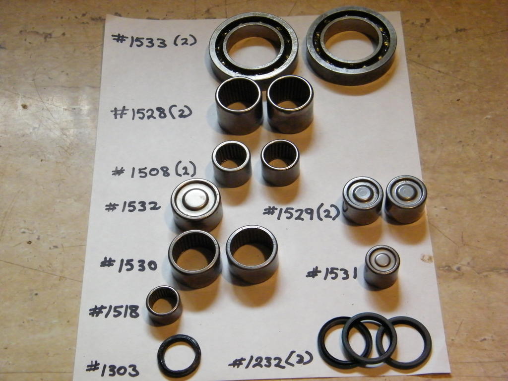

stevasaurus 23,861 #2 Posted September 17, 2017 I would sure like to see a picture of what you think are a one piece bearing and seal. I know of no 1 piece bearing and seal for any wheel horse transmission. I can give you a list of all the bearings and seals that is takes to replace in a #5053 transmission. 2 Share this post Link to post Share on other sites
crazyhorse1056 109 #3 Posted September 17, 2017 Will upload pictures for you If I could see a picture of the 1232 seal it would help or had the dimensions of it 2 Share this post Link to post Share on other sites

Racinbob 13,250 #5 Posted September 18, 2017 That may look like it's just one piece but it's two. The seal can be easily picked out with a small screwdriver and the new one installed. As long as there's no axle slop no further disassembly required. 2 Share this post Link to post Share on other sites
stevasaurus 23,861 #6 Posted September 18, 2017 Here ya go. That seal is only about 1/8" thick. 4 1 Share this post Link to post Share on other sites
