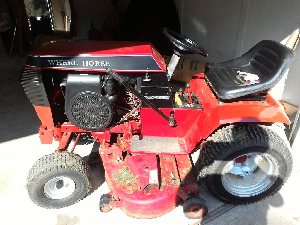

Vintner 17 #7 Posted September 17, 2017 (edited) Thanks for the welcomes! What exactly do you want a pic of? Yes it's an 8 speed. Sorry I forgot to include that in my 1st post, though IDK what hydro means. Edited September 17, 2017 by Vintner 2 1 Share this post Link to post Share on other sites

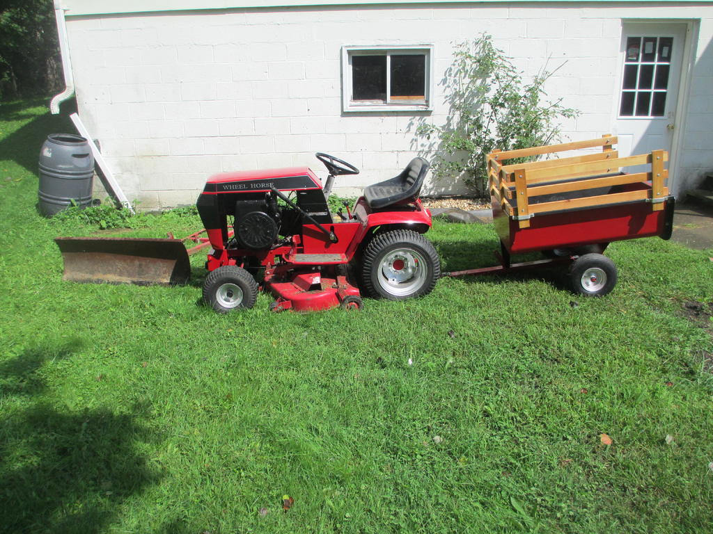

elcamino/wheelhorse 9,363 #8 Posted September 17, 2017 If that is a picture of your tractor , it is a 310-8 with I think a 42 inch rear discharge deck. Hydro means an automatic transmission. Look on the motor and see if there is a tag with a serial number . That may help with identifying the year . Hope this helps. 2 Share this post Link to post Share on other sites
BOB ELLISON 2,983 #9 Posted September 17, 2017 1985-1993 the 310-8 was made so yours will be one of those years. Close ups of the dash and sides of tractor may help get closer to the exact year 2 Share this post Link to post Share on other sites

520hC-120 136 #12 Posted September 17, 2017 Definitely a 310-8, looks like a nice tractor Share this post Link to post Share on other sites

tunahead72 2,660 #15 Posted September 18, 2017 Yours does look like a 1986 310-8, although the decal on the hood isn't original. If you can find a model number on it, it will be 21-10K802 or 21-10K803. You'll find some photos here: I'm curious about the sticker and plate you mentioned, can you get close-up photos? I don't know if I've ever noticed them in those locations on mine. The original tractor sticker would have been near the seat, I forget where exactly, but I can look at my manual later. Do you see a sticker on the mower deck? Aaron Rodgers is a very successful highly paid NFL quarterback who used to date Olivia Munn, he doesn't need my help. 1 Share this post Link to post Share on other sites
gwest_ca-(File Mod) 12,478 #16 Posted September 18, 2017 An engine manufactured in 1986 could have landed on a 1986 or 1987 model tractor. 1986 was the first year for the low oil switch in the rear of the oil pan. The K-Series engines were used in 1986 10hp and larger. Tractor model 21-10K802 or 03. 02 likely made by Wheel Horse and 03 made by Toro. 1986 was the year company ownership changed. 1987 was the first year for the M-Series of engines 10hp and larger. Tractor model 21-10K804. Corrected the tractor model numbers Garry 3 Share this post Link to post Share on other sites

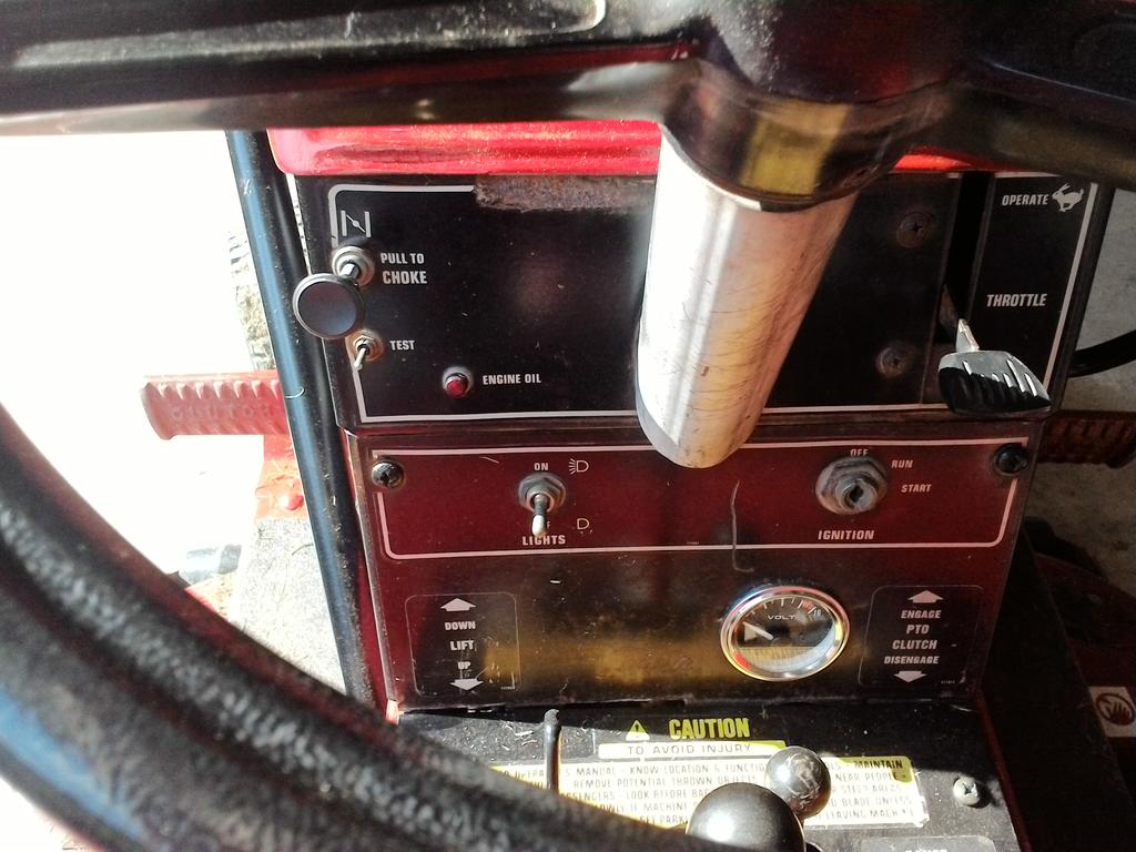

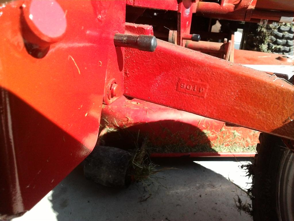

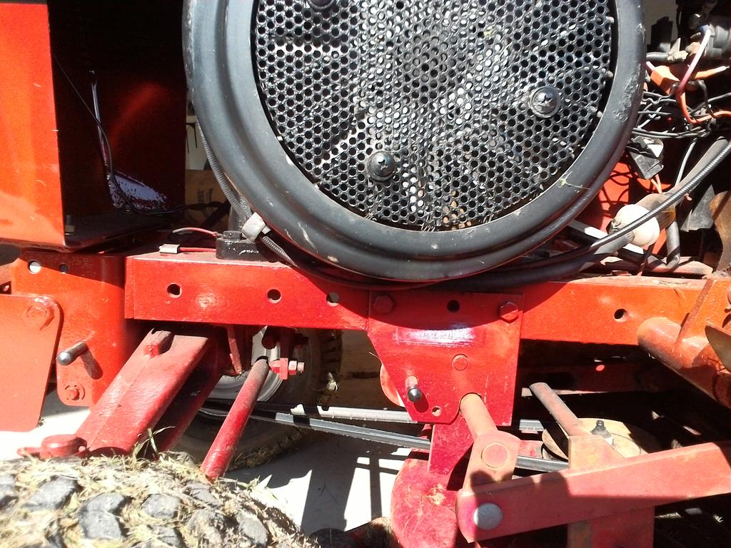

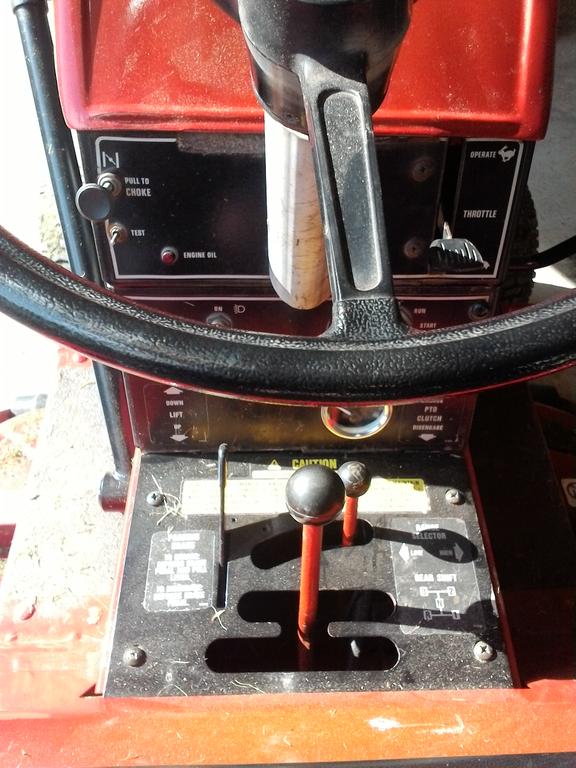

Vintner 17 #17 Posted September 18, 2017 (edited) Better dash pix. You notice there is no engine hours meter. & IDK what the little toggle labeled "test" under the choke is for. The 4th pic is the little tag I mentioned earlier on the arm that goes out to the left front tire. Now that I'm seeing it in daylight, I think it's upside down & actually reads "4706"? The last pic is the label that was painted over on the frame of the mower under the fly wheel of the engine. There is a label for model & serial # on the deck. There is nothing resembling a label anywhere near or around the seat. Edited September 18, 2017 by Vintner 1 Share this post Link to post Share on other sites
gwest_ca-(File Mod) 12,478 #18 Posted September 18, 2017 See an ignition coil on the back side of the blower housing making the engine a K241. Tractor model 21-10K802 or 21-10K803 02 likely made by Wheel Horse 03 likely made by Toro 1986 was the year company ownership changed. Corrected the model numbers This is the revised operator manual for 1986 with the correct engine oil capacities. Click on the pictures below. Not the best parts list but all we have Garry 1 Share this post Link to post Share on other sites
tunahead72 2,660 #19 Posted September 18, 2017 The hour meter was an option on the 310-8. The "test" switch is used to test the low oil indicator light, which is the red "engine oil" light to the right and just below the switch. As long as the battery is connected, the light should come on when you toggle the switch up. It's spring loaded, so it should return back down by itself. The label under the engine is I believe for the mid-mount hitch. Does it look like it reads "Tach-a-matic"? I don't know what to think of the tag on the front axle (the "arm" that you referred to). I don't see one on my 310-8, maybe it's a manufacturing date stamp or something. The tractor ID plate would be located at the front of the rear fender, just below the seat, directly behind the gear shift lever. Share this post Link to post Share on other sites
Vintner 17 #20 Posted September 21, 2017 Thanks for that info TunaHead. The label on the frame under the engine is smeared beyond recognition from trying to get the paint off. I've been over this machine with a fine tooth comb. There is nothing else on it resembling a model * serial # label or plate except for the one on the mower deck. Share this post Link to post Share on other sites
