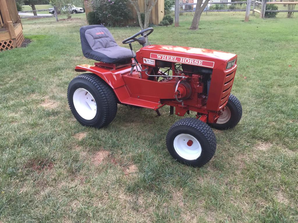

rmaynard 17,436 #6 Posted September 15, 2017 I purchased 5 of the HVLP sprayers a few years ago for about $7.99 each. The results were better than average. Here is a picture of my 416-H painted with one. Consider the following; 1. I don't have a paint room, so I paint outdoors. 2. Because I paint outdoors, for things like the fenders and hood, I need to sand and polish when it's dry to get the bugs and dust out. 3. In order to clean the sprayer, I buy a gallon of lacquer thinner for about $15.00. For a complete tractor, I probably use every bit of a gallon. So the question for me is do I use $15.00 worth of lacquer thinner to clean up the $7.99 sprayer, or do I just throw it away at the end of the job and break out a new one for the next job? For me, as a non-professional painter, it's a no-brainer. Go with the gravityt feed HVLP. 7 1 Share this post Link to post Share on other sites
