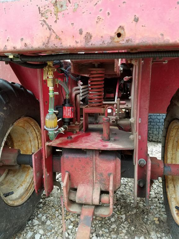

giantsean 62 #7 Posted September 12, 2017 Thanks gents. I'll try cleaning it up a bit and see what else I can find. The only real difference has been adding the electric fuel pump (Facet cube model 40163, rated at 1.5-2.5 psi max). I did also install a K&N screw in filter on the pump inlet, it filters to 40 microns. Even given my limited experience w/ carbs I don't believe restriction could cause a lean condition in and of itself, but again that was the "upgrade" Or if the pump is causing the engine to flood instead maybe a replacement carb or Sarge's bypass trick is the way to go. How about the smokeshow though... could it have been unspent fuel dumped in from the period where it cranked excessively? Share this post Link to post Share on other sites

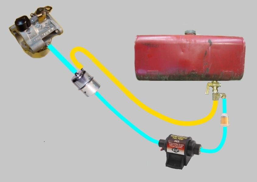

Sarge 3,473 #18 Posted September 18, 2017 No thread , haven't had time yet . It's just a fuel filter for a Jeep CJ (try a 1980 model) with a bypass line ran back to the tank valve and a tee fitting to plumb it into the fuel line before your electric pump . This bleeds off excess pressure and keeps the electric pump cooled . Here is what the filter looks like - The short line goes to the carb , longer one is routed all the way back to the tank fittings . At the tank , there is a shut off valve , tee and filter before the pump . That return line goes back to the tee fitting to allow the fuel to circulate and remove any spikes in pressure . . Sarge Share this post Link to post Share on other sites

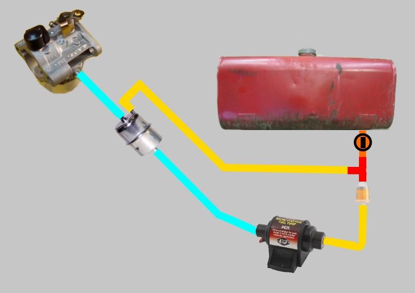

giantsean 62 #19 Posted September 19, 2017 (edited) So if I'm reading/seeing it right, we're talking something like this? (don't worry... I photoshop really fast :P) Edited September 19, 2017 by giantsean 1 Share this post Link to post Share on other sites
Sarge 3,473 #20 Posted September 20, 2017 Close - I routed the return side to the bottom of the tee to allow air to escape back up into the tank . Over time the amount of bubbles you'll see will diminish . It would work better if there was a second port on the tank , but due to the way it's built and mounted there really is no good place to put it without welding in a new bung . Great job at photoshop - I never did get time to work much with that program . Sarge 1 Share this post Link to post Share on other sites
giantsean 62 #21 Posted September 21, 2017 Thanks Sarge. Yeah your 2nd photo is a little rough as at that angle you can't well see where the lines go... it almost looks like the line makes a complete circuit through the pump and back into the tee. So the small filter is a pre-filter on the pump intake correct? Then pump sends it to the CJ filter, which sends it 1) to carb and 2) back to the tee under the shutoff? If so how do you keep air from getting sucked back down through the pump, if there is any? Or is there so little that it's not a big deal? Share this post Link to post Share on other sites
Sarge 3,473 #22 Posted September 21, 2017 Since there is no true return that is separate there are air bubbles that will circulate through the system - they don't hurt anything and over time will go down to nearly nothing . Every time you shut it off , any bubbles right at the end of the return line will rise back into the tank - listen closely and you'll hear them when you shut it off . Some air will escape into the float bowl through the filter and vent to the atmosphere out of the bowl vent . Again , no big deal and using the semi-clear fuel line makes it easy to see if the pump is working due to the moving bubbles . My grandson thinks it's pretty cool , lol... Yes , that routing is correct - I can try to get a better pic tomorrow along with some labels maybe...if I can figure that out on this thing , lol . The small filter keeps debris out of the electric pump - they use flapper valves internally that can plug up easily so it has to have an inlet filter ahead of the pump . The CJ filter is just a secondary and used as a pressure bleeder that allows the excess flow back to the tee fitting . Run one of those pumps without this return setup and they can get quite hot unless they are flowing a lot of fuel (as in wide open engine demands) . This runs the pump dead cool but will not starve the engine , we've tested this up to 200hp 4cyl modified engines with multiple carbs at scary rpm's - remember , this filter originally fed a 258cu/in straight six . Sarge 1 Share this post Link to post Share on other sites
giantsean 62 #23 Posted September 22, 2017 Cool no worries. Yeah I actually didn't think air was too big a deal but since you called it out I got worried lol. No rush but if you want to take some more detailed pics at some point, I am happy to label them and update the diagram as well (that red thing in my pic is supposed to be the tee which is hopefully in the right place - yellow is the return obviously - but I can make a nicer shutoff and tee) Then we will have a good reference for anyone wanting to try it out (like this guy... provided I haven't destroyed it ) Share this post Link to post Share on other sites

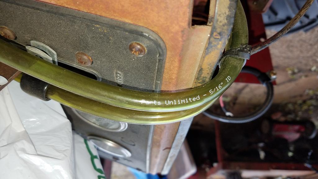

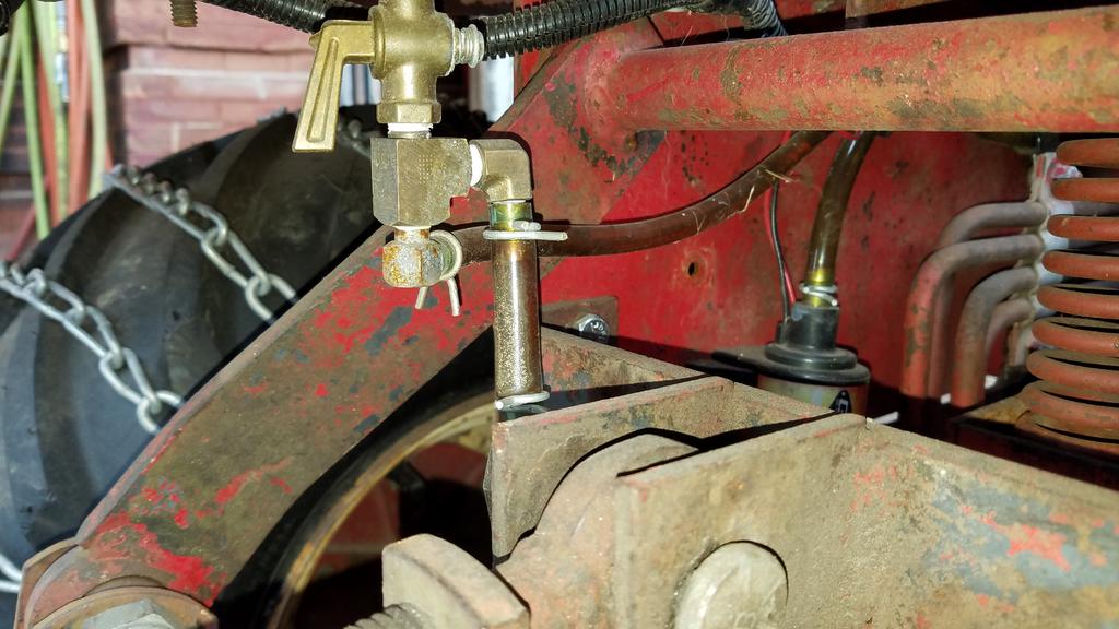

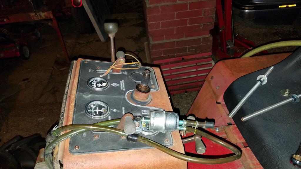

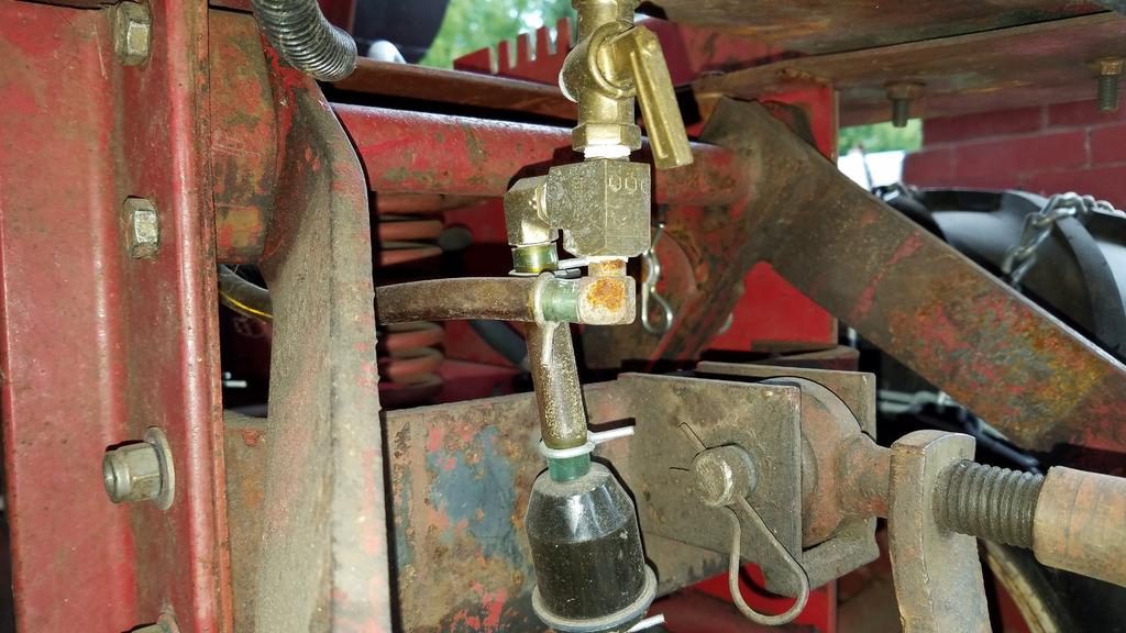

Sarge 3,473 #24 Posted September 22, 2017 Here's the pics I took yesterday - sorry it took so long as I'm fighting the front half of this thing at the moment . I use the Parts Unlimited rolls of fuel line in 1/4" & 5/16" for the tractors and other stuff - the Jeep CJ fuel filter uses 5/16" size line for the feed/carb ports , 1/4" for the return - Here's a couple shots of the shut off valve and tee setup - the return is plumbed into the bottom In the first photo - you can see the fuel filter ahead of the pump inlet - second photo you'll notice the top of the pump and it's wiring near the rear hydraulic manifold and lines . I did it this way to stay clear of the 3pt arms and linkage . Works quite well and as I said before - the pump stays cooler . If you need anything else , just holler . Sarge Share this post Link to post Share on other sites
giantsean 62 #25 Posted September 23, 2017 (edited) Fixed that for ya I was going to label the others but I lost the updated diagram when I saved the old one over it, causing me to do this twice (though the 2nd looks much nicer lol) and sapping my will to continue. If you think it will be a popular mod is it worth it's own thread? Or maybe if there is a document repository on the site other than manuals? Edited September 23, 2017 by giantsean Share this post Link to post Share on other sites
