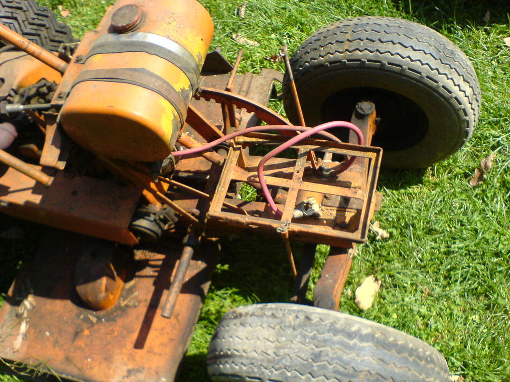

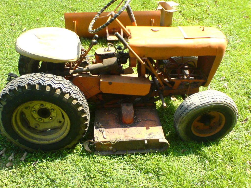

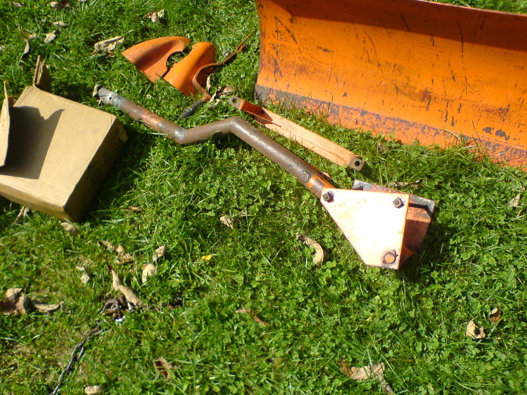

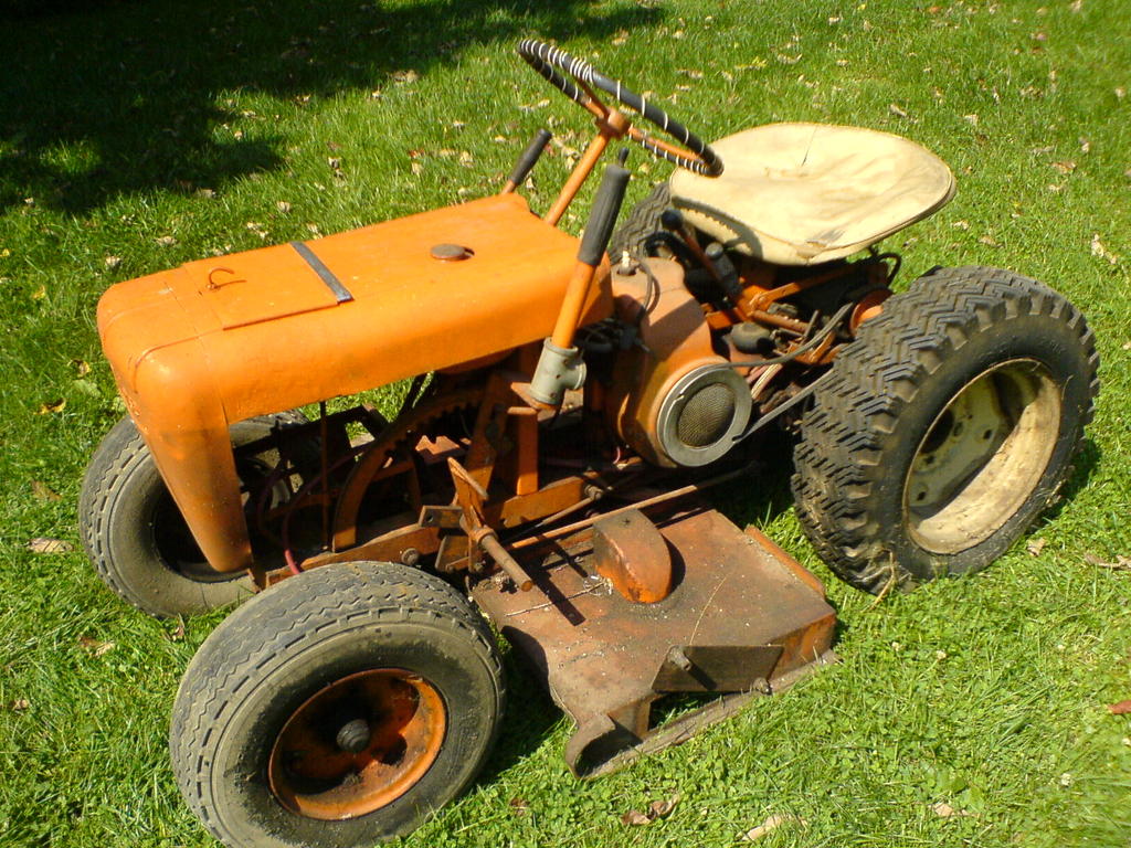

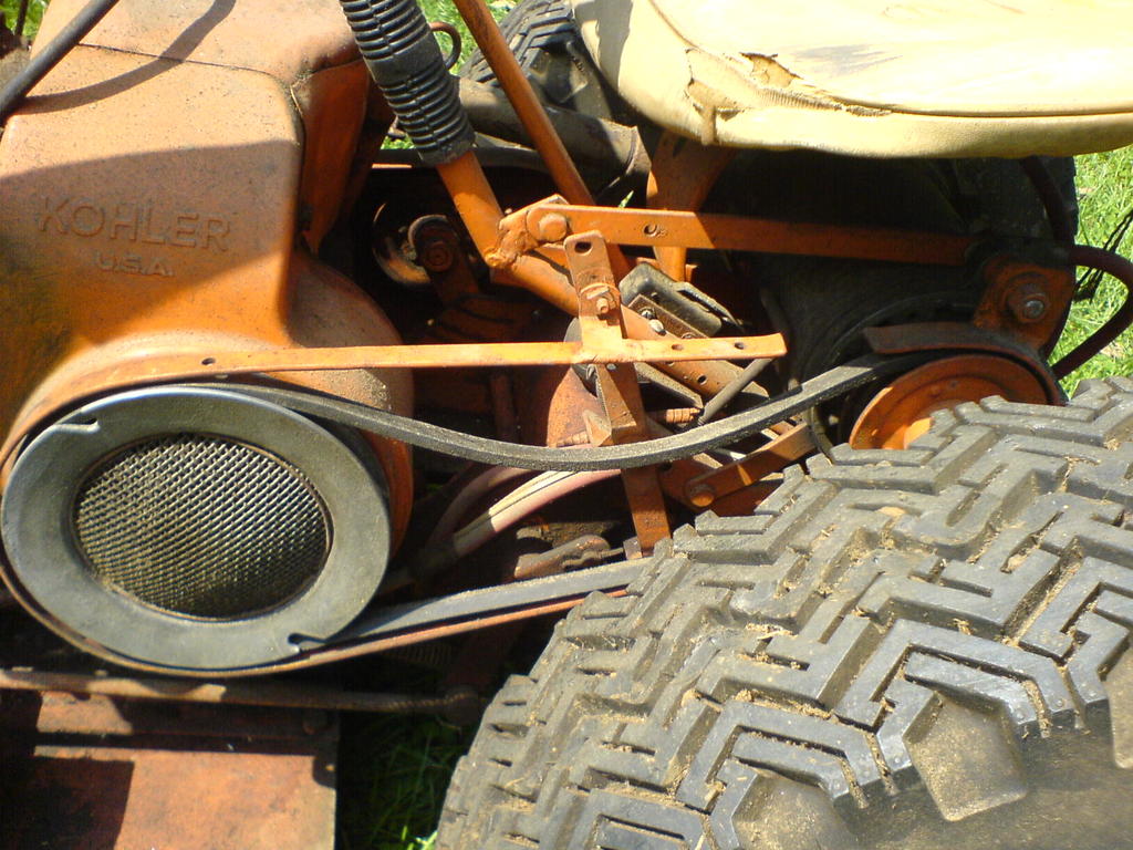

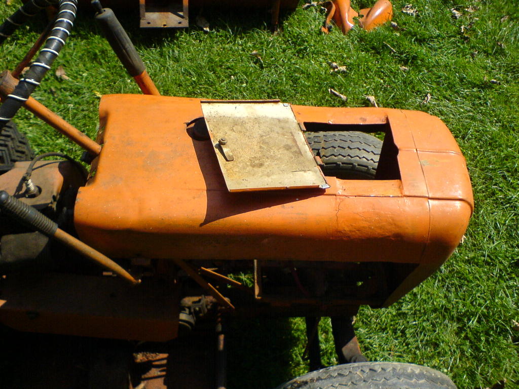

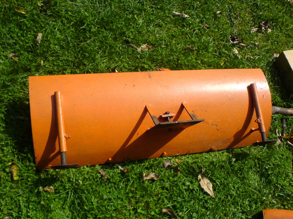

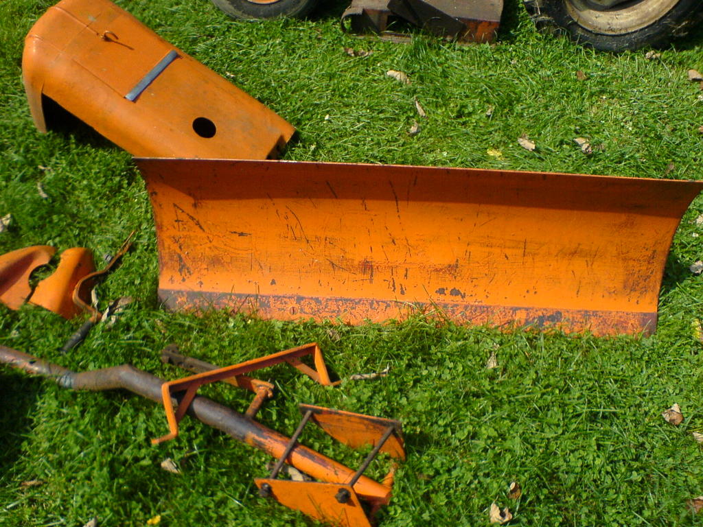

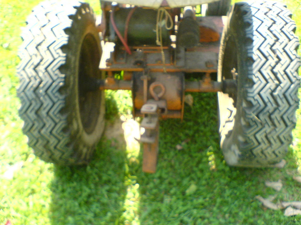

the sommoner 13 #1 Posted September 10, 2017 (edited) This wants to be a Allis Chalmers tractor, but why? Looks like a Wheel Horse RJ58 painted orange, I scraped the paint and there is no red under it. Maybe he blasted it off, but he used a brush to repaint it. It has some p.o. mods, I know these did not come with electric starters. Not sure if it is a 6 or 12 volt starter, as I see no label on it. You pull up on the short handle to tighten the belt then it hits a switch to engage the starter. There is no charging system. Looks like a home made blade also. It turns over by hand, gas tank is clean, so it should take much to get the ol' Kohler running. Pictures for your pleasure. Edited September 10, 2017 by the sommoner 3 Share this post Link to post Share on other sites

Chris G 3,369 #3 Posted September 10, 2017 (edited) I'd say it's a suburban that has suffered some crazy mods and altering of sorts. With some mix and match parts also. Edited September 10, 2017 by Chris G 2 Share this post Link to post Share on other sites
953 nut 64,160 #4 Posted September 10, 2017 Poor little Suburban; anyone doing this should be locked up and the keys thrown away! 8 Share this post Link to post Share on other sites

953 nut 64,160 #10 Posted September 11, 2017 3 minutes ago, WHX12 said: Lets not be too hard on the PO The color is no big deal, the starter is sorta kool, cutting the hood off to be able to service the engine is all too common, but that trap door in the hood is a crime! Share this post Link to post Share on other sites

Molon_Labe 731 #13 Posted September 13, 2017 Gotta give the PO credit, he did everything possible to make it into something it wasn't. The starter setup is pretty ingenious though! Share this post Link to post Share on other sites

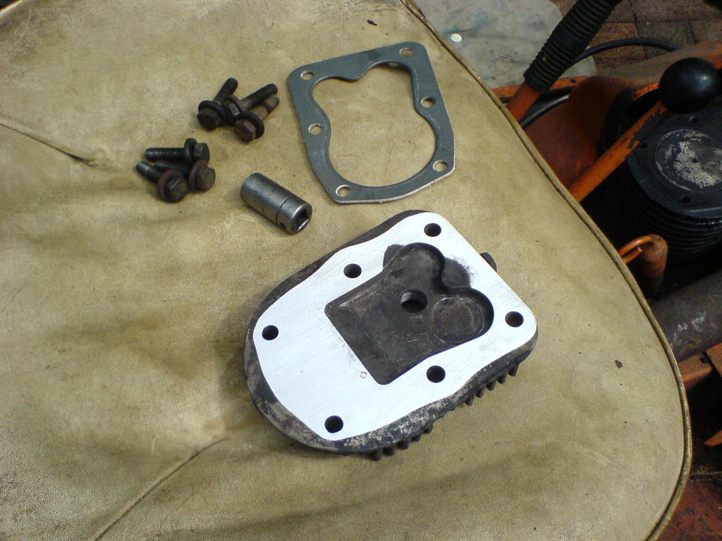

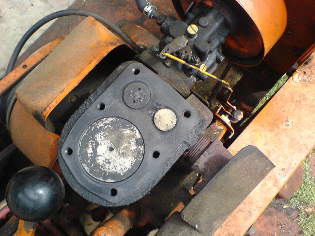

the sommoner 13 #16 Posted September 14, 2017 17 hours ago, WHX12 said: Just remember what comes around goes around! I know. When I picked this up there was a stack of manuals I got also and found the original brochure and parts manual. It is a 401. So yesterday I noticed the head gasket was blown, so I planed the head, new gasket, re torqued after a few heat to cold cycles and now the engine runs a lot better, the governor issue went away. Pics cause it did happen. 3 Share this post Link to post Share on other sites
pacer 3,179 #17 Posted September 14, 2017 I like it!! That rube gold berg starter is the bomb!! 1 Share this post Link to post Share on other sites
