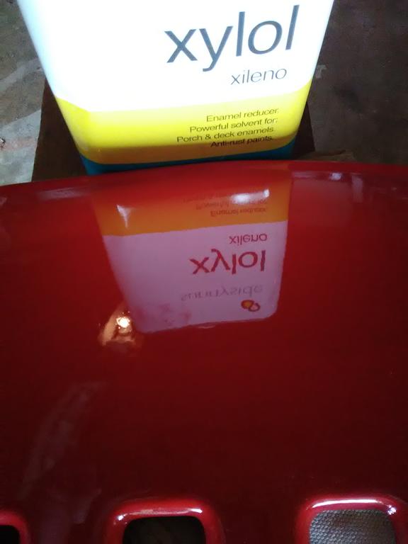

"Manic-Mechanic" 1,486 #23 Posted September 9, 2017 A picture would speak volumes! Neighbors think your working with bio-hazards! I have a new suit still in the package, if I can find it , that is! Really need to stop exposing myself to these chemicals.......I mixed three enamels on this hood, ending in clear, and I'm done. Before I go overboard and get crinkles! Share this post Link to post Share on other sites
