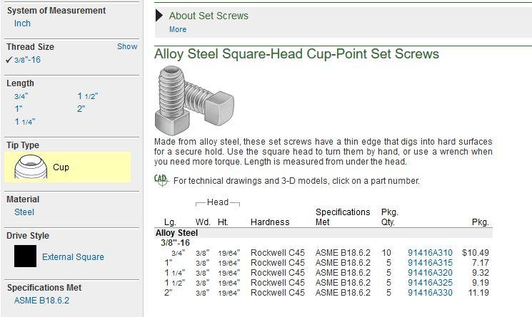

stevasaurus 23,861 #6 Posted September 3, 2017 If they are not, they are either worn of the wrong ones. It's the ridge that catches and does the holding. I know we have some pictures here on the site, but I am not so good at searching. 1 Share this post Link to post Share on other sites

ebinmaine 81,046 #10 Posted September 3, 2017 31 minutes ago, pfrederi said: That's the style I have right there... Square head and also a locking nut on the threads. 1 Share this post Link to post Share on other sites
doc724 927 #11 Posted September 3, 2017 Buy new set screws (with the square head). They are about $1 each for high quality ones. Do not reuse the old ones. Do not forget to put never seize on the key and keyway too 3 Share this post Link to post Share on other sites
