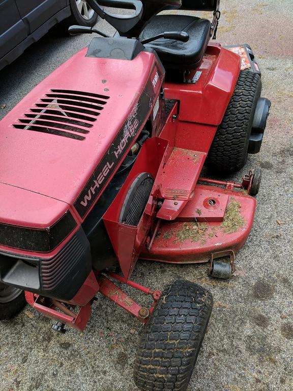

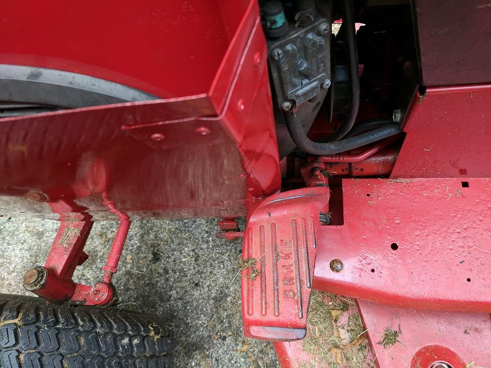

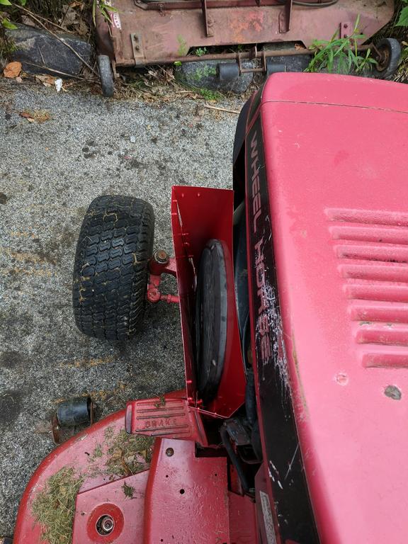

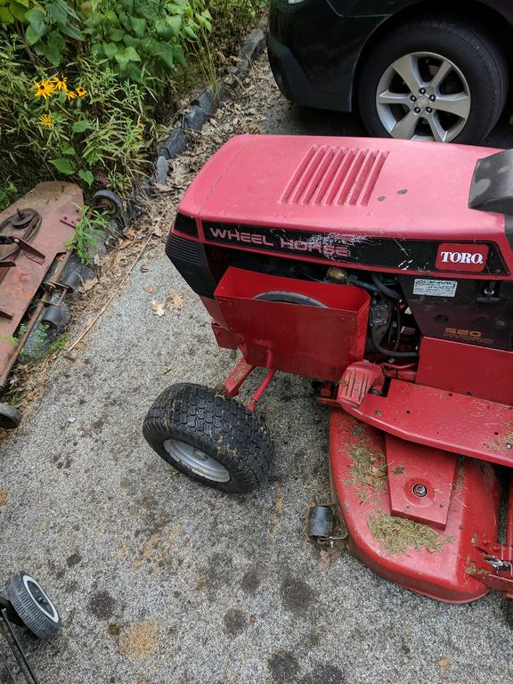

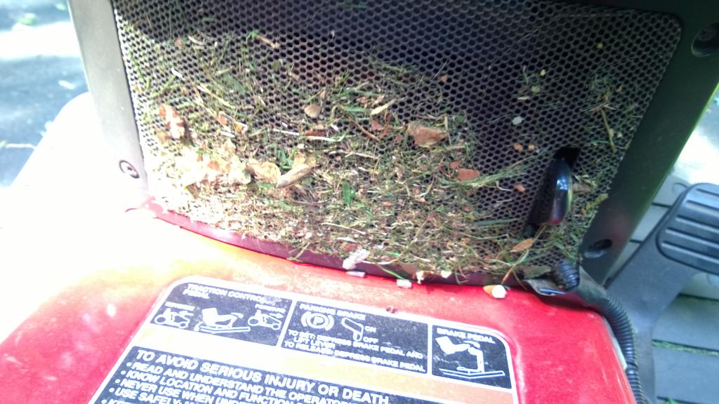

toddr 19 #1 Posted September 2, 2017 (edited) I was frustrated enough at constantly needing to remember to clean the blower screen on my 520H that I decided to fabricate a fix. It's not pretty, but so far it seems to work. I used 22g galvanized riveted together. I thought it was important to use the original screen and hardware to attach the shield as I didn't want to risk any hardware getting into the spinning blower. The hardest part was getting the side of the shield to clear the brake when depressed. The airflow seems good from the top and I haven't seen any overheating, but time and weather conditions might affect that. If I do have issues with air I can easily open up the top. Edited September 2, 2017 by toddr 4 Share this post Link to post Share on other sites
ericj 1,580 #2 Posted September 2, 2017 Looks good but, I have concerns that it would allow enough air flow in, especially at the bottom of the flywheel. Instead of pulling air straight in on the flywheel, you now have to pull have to pull it all in from what a 6"x18" hole at the top. You did real good from the looks of it forming it around the shroud. From the looks of it you have to drill out the rivets in order to remove it. If you were to shorten up the length enough to clear the pedal you could open up the top more to allow in more air ? Could you use hinges on the bottom and some kind of buckle or clasp that would allow you to gain access to the mounting screws easier ? with pulling air in from above will it allow even and proper air flow over the entire motor with out creating hot spots ? in another words does to much turbulence in air flow through motor. i like your idea though, it is a PIA when mowing with a lot of dead grass laying or when doing leaves. somebody on here used a 10" or 12" smoke pipe type ell and angled it up to stop the leaves and grass from getting sucked up on the screen. it takes me usually less then an hour to mow my yard so I just try and remember to brush it off eric j 2 Share this post Link to post Share on other sites

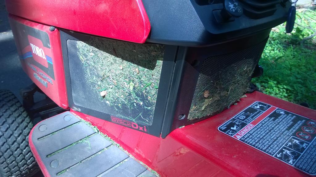

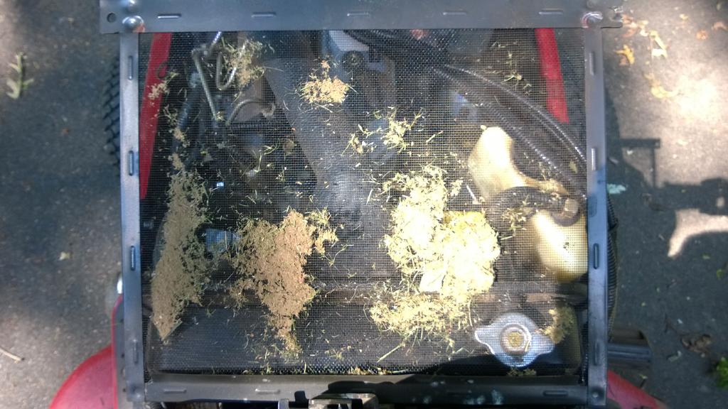

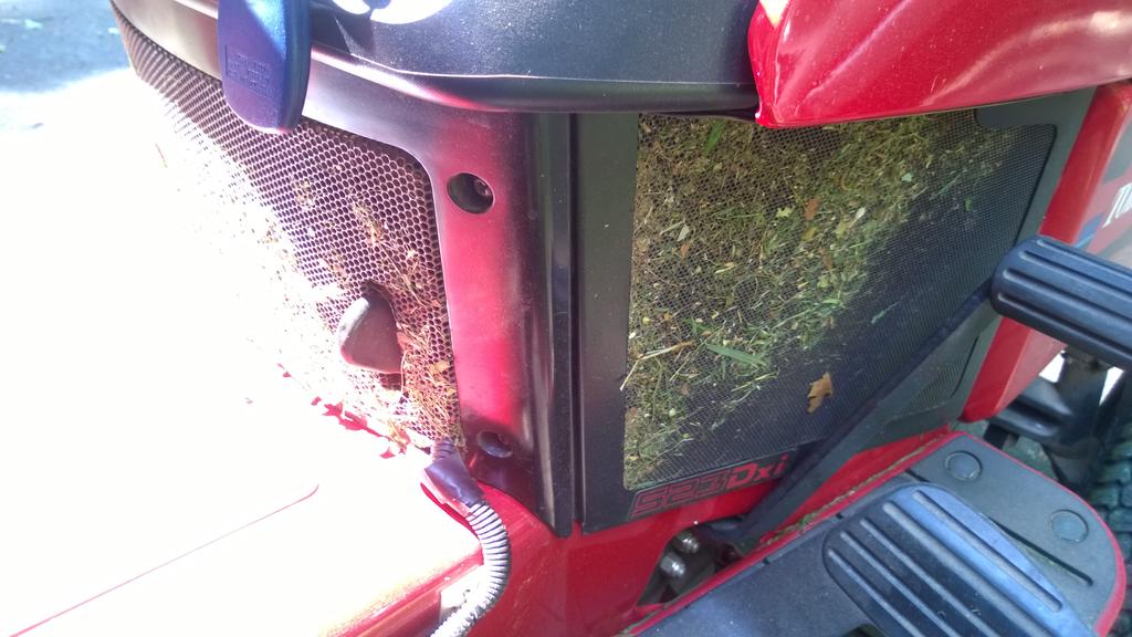

shallowwatersailor 3,222 #10 Posted September 4, 2017 (edited) The bulletin that Marv provided is probably the best solution. My 523Dxi pulls a lot of grass on to the three screens due to the high airflow (more than a 520-H requires) of the radiator fan. There is also an additional removable screen directly in front of the radiator itself that stops the fine dust. The last photo shows the screen removed from its bracket on the radiator. I have found that there is less grass chaff if I time my mowing to when there is a bit of moisture on the grass. Edited September 4, 2017 by shallowwatersailor 1 Share this post Link to post Share on other sites
