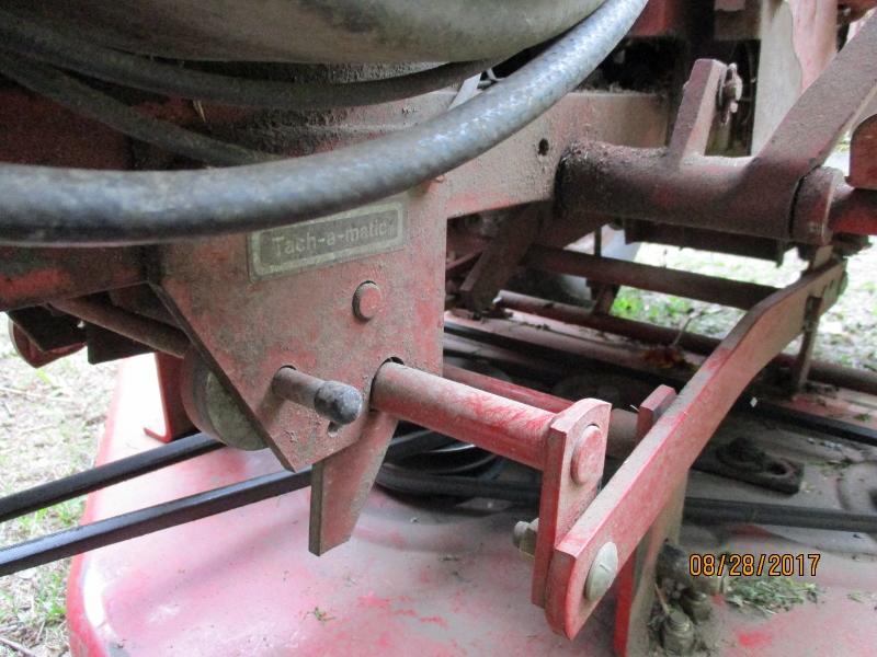

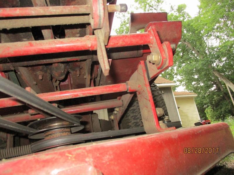

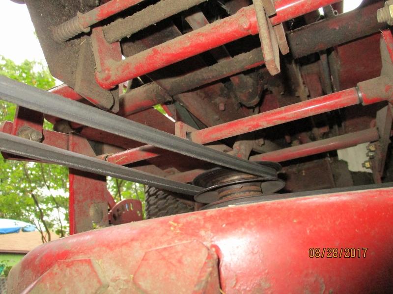

520hC-120 136 #1 Posted August 28, 2017 Hi guys, recently it took off my mower deck off for a tractor pull all goes well I go home I put it on and it falls off 3 times within 20 mins, I'm not gonna be like a fly trying to bust through a window saying this time! this time!. It would help if I could see any pictures of what my linkage from mower deck to frame should look like thank you. Share this post Link to post Share on other sites
WVHillbilly520H 10,379 #2 Posted August 28, 2017 From the deck I have in my 1st pic the lift rod from the tractor goes into the slotted hole directly above the drive pulley then the rod at the front that rolls around between the mower lift/stabilizer arms goes up into the mid attach-a-matic on the cross bar there's a "v" that has to align with the mid hitch before rotating the lock, Jeff. Share this post Link to post Share on other sites
520hC-120 136 #3 Posted August 28, 2017 (edited) Yes, and the cross bar with the v has bands on the sides which will not let my locks go on completely and the lift arm doesn't let me lift the deck completely to the frames bracket Edited August 28, 2017 by 520hC-120 Share this post Link to post Share on other sites

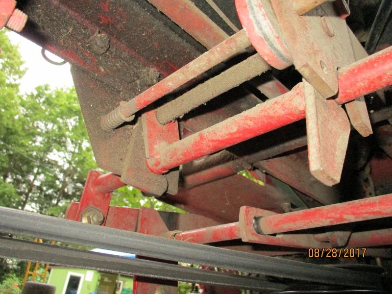

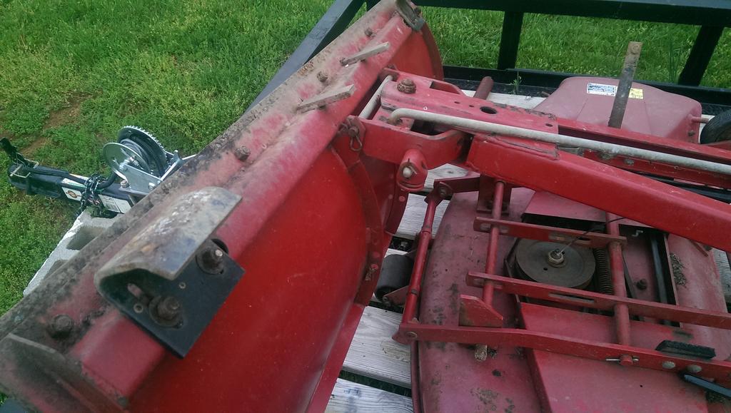

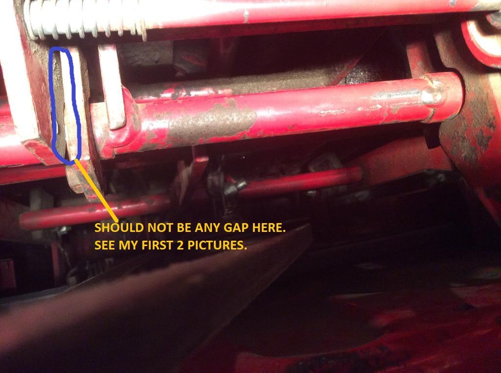

N3PUY 1,031 #4 Posted August 28, 2017 (edited) 5 hours ago, 520hC-120 said: Yes, and the cross bar with the v has bands on the sides which will not let my locks go on completely and the lift arm doesn't let me lift the deck completely to the frames bracket Those bands help center the rod and will not get in the way of the locks. Connect it and post a picture. Someone may see the problem. Here's pics of mine ... your's should look the same. Edited August 28, 2017 by N3PUY 2 Share this post Link to post Share on other sites
ericj 1,580 #5 Posted August 28, 2017 34 minutes ago, N3PUY said: Those bands help center the rod and will not get in the way of the locks. Connect it and post a picture. Someone may see the problem. Here's pics of mine ... your's should look the same. looks like a tractor that needs a bath eric j 1 Share this post Link to post Share on other sites

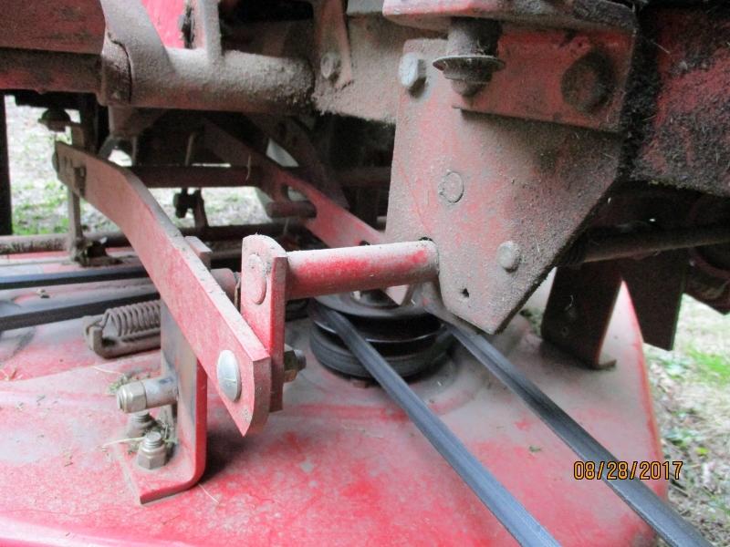

roadapples 6,987 #7 Posted August 29, 2017 Last picture-- that pin is supposed to be in the slot... 1 1 Share this post Link to post Share on other sites
N3PUY 1,031 #8 Posted August 29, 2017 (edited) I SEE A GAP IN YOUR ATTACH-A MATIC PLATE AND LOCK LEVERS. LOOKS LIKE THEY AREN'T WIDE ENOUGH TO LOCK BESIDE THE BANDS. I THINK YOUR'S GOT BENT SIDEWAYS. Edited August 29, 2017 by N3PUY 1 1 Share this post Link to post Share on other sites
520hC-120 136 #9 Posted August 29, 2017 So should I buy new attach-a-matic system Share this post Link to post Share on other sites
TDF5G 2,074 #10 Posted August 29, 2017 (edited) You don't have it mounted properly as other members have pointed out. I don't think you need new parts. First, the lift bar peg (on the tractor) needs to go into the oblong slot on top of the mower deck carriage. The deck has to be slid in from the right side of the tractor to do this. Then you need to center the cross shaft (of the same carriage assembly) on your deck between the mid mount attach-a-matic bracket on the tractor. Make sure the lock lever moves all the way back under the cross shaft until the release pin pops out and you should be good to go. There is also a u shaped alignment piece that needs to go in it's proper place also on the carriage assembly. I can see why it keeps falling down. Study the details of N3PUY's pics and you'll get it on there correctly. He is correct about the gap. IMO I doubt it is bent though. It looks to me like the shaft needs to be moved to the left in that pic where he points out the gap. I've found an easy way for me to mount the deck is after sliding it underneath the tractor and putting the lift bar peg in the slot, I stand directly in front of the tractor facing it, I lean over and lay my chest on the hood then push up on the lift handle with my left hand hand while lining up the deck carriage assembly into the attach-a-matic with my right hand. Edited August 29, 2017 by TDF5G 1 Share this post Link to post Share on other sites
Pat_In_Denver 104 #11 Posted August 29, 2017 16 hours ago, N3PUY said: I SEE A GAP IN YOUR ATTACH-A MATIC PLATE AND LOCK LEVERS. LOOKS LIKE THEY AREN'T WIDE ENOUGH TO LOCK BESIDE THE BANDS. I THINK YOUR'S GOT BENT SIDEWAYS. I'd also add there seems to be something not right with the chain and loose trunnion in the center of this picture. The chain should be attached to the lift arm, and trunnion connected to the rock shaft above it. 1 Share this post Link to post Share on other sites

Lee1977 7,809 #13 Posted September 1, 2017 I can't tell from your picture, but the fork on the hitch of the deck should go on the upper rod in the tractor hitch. 1 Share this post Link to post Share on other sites
