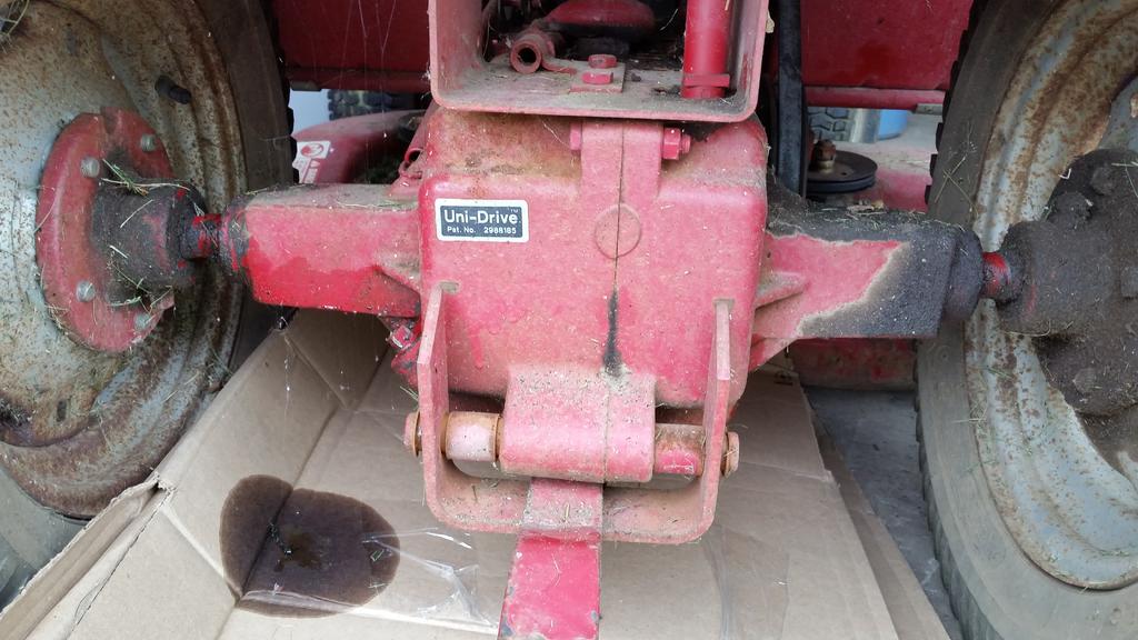

Tom565 5 #1 Posted August 27, 2017 Hi. My neighbor gave me this tractor for free because she couldn't get it to run. I replaced the battery, fuel lines and filter. It runs great now but I noticed the rear axle is dripping. I looked up Uni-Drive 2988185 and couldn't get a specific part number for the seal. If I could get a part number that would be great. I would just order it online. Thanks. 2 Share this post Link to post Share on other sites

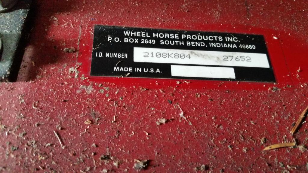

'garGuyPaulie 5 #2 Posted August 27, 2017 (edited) Hi Tom - nice horse you got there! Check out the following web page and look on the diagram labeled Mechanical (at the top there are several diagram pages to choose from, scroll over to Mechanical) - I believe the part you're looking for is the oil seal on the axle, which would be part no. 100863 - the following diagram labeled Page W shows the additional parts available for that transmission. Hope it helps! http://www.ereplacementparts.com/toro-2108k804-1988-lawn-tractor-parts-c-121776_128672_131564.html Also - that is the wheel horse part number for the oil seal, you could probably shop around for a better price - I just use that website because they seem to have pretty good diagrams for finding parts! Edited August 27, 2017 by 'garGuyPaulie 2 1 Share this post Link to post Share on other sites

953 nut 68,775 #6 Posted August 27, 2017 You can't beat the price, good going! The attached PDF will give you all the common industry part numbers you will need. You can go to NAPA or an industrial supply house like WW Grainger and get them for a lot less than a Toro dealer. You will want to check the axle for any up/down or front/rear play which could indicate a bad bearing which could have damaged the seal and would need to be replaced. 1-6&8 speed UNI DRIVE TRANS.pdf 1 Share this post Link to post Share on other sites
