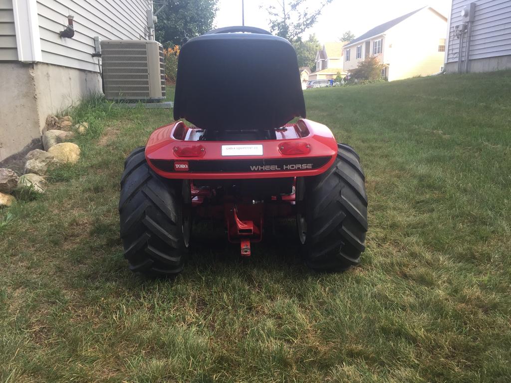

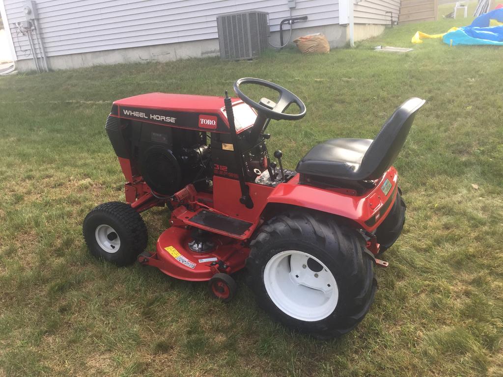

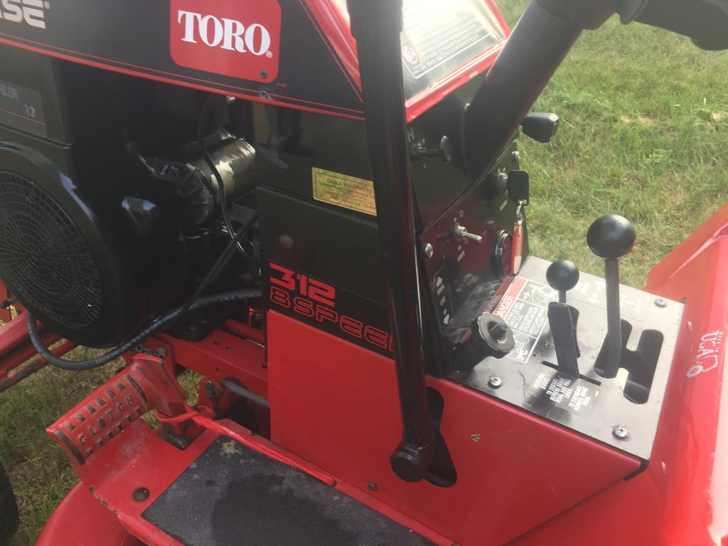

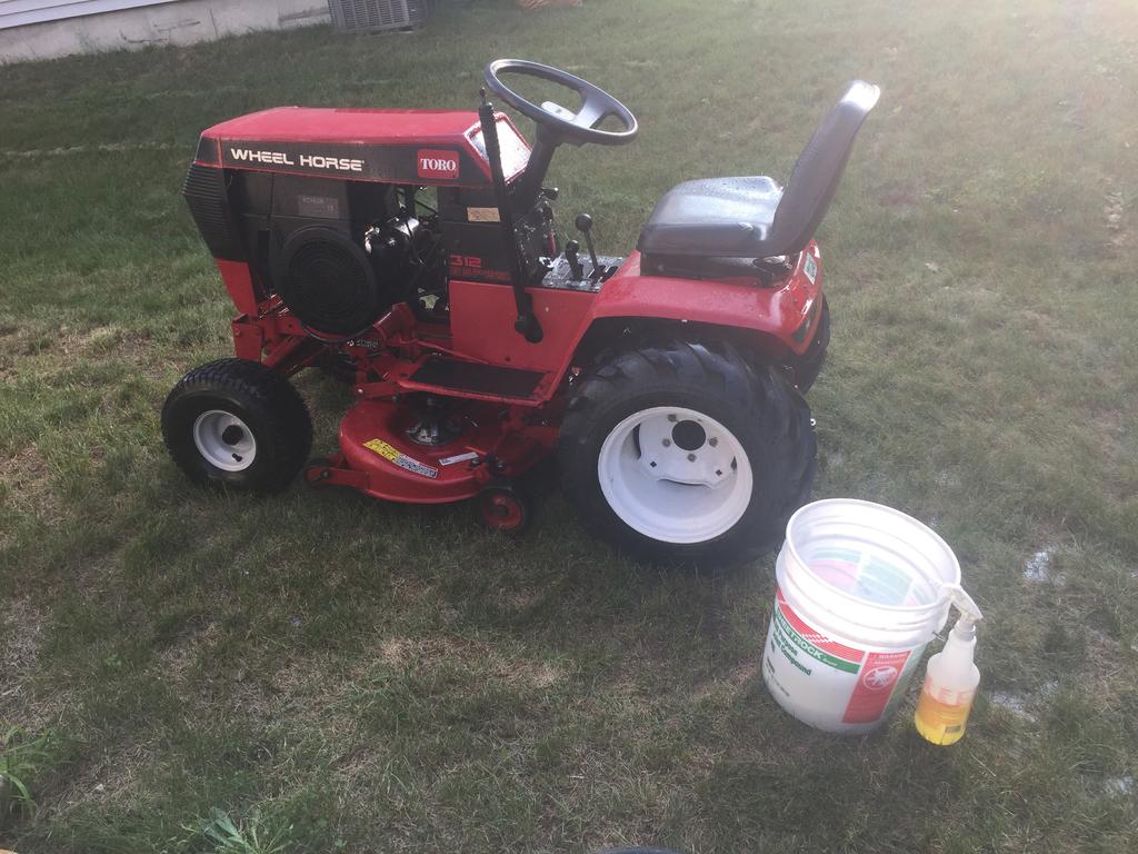

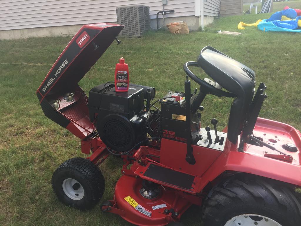

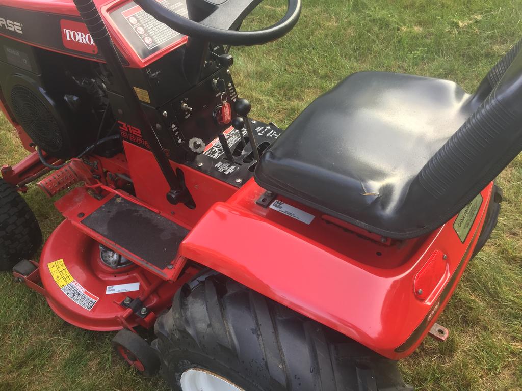

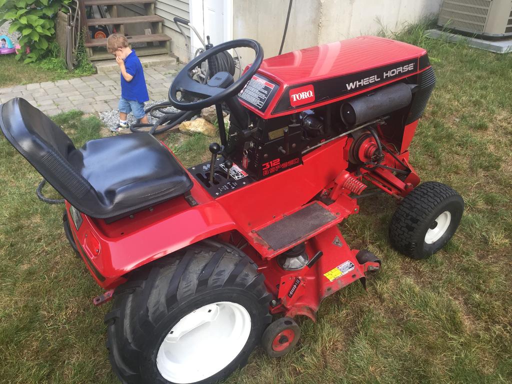

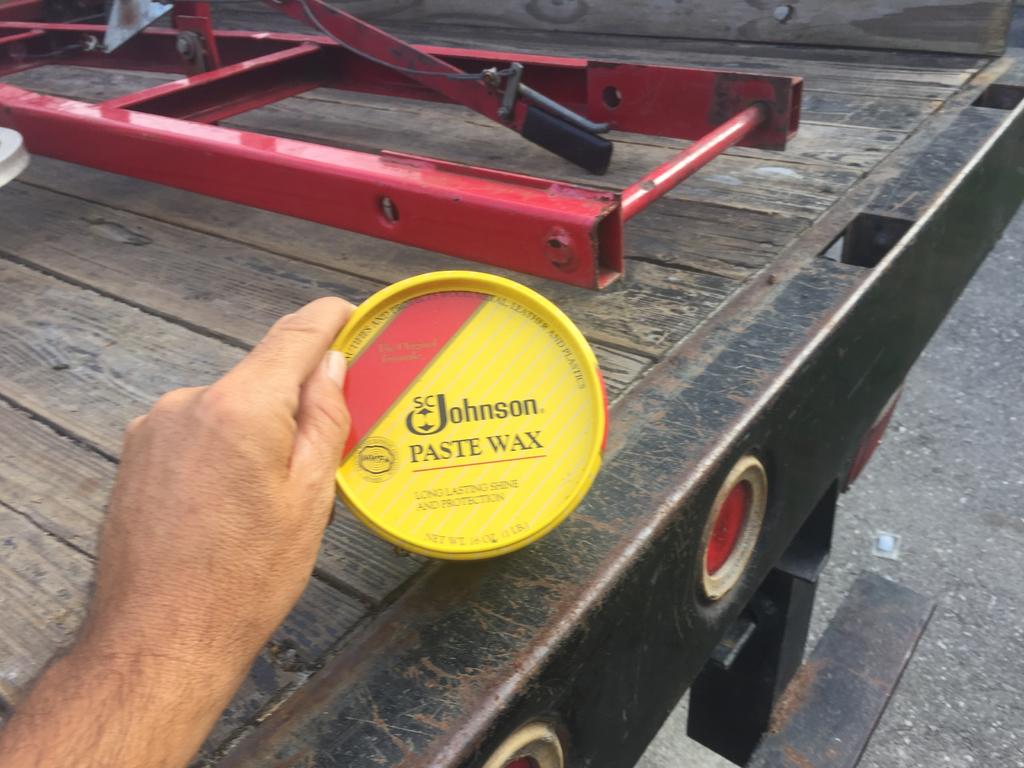

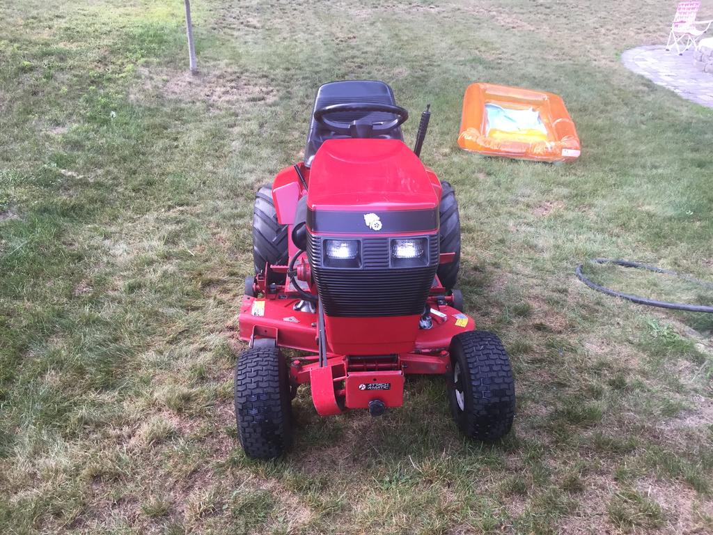

Red144runner 659 #1 Posted August 27, 2017 Now, this is a work tractor, not a show tractor. But Wheelhorse aren't box store junk and never were. I take pride in my equipment and trucks, none of which were bought new but I've always bought for quality and good equipment holds up that's why I bought my 3/12. Was a little dirty and dusty so today I decided to give it a late summer cleanup. Wash, scrub, polishing compound and a coat of wax. I washed and dried it then rubbed some mothers step 1 on it then johnsons paste wax per suggestion on the site. That's a blast from the past, my nana used that on everything! Im happy with the results. Still has some scratches but I'm ok with them. I got this tractor a little over a year ago from the original owner's son. I still am impressed with not only the craftsmanship but the performance and the mowing quality is as good or better than any commercial walkbehind I've ever run. 16 4 1 Share this post Link to post Share on other sites

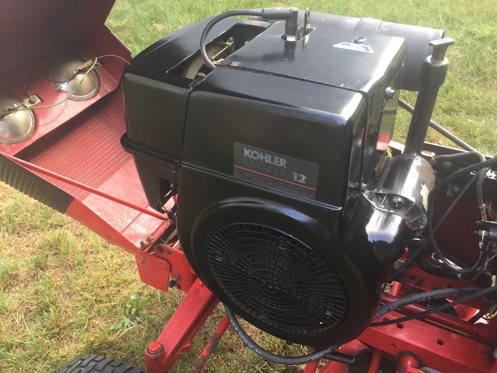

953 nut 69,104 #2 Posted August 27, 2017 you even waxed the engine! 1 Share this post Link to post Share on other sites
Red144runner 659 #3 Posted August 27, 2017 8 minutes ago, 953 nut said: you even waxed the engine! Actually i used somthing else on the black parts. Long time ago got a tip on what to use to restore sun faded chainsaw plastics (engine top covers recoils). Simple and safe on all surfaces I've used it on. 50/50 mix boiled linseed oil and paint thinner. 10x better than any trim restore product I've ever used. And used on plasic, painted steel and aluminum. 4 1 Share this post Link to post Share on other sites
AMC RULES 37,259 #4 Posted August 27, 2017 I keep trying to tell these guys about the Johnson's paste wax tip... some beautiful results you achieved there today. 1 Share this post Link to post Share on other sites
Red144runner 659 #5 Posted August 27, 2017 57 minutes ago, AMC RULES said: I keep trying to tell these guys about the Johnson's paste wax tip... some beautiful results you achieved there today. I'm tempted to try it on my truck. Very happy with results 1 Share this post Link to post Share on other sites
953 nut 69,104 #6 Posted August 27, 2017 16 hours ago, Red144runner said: Actually i used somthing else on the black parts. Long time ago got a tip on what to use to restore sun faded chainsaw plastics (engine top covers recoils). Simple and safe on all surfaces I've used it on. 50/50 mix boiled linseed oil and paint thinner. 10x better than any trim restore product I've ever used. And used on plasic, painted steel and aluminum. Thanks for the tip, I have used the same mix to protect aged wood without making it look "finished". Share this post Link to post Share on other sites
Sarge 3,473 #7 Posted August 28, 2017 I've used the Johnson paste wax now for about 45yrs , usually buy the "Kit" version that includes the cover and application sponge . It doesn't seem to do as well on base/clear paints but nothing equals the stuff on good 'ol enamels . The way it polishes the top layer of haze off the paint and the fact it lasts a good 6mo/+ has worked for me well . My grandfather grew up on Simonize paste , but that stuff was a pain in the butt in comparison to the Johnson's and honestly I don't think the results were any better or different . For the '14 Dodge pickup and it's base/clear deep cherry red crystal pearl ( ~ "don't ever scratch this color , per my body guy") it gets Wizard's products and they are stellar . For black stuff or plastics - especially to protect plastic from sun aging and vinyl products - try Aerospace 303 - nothing works better nor lasts as long and dust doesn't collect on it . Also awesome on rubber seal stripping . Leaves a nice color , no runs/excess and keeps vinyl like new . JC Whitney now carries their line in stock , btw... Sarge 1 Share this post Link to post Share on other sites
TDF5G 2,074 #8 Posted August 29, 2017 Your looks mighty fine! 1 Share this post Link to post Share on other sites
