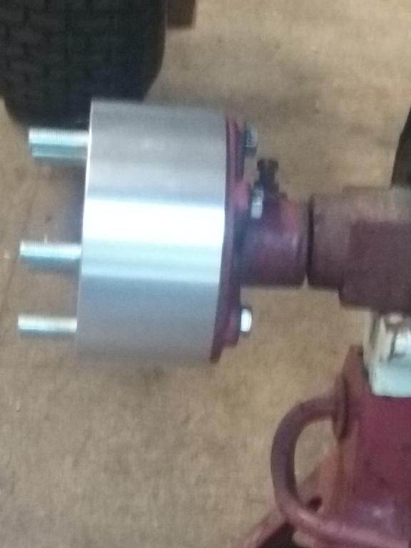

ebinmaine 79,167 #1 Posted August 24, 2017 I need to remove the hubs because the left side is leaking and both bearings are on the outside of wear specs. I know the use of a full 5-bolt puller is normally recommended... and NO hammering. I'm thinking (hoping) that the bolted on spacer would add a fair amount of stability???? Do you Experts feel that with the hub extension bolted on I could safely use a 3 jaw puller? 1 Share this post Link to post Share on other sites
953 nut 66,635 #2 Posted August 24, 2017 Looks like a good idea. I would suggest you look at the post @meadowfield did a few minutes ago on pulling hubs. Share this post Link to post Share on other sites
ebinmaine 79,167 #3 Posted August 25, 2017 58 minutes ago, 953 nut said: Looks like a good idea. I would suggest you look at the post @meadowfield did a few minutes ago on pulling hubs. Will do ! Share this post Link to post Share on other sites
cafoose 3,736 #4 Posted August 25, 2017 2 hours ago, 953 nut said: Looks like a good idea. I would suggest you look at the post @meadowfield did a few minutes ago on pulling hubs. Post 9 in this thread: Share this post Link to post Share on other sites
ebinmaine 79,167 #5 Posted August 25, 2017 13 hours ago, cafoose said: Post 9 in this thread: That's a pretty awesome idea. I won't have time to try it for a few days but I'll let you know how it went. Share this post Link to post Share on other sites
