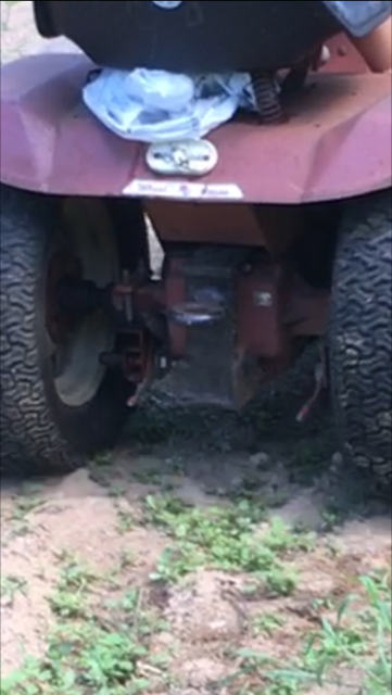

TonyToro 1,189 #1 Posted August 22, 2017 We are on the final stretch to this pulling tractor project before the next fair. I was wondering if the gearbox housing is strong enough to pull off of. I have the hitch bolted with 3 bolts. Two on the top of the gearbox under the seat and one through the large bottom hole on the gearbox. I am thinking about attaching wheelie bar bracket to the left and right side of this hitch. Would this be to much stress on these three points? The tractor has a factory wheelhorse plow still attached. I was thinking about leaving it on for added front end weight. Share this post Link to post Share on other sites
953 nut 68,396 #2 Posted August 22, 2017 You will run out of traction long before you would damage the transmission case. 3 Share this post Link to post Share on other sites
fast88pu 3,394 #3 Posted August 23, 2017 On August 21, 2017 at 8:21 PM, 953 nut said: You will run out of traction long before you would damage the transmission case. I second that. Especially if your using those tires 1 1 Share this post Link to post Share on other sites
TonyToro 1,189 #4 Posted August 24, 2017 Thanks guys. I'll get those brackets welded up tomorrow. My my son is pulling in the Jr. Stock class, so the tires need to be turf tires. Every day he gets more excited with the progress of the tractor and that his first pull is coming soon. 2 2 Share this post Link to post Share on other sites
