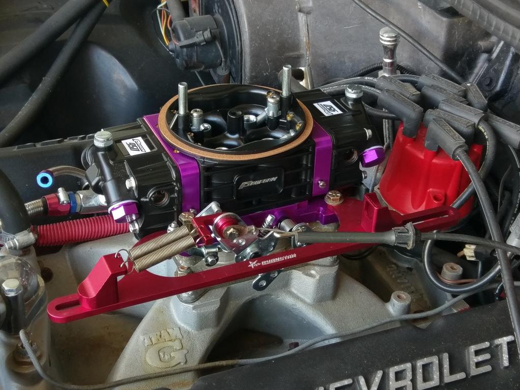

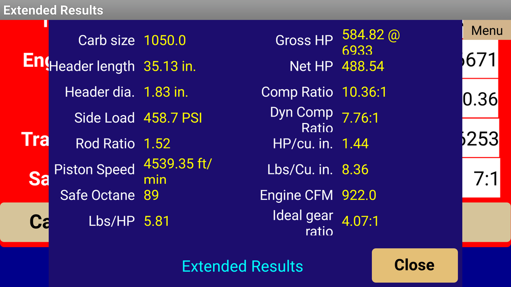

WVHillbilly520H 10,377 #10 Posted August 23, 2017 4 hours ago, elcamino/wheelhorse said: @WVHillbilly520H Nice , how many cubic inches and HP in the Chevy? It started out as a virgin SB400 now it's bored out .030" over to 406 CI with Dart heads with a healthy solid roller Comp cam, forged 10.3-1 CR pistons on a Eagle crank and i-beam rods, pushing around 580 HP at the flywheel by a computer Dyno program so +/- 15% in the real world, Jeff. 1 Share this post Link to post Share on other sites
