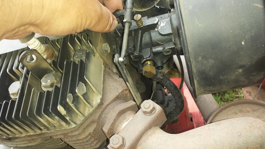

Knightws6 9 #5 Posted August 19, 2017 Thanks guys for the open arms. I bought this tractor on a whim, and now its being a pain in my butt... lol perhaps Im not doing this right, but I;m having a hard time locating a carb. The info I have is kohler 16hp cast iron line spec. no 71311.... model K??1AS serial #13137375 Share this post Link to post Share on other sites

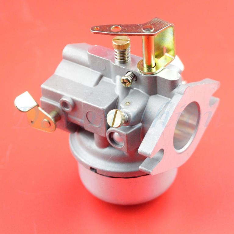

pacer 3,180 #6 Posted August 19, 2017 Welcome aboard! and dont give up on the old girl they are toooo much fun to have around.... As to the carb, just go to the 'bay' and put in search "kohler k341 carburetor" and just stand back and watch several hundred pop up. But as bob maynard said on many of these carbs the choke cable hook-up is different from our horses. I have had good luck in 'adapting' one to a horse hook up but that may not be for everyone (you have to remove the butterfly/shaft) Most of them show a side view of the carb and using yours compare it to the pic. Share this post Link to post Share on other sites

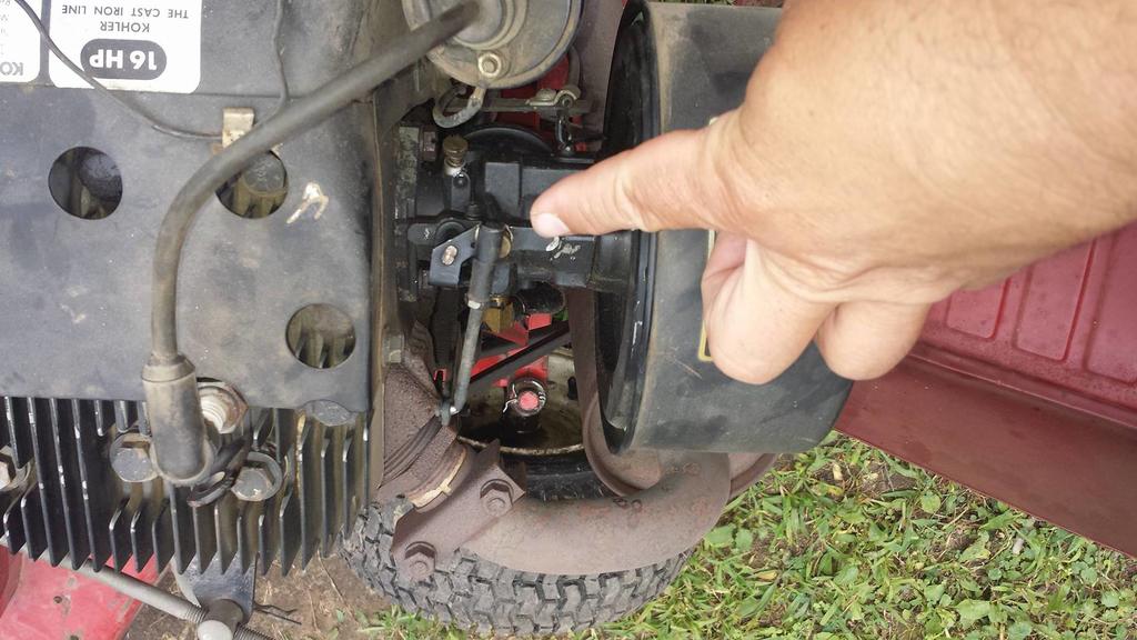

Knightws6 9 #9 Posted August 21, 2017 so they sent me this message. anybody know which version of the carb I will need to order. Item number 351766615184 is the carb and ad shows the long skinny choke lever but we also have it with the small triangular shape for same price. Just let me know which one you want if you order! Thank you Share this post Link to post Share on other sites
pacer 3,180 #10 Posted August 21, 2017 Youre pointing to the throttle... The choke is the other cable on the side. My K341 16hp takes this type choke hookup here ---- see if yours doesnt look like it. Its item #192062192858, Its from China for $21. They show it for a K341 but say its a #26? Share this post Link to post Share on other sites
953 nut 66,586 #11 Posted August 21, 2017 4 hours ago, Knightws6 said: long skinny choke lever but we also have it with the small triangular shape for same price. In your case it wold be the triangular one because the choke cable is coming up. If it were coming down (like on na GT-14) it would be the long skinny one. Share this post Link to post Share on other sites
