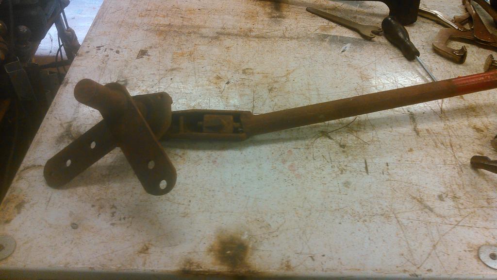

Lee1977 7,371 #11 Posted August 23, 2017 (edited) What are we talking about rocker shafts or bellcranks? The picture above shows a bellcrank. The rocker shaft is mounted in the rear fender support. The bellcrank looks the same but the lift lever is completely different in 1978 and up models. Edited August 23, 2017 by Lee1977 Share this post Link to post Share on other sites
Thor27 844 #12 Posted August 23, 2017 (edited) I think 75 is the magic year when they changed from the hinged fenders? My 76 has the same seat mounting as the later tractors but with out the rear tank, it uses the shorter style too. Following along to see what you come up with, I haven't seen a rock shaft on the earlier tractors. My raider has a long cable all the way up to the bellcrank, but it is a 68. 3931 was the part number for the cable. Lowell has them on his site at the link bellow: LOOK HERE! Edited August 23, 2017 by Thor27 add p/n and link Share this post Link to post Share on other sites
