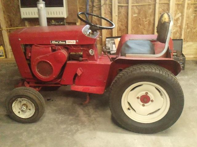

TravelinJavelin 621 #11 Posted August 17, 2017 (edited) hello there nyquil junkie I have a 953 myself and your serial number is way earlier than mine yours is 34148 and mine is 34698 this is my beast anyways just went through some tranny issues myself and stevasaurus was awesome enough to send me a dog set screw which so far is holding up well ....you just can't get crazy on these shifter's..... Aand Z tractor does have a complete tractor .....which is crazy in my part of the woods I just come on to a deal in NH on C/L on 2 1054's with plows mowing decks and snow blowers for a $1000 or best offer....if I had all kinds of cash i'd hunt these right up and buy everyone if I could ...as much as I love the C series these 953/1054's are my favorite and after I took out the tranny and so fourth I kind of swore at the engineer designer a little but after I recently stripped a JD 112 I take back my swearing on the wheel horse team .......to work on a tractor there nothing more simple in design than a wheel horse Edited August 17, 2017 by TravelinJavelin 2 2 Share this post Link to post Share on other sites
