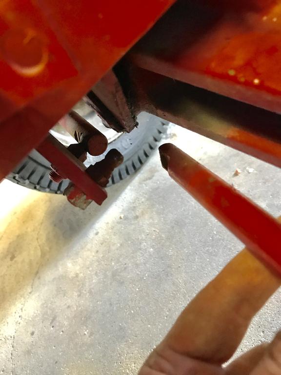

Dave1967 4 #1 Posted August 14, 2017 I'm having issues with a wheel horse tracktor I acquired. The steering linkage popped off and I'm not sure what to do. See photo attached. thanks dave Share this post Link to post Share on other sites
oldlineman 1,820 #2 Posted August 14, 2017 you need a new tierod, go to our vender section there are severial venders there that can help you out, 3 Share this post Link to post Share on other sites

elcamino/wheelhorse 9,363 #4 Posted August 14, 2017 @Dave1967 You can remove both from the tractor and as a temporary fix. Insert the ball back into the socket and then take a hammer and a punch and tap all around the socket to hold the ball until you can get a new tie rod. 4 1 Share this post Link to post Share on other sites
Dave1967 4 #5 Posted September 9, 2017 Thanks a lot this worked. What part do I need to order? Share this post Link to post Share on other sites
953 nut 70,343 #6 Posted September 9, 2017 Lowell can fix you up. https://www.wheelhorsepartsandmore.com/steering.html#!/Steering/c/23548038/offset=12&sort=normal 1 Share this post Link to post Share on other sites
