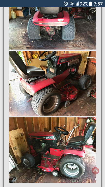

swisstrac 49 #1 Posted August 14, 2017 can some one tell me what the primary choice size mower is for the 520H?? i am looking at one and it has only a 42" seems a bit small for a 20hp tractor/ thanks much for your input/Ray Share this post Link to post Share on other sites

WVHillbilly520H 10,369 #9 Posted August 14, 2017 1 hour ago, gwest_ca said: I believe the rear wheels on the 42" deck interfere with the rear wheels/tires used on the 520. Garry IDK, here's 1 with the 42" RD, maybe the SD is different, Jeff. 1 Share this post Link to post Share on other sites
gwest_ca-(File Mod) 10,491 #10 Posted August 14, 2017 Yes they did list a 42" SD deck. Probably not recommended because you don't need 20hp to run one. Garry 6 hours ago, gwest_ca said: I believe the rear wheels on the 42" deck interfere with the rear wheels/tires used on the 520. Garry Share this post Link to post Share on other sites
Chevydave 25 #11 Posted August 17, 2017 Looks like the deck height adjustment wheels might be further apart on the rear discharge deck, 520 wheels on the rear of my 416-8 with a 42SD didn't work. Share this post Link to post Share on other sites
cleat 4,947 #12 Posted August 17, 2017 42" SD deck will only fit the early maroon 520's with the smaller tires. Later 520's and 520HC with the larger tires hit the deck wheels. I know for a fact because I tried. Cleat Share this post Link to post Share on other sites
608KEB 794 #13 Posted August 18, 2017 (edited) 6 hours ago, cleat said: 42" SD deck will only fit the early maroon 520's with the smaller tires. Later 520's and 520HC with the larger tires hit the deck wheels. I know for a fact because I tried. Cleat Correct Cleat. I use a 42" SD on my 95 520H with stock rear tires. I had to move the bracket for the mower deck wheels out about 2 1/2" Edited August 18, 2017 by 608KEB Share this post Link to post Share on other sites
