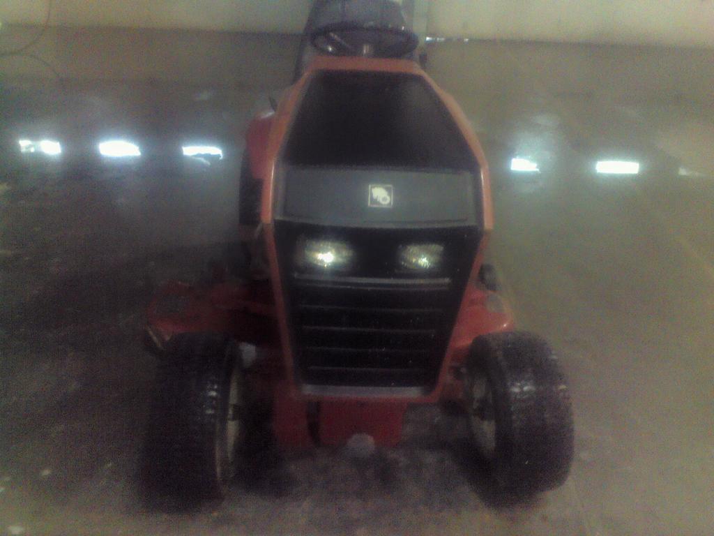

Big_Red_Fred 1,548 #1 Posted August 13, 2017 Im restoring my C125, i bought offset wheels for back, Big meat AG's, can i put 18x6.50x8 on front instead of 16teens ? Or isnt it possible to go up a tire size on it ? I know you guys want sum pics, but your gonna have to wait for the Red Tide to be finished. There it is in shop a few weeks ago, No More out of toe with new adjustable tie rods ! Share this post Link to post Share on other sites
953 nut 66,538 #2 Posted August 13, 2017 As long as they will clear the deck with it raised there should be no problem. The front will be an inch higher so the deck angle will need to be adjusted to compensate. Share this post Link to post Share on other sites
