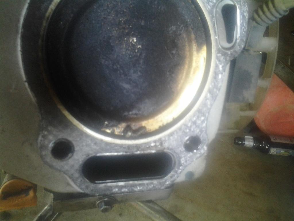

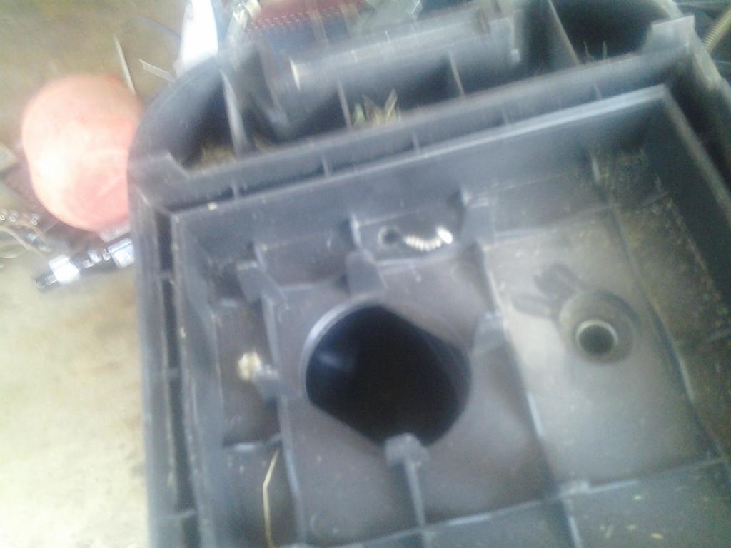

ohiofarmer 3,475 #1 Posted August 12, 2017 (edited) I had just finished mowing the yard with my 520 with a 420 cc predator. It has been a good engine, and like a good engine should, it got the tractor back to the barn and just quit running. I was gonna replace it under the extended warranty, but the warranty had expired.. Time for an autopsy. We all know these are throw away engines, so at least something might be learned before buying another. I did not do stuff in the correct order, but the original idea was just to look things over anyway. First, i used the pull start and it moved a bit and then ---CLUNK--- Broken connecting rod,says I.. Then I turned it backwards and it clunked again.I stripped it down and took off the side cover, expecting disaster, but everything was oK and the oil sump even looked clean. It had compression so i took off the spark plug and noticed a screw missing from inside the air cleaner. The pictures tell the rest. [Look closely at the bottom of the picture of the piston] So a sheet metal screw into plastic might not win any industry awards for engineering. Couple that with a square piece of foam for an air filter with space underneath so that same screw can be sucked into the engine..The second picture shows the location in the air cleaner housing from which the bent and battered screw emerged.. The screw was big enough that it kept the piston down from TDC, so no spark happened and only one little dent in the piston and head. Two gaskets for ten bucks total will fix this engine. Now would be a good time to upgrade the air filter and install a screen for the engine air intake. Harbor Freight just came out with upgrades to the Predator engine series. The new ones have a proper paper filter that would have protected the engine from inhaling the screw. Edited August 12, 2017 by ohiofarmer 2 4 Share this post Link to post Share on other sites

Howie 900 #21 Posted August 16, 2017 Where that screw landed it may have collapsed the top ring land, which freezes the ring in its land. Possibly even breaking the ring in some cases. No easy way to check without a teardown. Have a Honda engine here that happened to. Yours may be ok, if not May tear up the cylinder wall. Share this post Link to post Share on other sites
shallowwatersailor 3,222 #22 Posted August 16, 2017 On 8/12/2017 at 4:42 AM, ohiofarmer said: I had just finished mowing the yard with my 520 with a 420 cc predator. It has been a good engine, and like a good engine should, it got the tractor back to the barn and just quit running. I was gonna replace it under the extended warranty, but the warranty had expired.. Time for an autopsy. We all know these are throw away engines, so at least something might be learned before buying another. Harbor Freight just came out with upgrades to the Predator engine series. The new ones have a proper paper filter that would have protected the engine from inhaling the screw. Was this one of the original style 420cc Predators with the steel valve cover or the later "hemi" with the cast valve cover? Share this post Link to post Share on other sites
