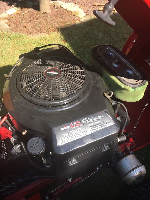

953 nut 62,518 #2 Posted August 11, 2017 6 hours ago, Mt Zion 520H said: http://m.ebay.com/itm/Toro-Wheel-Horse-244-H-Tractor-with-Grader-Snow-Blade-/112517282536?hash=item1a328d7ae8%3Ag%3Ae5AAAOSwWE9Zixp1&_trkparms=pageci%3A95bf7618-7e47-11e7-9cc3-74dbd1804437%7Cparentrq%3Acf660bcb15d0aa49389ef813ffffff26%7Ciid%3A1 What's something like that worth? Exploring options since i can't seem to find a cheap plow or anything for my 520H. I don't think this will push snow like the 520 will, keep looking for a plow. Looks like a bit of a FrankenHorse, not something I would buy without checking it over carefully. You are not supposed to put links to Ebay on the site. You may want to copy and paste a couple of pictures and the description in place of the link. Share this post Link to post Share on other sites
WHX?? 53,079 #3 Posted August 11, 2017 That tractor should have had an Onan for a motor but somebody did a repo hence the raised hood. Does look like it was tastefully done tho & probably a good tractor for lawn cutting and might not do too bad of a job plowing with the right weights & chains. Hard to tell what that motor is so it would hinge on that . Original was a 14 hp. Might not be a bad buy if you are into vertical shafts but definitely not worth the listed price ..$300.00 tops not hearing it run or being able to check it out. Looks like some PO has quite abit of time into it what with the repo and raised hood. Also appears it was fairly well taken care of but pics can be deceiving. Should have a peerless rear end in it which were not the worst transaxle ever made. Downside there is there is no way to change the fluid and no filter. I have a 246H with the same transaxle and never changed mine but never had problems in the 15+ years I have owned it. I use mine for a daily mower but have a 244 for a parts tractor just for the rear end and the hardware on it. Edit: 19 hp a plus if it runs good & gotta like the custom brush guard! Good luck if you decide to buy! Share this post Link to post Share on other sites
Mt Zion 520H 43 #4 Posted August 11, 2017 Hmm.. Interesting. What's Repo mean?.. I'm used to it meaning taken back for non payment. Lol. Also.. Whats a good price for a plow?.. Most i see want 250 and up.. Just thought if i could get another horse with something on it for just a hair more.. I'd be winning. Lol. Thanks brothers. Share this post Link to post Share on other sites
WHX?? 53,079 #5 Posted August 11, 2017 (edited) Repo means the bank is going to take it back because he wants to paint it green and yellow.... NAWWW just kidding ...repo is short for repower in our circles meaning engine swap! 250 or so might be a good price for a plow pending condition. The bigger question is what extra $$ would you have to spend to fit it up to a different tractor. If your a fabricator not a big deal. Also thos ags on the back are worth a little, they look like Deestones so 150 right there new or 75-100 used. Edited August 11, 2017 by WHX12 Share this post Link to post Share on other sites

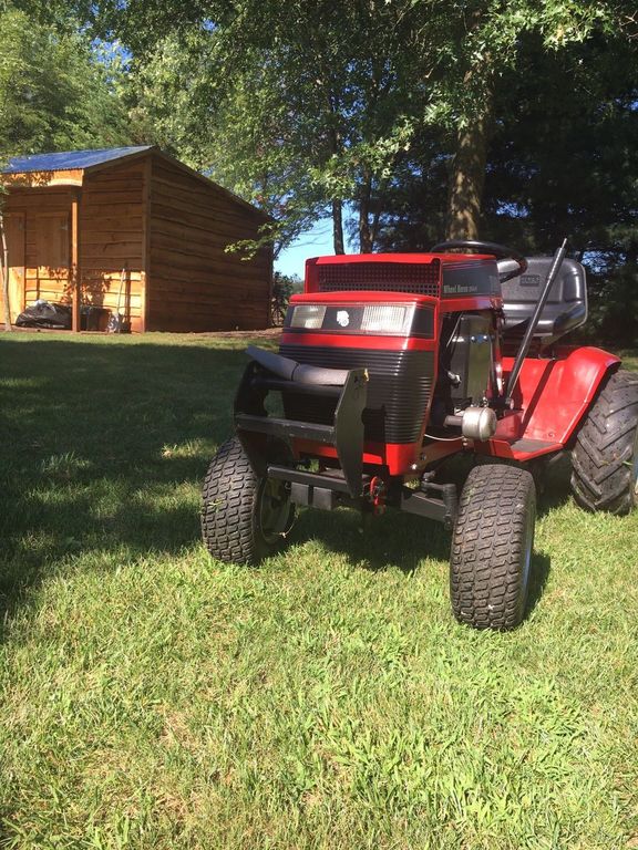

WVHillbilly520H 10,376 #6 Posted August 11, 2017 As far as what Jim meant by "repo" is repowered with a different engine, now if your 520 runs and moves decent, that little 244 will never be the pusher it is, a B,C,3,4 or500 series are the horizontal engine garden tractors for that, the newer 26X series would be a better choice for a vertical shaft engine L&G tractor for all seasons just my opinion... I see Jim got finished before me, also just keep looking for a snow plow, a 42" can be be made to work on the 520 and without the factory frame extension, I added moldboard extensions to 50" wide and then 4" to between the moldboard mount to frame, Jeff. Share this post Link to post Share on other sites

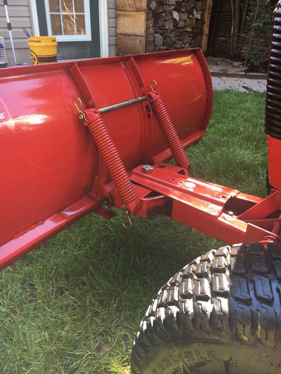

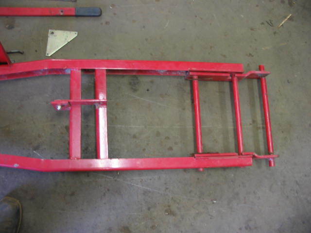

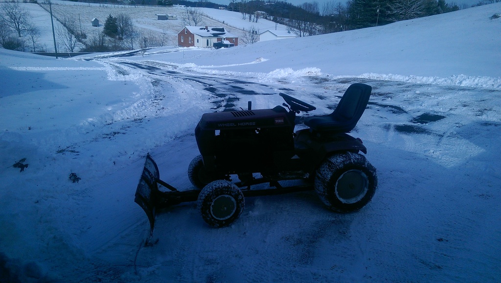

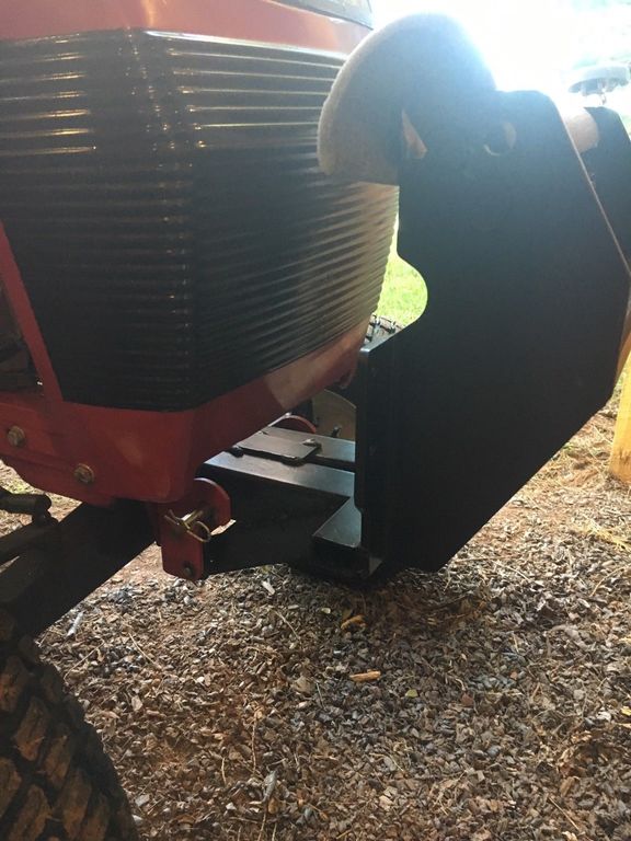

WVHillbilly520H 10,376 #9 Posted August 11, 2017 Technically there's really only one style of snow/dozer for the 520, it's the long A frame style that fits all the way back to the B,C,3,400 series and early 5s but with the swept forward axle they came up with the frame/mid lift extension but I was cheap an inexperienced when first bought mine new back in 1998 so that was my way of extending the moldboard forward of the axle so it can be angled left or right without hitting the front tires, difference shown in last 2 pics of factory vs my cheapness pic #2 the 520 blade frame extension, Jeff. Share this post Link to post Share on other sites

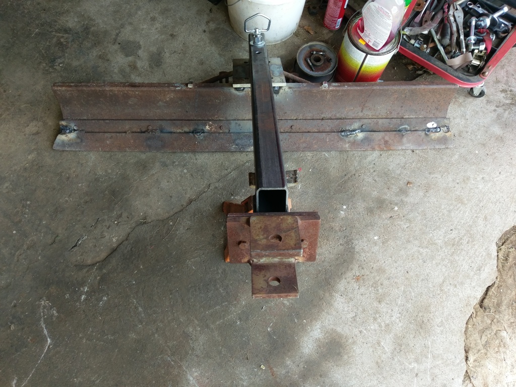

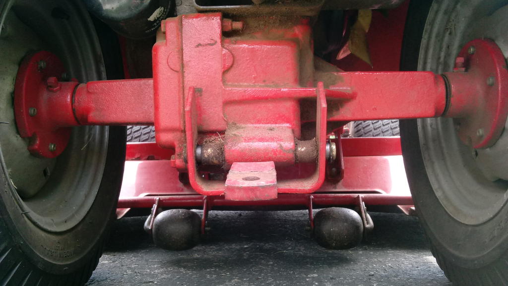

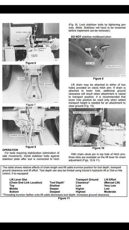

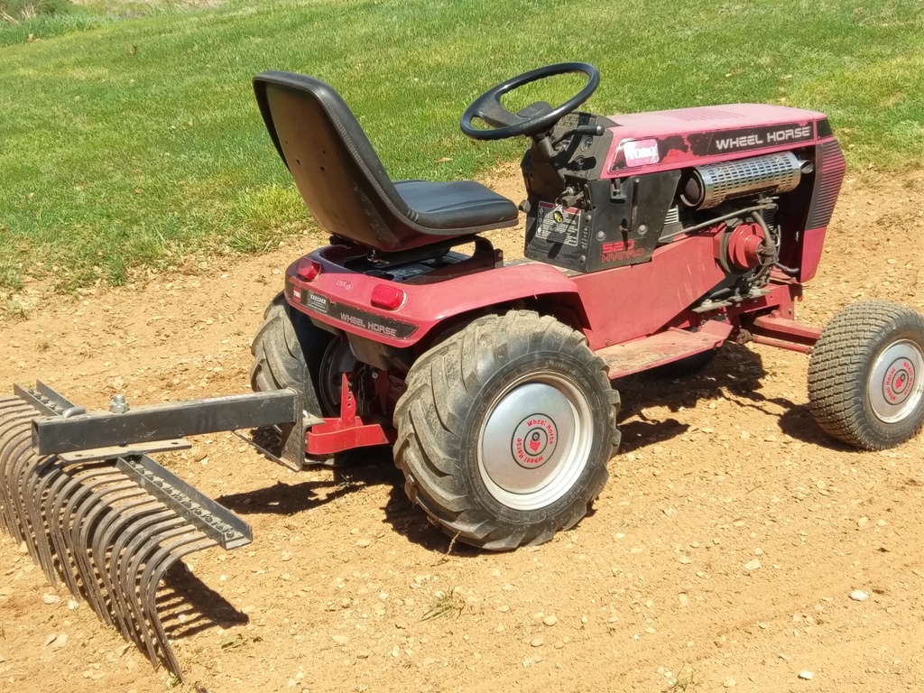

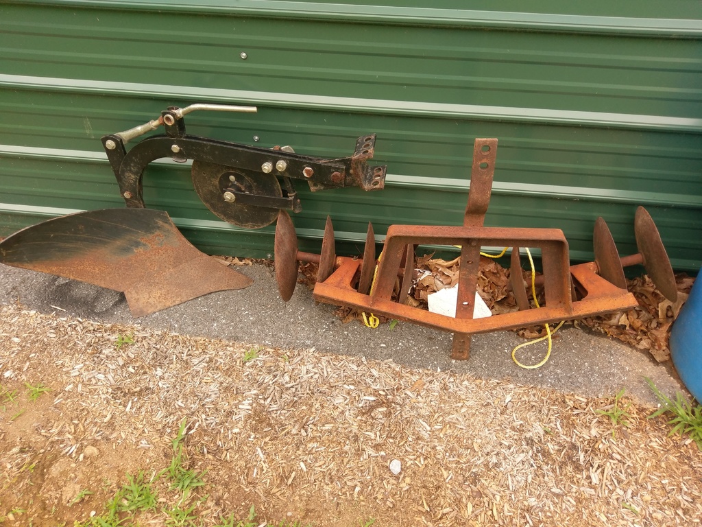

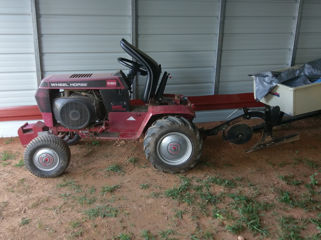

Mt Zion 520H 43 #13 Posted August 12, 2017 What's the big rake-like thing for? And the one with the disks on it? This is the only thing on rear of mine... Share this post Link to post Share on other sites
WVHillbilly520H 10,376 #14 Posted August 12, 2017 (edited) 3 hours ago, Mt Zion 520H said: What's the big rake-like thing for? And the one with the disks on it? This is the only thing on rear of mine... I'm sorry I didn't detail my arsenal, the rockshaft/clevis hitch would have to be bought and installed by you check with @wheelhorseman but it's definitely necessary for rear mounted implements such as the 2cd pic it's called a "York" or "root/rock" rake good for leveling gravel or breaking up sod clumps ect, the first pic is the Brinly moldboard/turn over plow for breaking new ground for a garden plot ect, 4th pic is a rear grader blade like they use on farm tractors for driveway repairs snow removal ect and finally last pic the moldboard garden plow with the garden disc which is used for breaking up the freshly broken sod for a garden plot or to help cut up sod to loosen in hopes of moving it with a blade ect, hope this description helps out, Jeff. Edited August 12, 2017 by WVHillbilly520H 1 Share this post Link to post Share on other sites

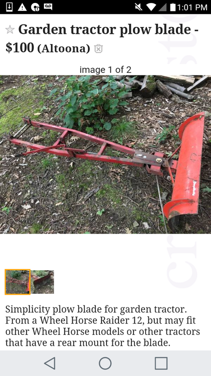

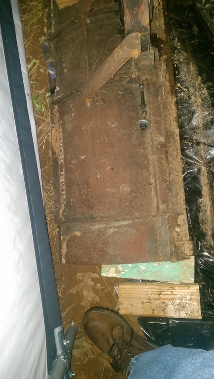

Mt Zion 520H 43 #22 Posted August 23, 2017 Will this works on the 520H? Share this post Link to post Share on other sites
