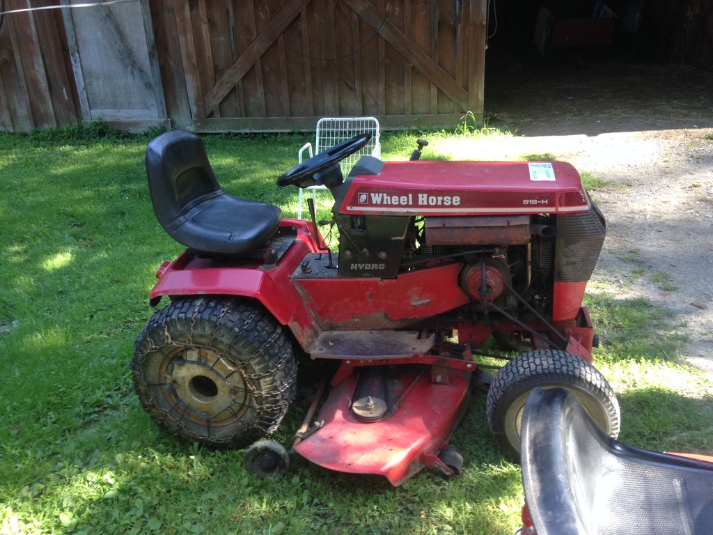

Evil Archer 300 76 #1 Posted August 7, 2017 I recently purchased a 518-H with the Eaton 700. I am not happy with the Hydro. I know I can get a 1100 and change it. My question is . A 414-8 recently came up for sale cheap with a bad Motor, I was wondering if with the 2 tractors I could build a 518-8. My property is very hilly. some spots 15 degree. I know the 8 speed would be fine on the hills. The Onnan on the 518 runs flawlessly. I s it possible to put the 8 speed in . Share this post Link to post Share on other sites

bds1984 1,519 #3 Posted August 7, 2017 I think it would be much easier to take the engine out of the 518 and put it in the 414. I see nothing wrong with doing this swap! 4 Share this post Link to post Share on other sites
Chris G 3,392 #4 Posted August 7, 2017 I thinks it's possible either way you went. With swapping rear end or motor. May have a minor amount of fab to do, but that's not a bad thing as long as the end result is what you want. 1 Share this post Link to post Share on other sites
Ed Kennell 47,247 #5 Posted August 7, 2017 The 418-8 would be my choice. 1 Share this post Link to post Share on other sites
953 nut 69,100 #6 Posted August 7, 2017 A few bolts, cables and wiring changes will be far easier than swapping the clutch,brake, transaxle. 3 Share this post Link to post Share on other sites
N3PUY 1,031 #7 Posted August 8, 2017 Tear them both down, and reassemble with the best parts of the two! 2 Share this post Link to post Share on other sites
ericj 1,580 #8 Posted August 8, 2017 I would say swap wiring but, the 518 uses more gauges. once you strip the hydro linkage out of the 516 the manual linkage from the 414-8 will go right in the 518 chassis. there was a guy down at Berryville VA show that had done it to his 516. in the end it is your tractor, take your time and study both tractors and decide for your self witch way you think will be easier for you. we will be here to help and give advise, maybe some bad at times lol but here to help you the best that we all can. good luck eric j 3 Share this post Link to post Share on other sites
Jerry77 1,218 #9 Posted August 8, 2017 1 hour ago, 953 nut said: A few bolts, cables and wiring changes will be far easier than swapping the clutch,brake, transaxle 2 Share this post Link to post Share on other sites
Jerry77 1,218 #10 Posted August 8, 2017 Just a thought; you will need to use the drive pulley on the 14 horse motor for the onan -( different size - hydro vs manual tranny). not sure what belt size you would need then but swapping motors is the best way.... 1 Share this post Link to post Share on other sites
