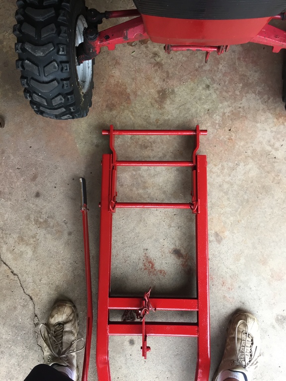

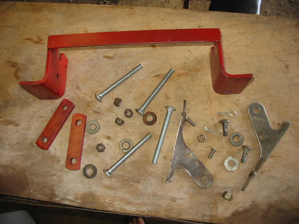

Wheelman817 21 #1 Posted August 7, 2017 Hi everyone. I'm having some trouble mounting my dozed blade to my 520h. 48 inch blade with the extension but I can't get it to mount up right with the axle bracket. Could it be that I have the wrong bracket? I thought most of the axle brackets were the same. My old 312-8 was simple. Any pics of how your mounts up in the rear would definitely help. Thanks so much in advance. Share this post Link to post Share on other sites
rmaynard 17,533 #2 Posted August 7, 2017 (edited) Pictures of yours would help as well. Edited August 7, 2017 by rmaynard Share this post Link to post Share on other sites
Wheelman817 21 #3 Posted August 7, 2017 Ill try to figure out how to post pics Share this post Link to post Share on other sites

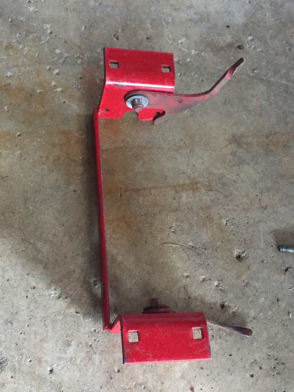

Jerry77 1,218 #4 Posted August 7, 2017 The top part of your axle bracket is missing...or did you just not put it in the picture?.. Share this post Link to post Share on other sites

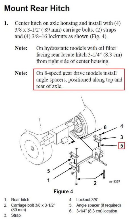

daveoman1966 3,884 #5 Posted August 7, 2017 They alll mount the same....on the B C and 300-400-500 series. 3 Share this post Link to post Share on other sites

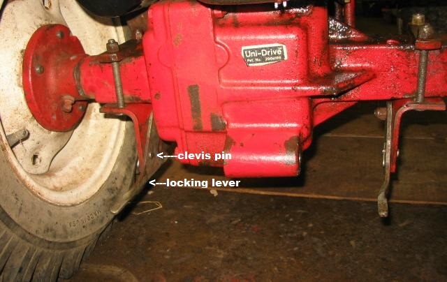

R. L. Addison 300 #6 Posted August 7, 2017 (edited) Don't the locking ears (movable levers that hold the blade frame in the axle bracket) go on the outside of the bracket and the opposite way? Edited August 7, 2017 by R. L. Addison Messed up Share this post Link to post Share on other sites
Wheelman817 21 #7 Posted August 7, 2017 It has two plates that go on top of the axle correct? 4 lag bolts go up and around the axle, through the plates? 1 Share this post Link to post Share on other sites
Jerry77 1,218 #8 Posted August 7, 2017 2 minutes ago, daveoman1966 said: They alll mount the same....on the B C and 300-400-500 series. Yes to your question and check out daveoman 1966 post - should work for you.. Share this post Link to post Share on other sites

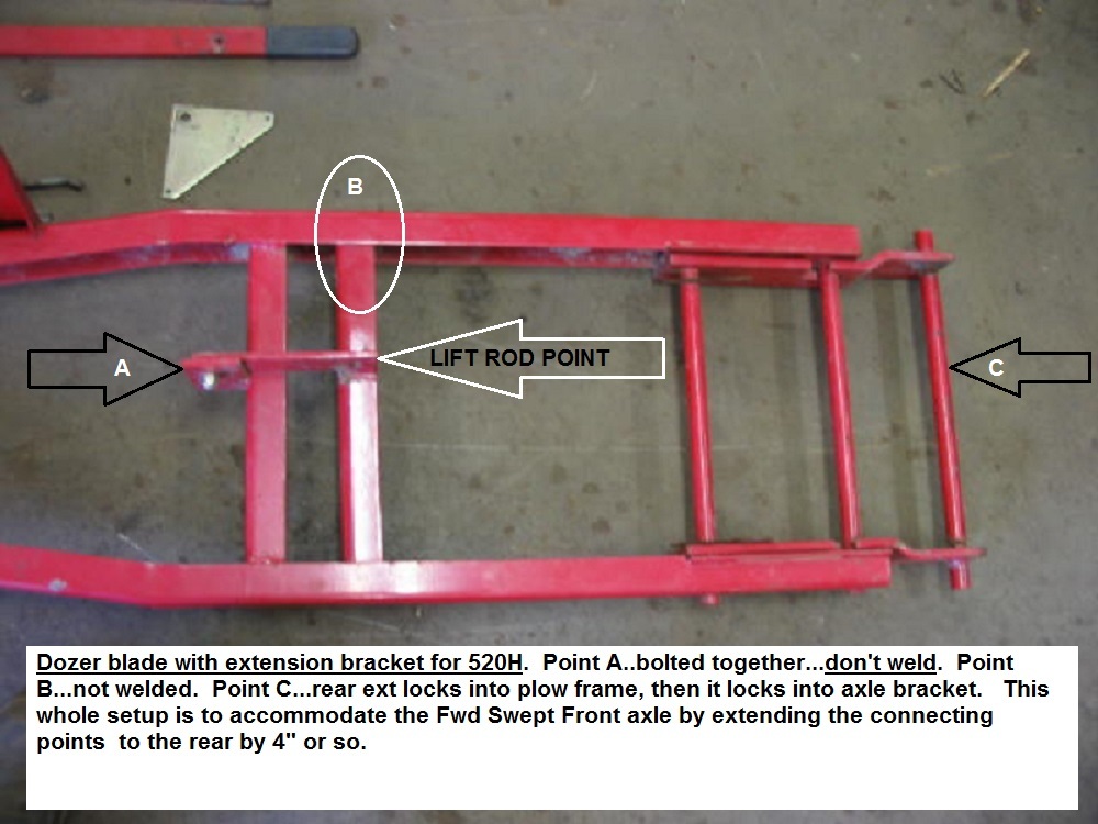

daveoman1966 3,884 #10 Posted August 7, 2017 Does this help?? 3 Share this post Link to post Share on other sites

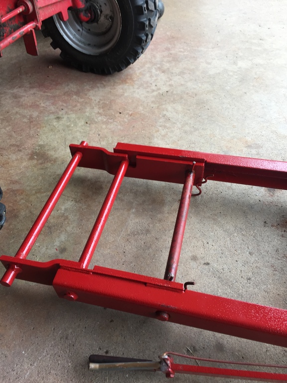

Wheelman817 21 #11 Posted August 7, 2017 Yes it does, and mine is exactly the same way. The problem I'm having, is when I install the axle bracket, the crossbar on the bracket seems to be in the way of the plow frame extension and won't let it lock in. Share this post Link to post Share on other sites
daveoman1966 3,884 #12 Posted August 7, 2017 MAYBE you have the rear axle bracket on backwards. That crossbar MUST be toward the front of the tractor./ Share this post Link to post Share on other sites
Wheelman817 21 #13 Posted August 7, 2017 I'll try it again. That's how I had it...lol Share this post Link to post Share on other sites
littleredrider 409 #14 Posted August 7, 2017 My 520-8 came with a plow w/extension, as well as the axle bracket. My bracket doesn't have the L shaped pieces, but bolts on just fine. Only issue I ran into was the plow frame rubbing on the tranny pulley. I just moved the bracket over a 1/4" or so and now it's fine. 2 Share this post Link to post Share on other sites
Wheelman817 21 #15 Posted August 7, 2017 Ok, so I tried it again and it seems I finally got the rear locked in. Not sure why I had so much trouble to begin with. I thank you all very much for your help. I absolutely love this site! 4 Share this post Link to post Share on other sites
