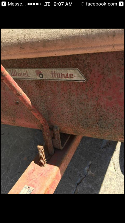

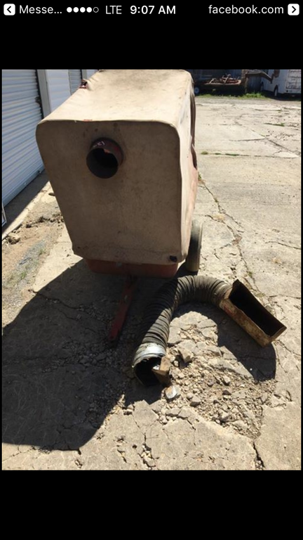

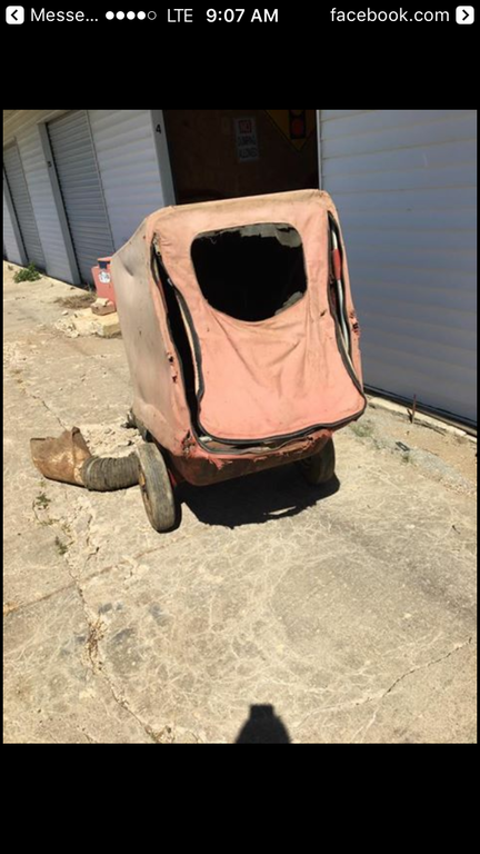

Redpower 1 #1 Posted August 7, 2017 Hi everyone i need some help. I found this wheelhorse bagger does anyone know anything about it and if it's all there. The pictures aren't real good I haven't went to look at it yet. The guy wants 30 bucks for it but idk id thats a steal. Is there suppose to be a power blower for it or does it use the pressure the blades put out to load the trailer? Thanks any help would be great! 1 Share this post Link to post Share on other sites
WHX?? 57,810 #2 Posted August 7, 2017 Redpower. First I have ever seen this type of bagger/lawn vac.. Appears to be a canopy that just goes on a standard dump cart. The tub is worth 30 alone IMHO. Others in the know will be along. Share this post Link to post Share on other sites
Redpower 1 #3 Posted August 7, 2017 Yeah it looks kinda neat and rare I thought. When I search wheelhorse bagger all i get is the mounted ones on the back no trailer style. Share this post Link to post Share on other sites
WHX?? 57,810 #4 Posted August 7, 2017 Possibly something homemade or after market in the day? Share this post Link to post Share on other sites
SylvanLakeWH 32,155 #5 Posted August 7, 2017 17 minutes ago, WHX12 said: Redpower. First I have ever seen this type of bagger/lawn vac.. Appears to be a canopy that just goes on a standard dump cart. The tub is worth 30 alone IMHO. Others in the know will be along. $30 for the trailer alone any day... Share this post Link to post Share on other sites
Rp.wh 1,104 #6 Posted August 7, 2017 definitely with you on that 30 all day long for that trailer Share this post Link to post Share on other sites
Redpower 1 #7 Posted August 7, 2017 So is the cavas and the tube a original WH item or do you guys think someone added that onto the trailer? I told him I'd take it so it'll be tonight or tomorrow before I get a better look at it. I wouldn't think the deck blades alone would make enough pressure to push grass and leaves that far up and back but maybe it would. Share this post Link to post Share on other sites

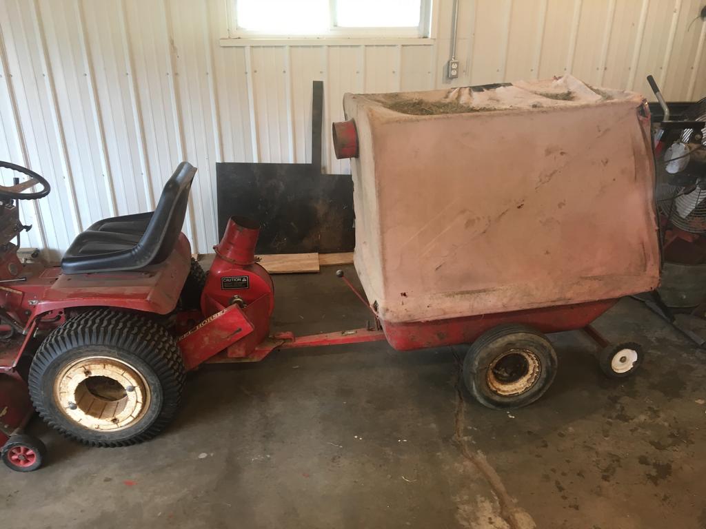

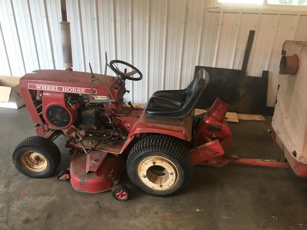

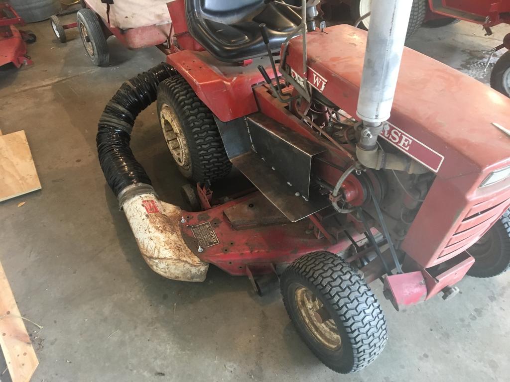

Redpower 1 #13 Posted August 13, 2017 Update got everything mounted talk about a bagger money well spent! This thing blows grass to the moon missing the outlet hose going to the trailer i got 10 foot ordered. Need a idealer pully for the drive the bearing is shot in mine otherwise it seems to work great. And the canvas needs replaced. It's mounted on my b100 had to build the pully system and i made a new foot rest/belt gaurd. Share this post Link to post Share on other sites
