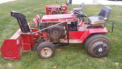

cafoose 3,833 #3 Posted August 7, 2017 Here's mine 3 Share this post Link to post Share on other sites
