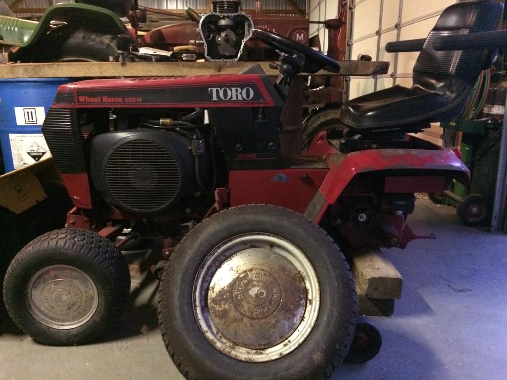

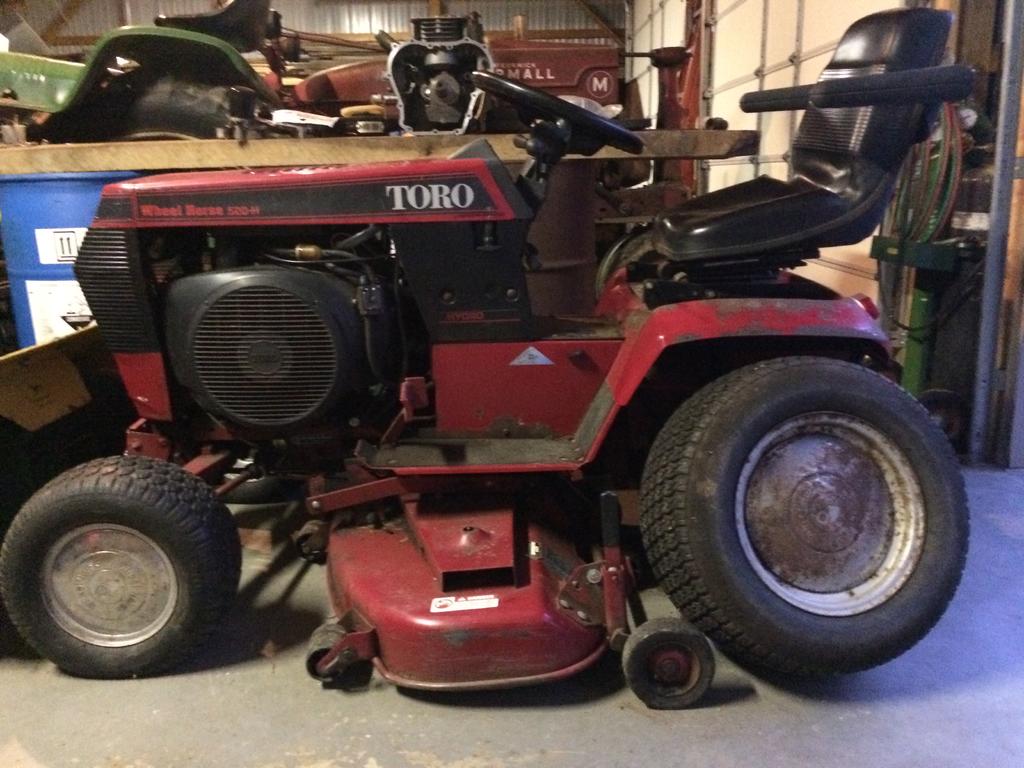

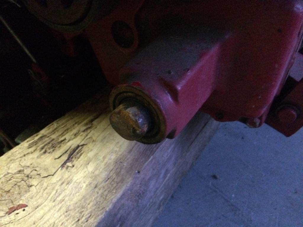

Farmitall 26 #15 Posted September 10, 2017 Hey everyone, Sorry I had taken so long to give an update on my 520H. Been busy. I ended up buying the tractor on 8/14/2017. It was not in as good of shape as described to me, but i got a steal on it. I talked him from $225 to $100. It indeed did have a broken axle on the left side. But on the bright side, I bought it from the original owner, an 82 year old man who bought the tractor new in 1986 with a 48 inch mower deck and factory wheel horse hub caps. It has 1,146.8 hours and runs great. But now I need to find the correct axles to fit this tractor. I got a couple of spec numbers of the tractor. Stamped into the transmission was 111201 with a 9A below it. The tractor ID number on it is 4120OE01 10261 It has a 20hp twin cylinder Onan engine in it. I attached pictures below if anyone is interested. If anyone has any info I can use, I'd appreciate it. 2 Share this post Link to post Share on other sites
Searcher60 209 #16 Posted September 10, 2017 I thought the 87 520 had the motion lever on the console, not the column???? Share this post Link to post Share on other sites
AMC RULES 37,259 #17 Posted September 10, 2017 '88 was the first year of 520 production... & yes, motion lever on that model is located in its console. Share this post Link to post Share on other sites

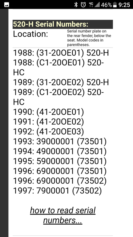

WVHillbilly520H 10,378 #18 Posted September 10, 2017 (edited) Here's the serial # decoder...1990...and '88 was the first year with '88 and '89 having the straight front axles... Edited September 10, 2017 by WVHillbilly520H Share this post Link to post Share on other sites

BESTDOGEVER 218 #20 Posted September 10, 2017 That's not an early 520 notice the Toro decals I think maybe mid 90's Share this post Link to post Share on other sites
Searcher60 209 #21 Posted September 10, 2017 He would have had a hard time buying that one new in '86 or '87. The freaking deck my be worth $400-500 bucks. Share this post Link to post Share on other sites

cleat 8,986 #23 Posted September 10, 2017 I bought an old Simplicity years ago with a broken axle. I was able to order a new one through simplicity for a good price. I would think someone would have an old rear end with a bad hydro but a good axle shaft for you. You will need to split the case to replace it however, or just replace the whole rear end. Share this post Link to post Share on other sites
Farmitall 26 #24 Posted September 10, 2017 Hey there, Thanks to WVHillbilly520H, I was able to figure out that the tractor was a 1990 model, not a 1986. Is there any parts dealers that I could try to contact to see about a new axle shaft for the transmission? The number on the tractor is still 111201. I'd appreciate any info. Thanks 1 Share this post Link to post Share on other sites
Searcher60 209 #25 Posted September 10, 2017 You would be better off buying a complete trans. Share this post Link to post Share on other sites
