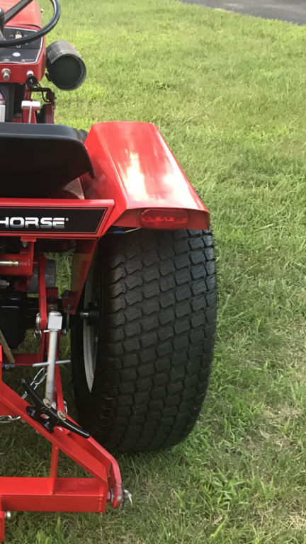

ol550 879 #2 Posted August 4, 2017 (edited) IF you can find them BKT's LG306 in my opinion are the best match turf tire. Edited August 4, 2017 by ol550 picture 3 Share this post Link to post Share on other sites
