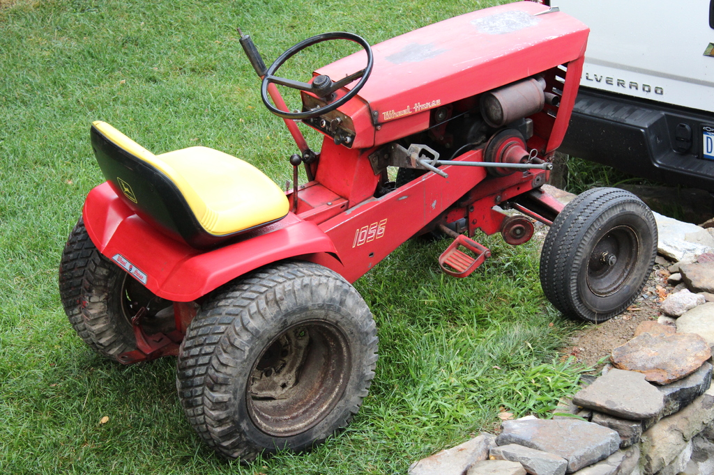

AMC RULES 37,256 #2 Posted August 4, 2017 This one hopped in my truck just two days ago. 3 Share this post Link to post Share on other sites
ACman 7,719 #3 Posted August 4, 2017 (edited) 1965 was the first year for the square hoods the only production year for the 1045 , 1055 and 1075 big block short frame . 1966 and up the 6hp , 8hp used the short frame and the 10hp and up used the long frame . Edited August 4, 2017 by ACman 3 Share this post Link to post Share on other sites
